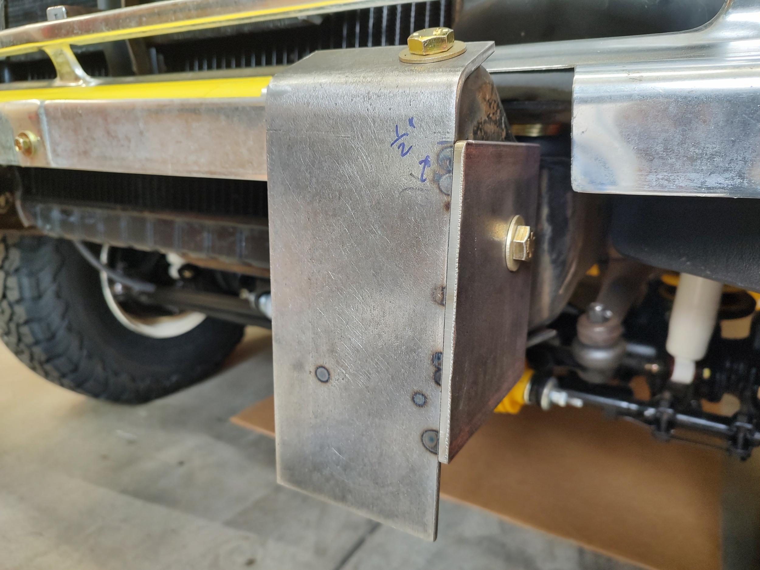

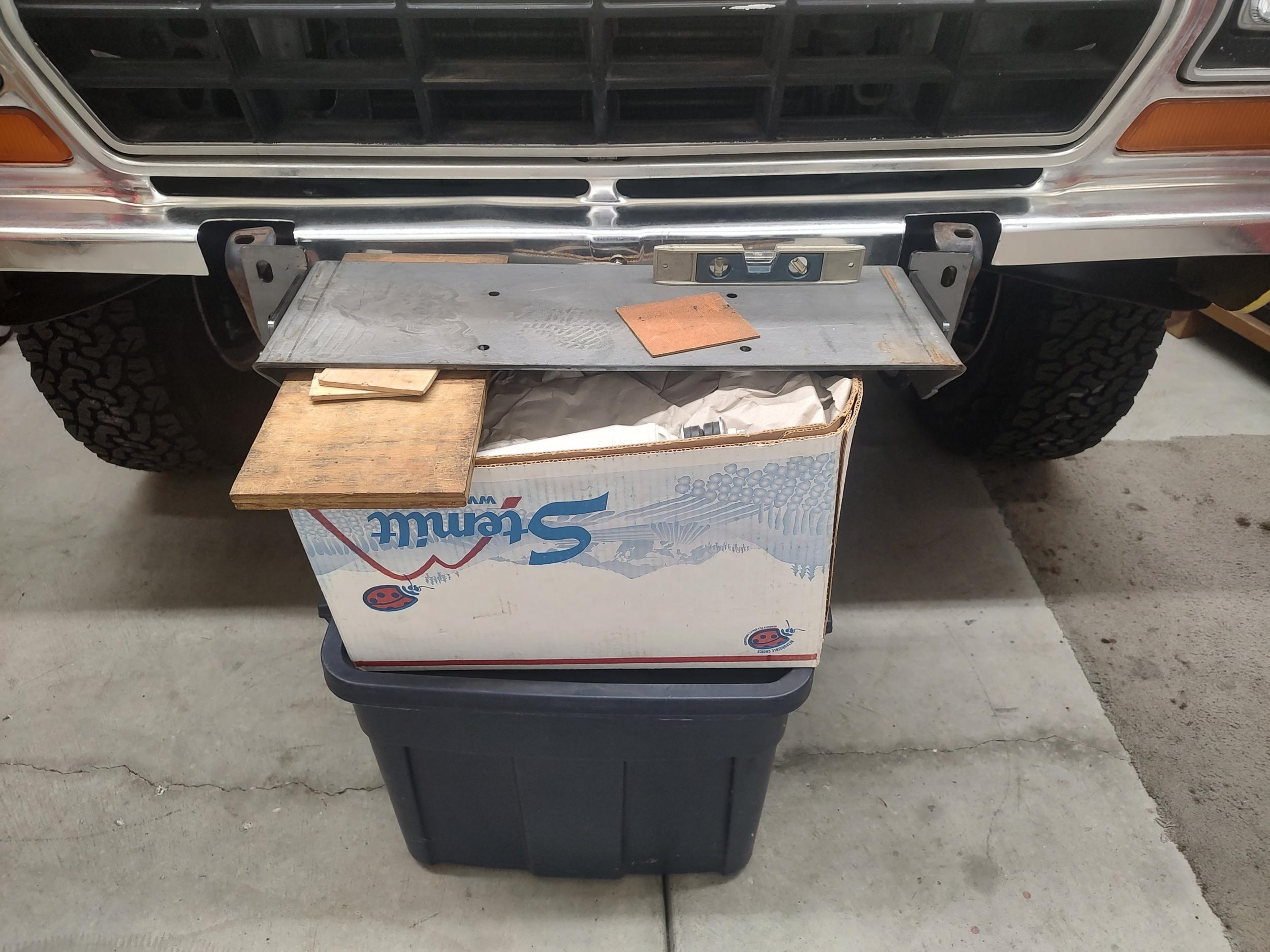

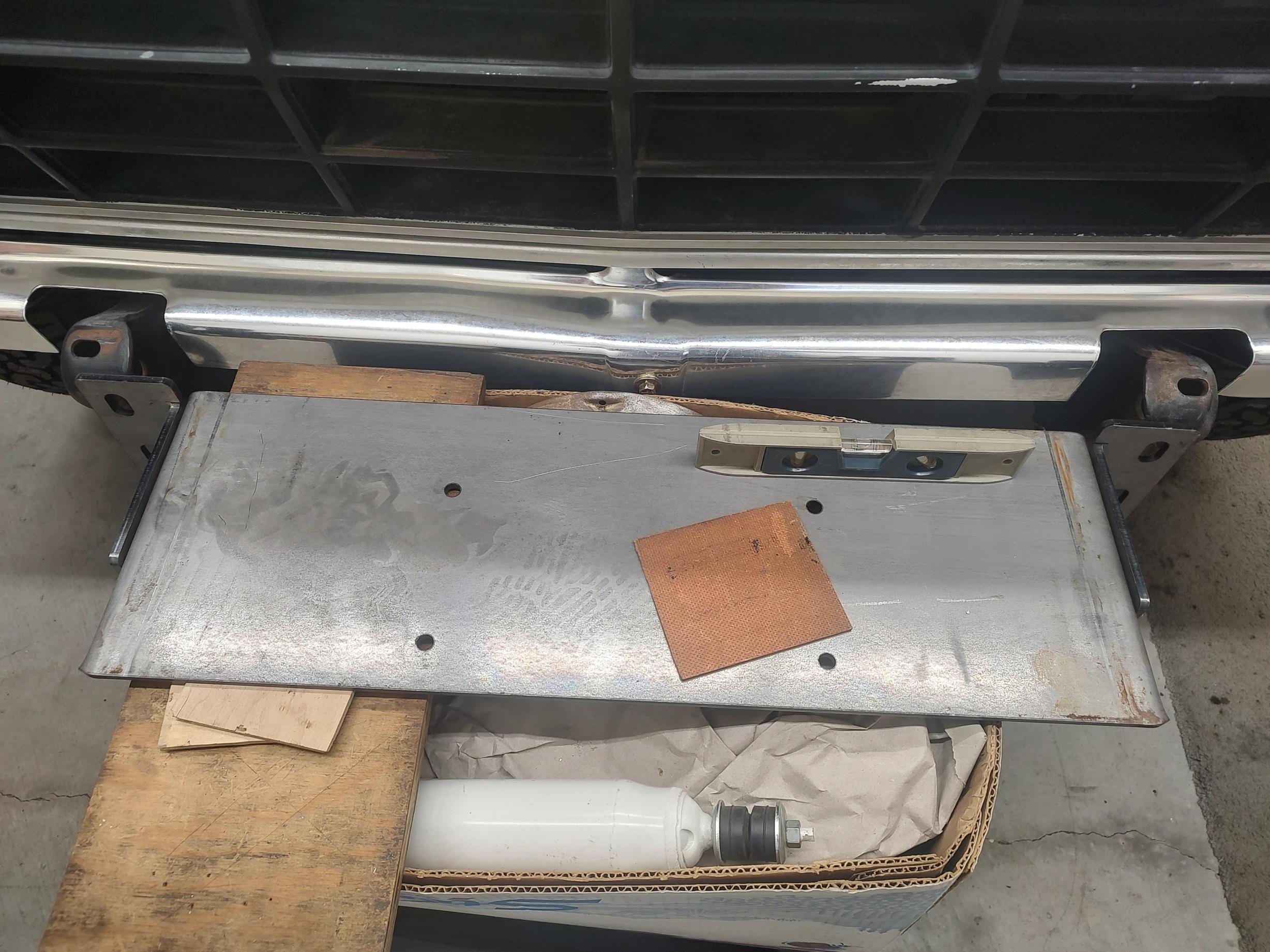

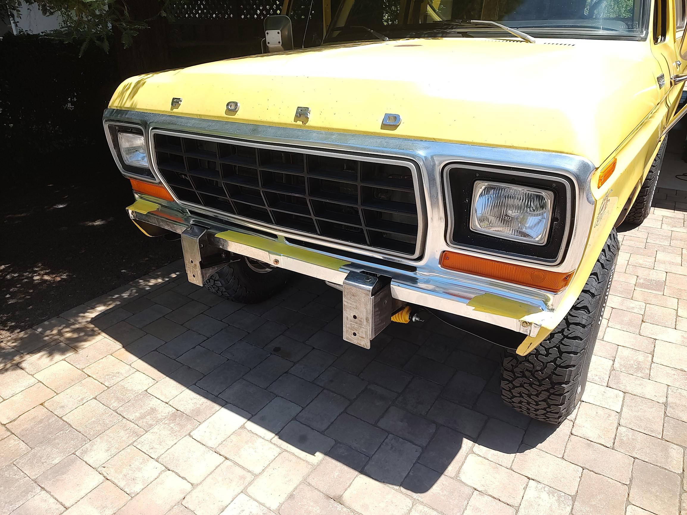

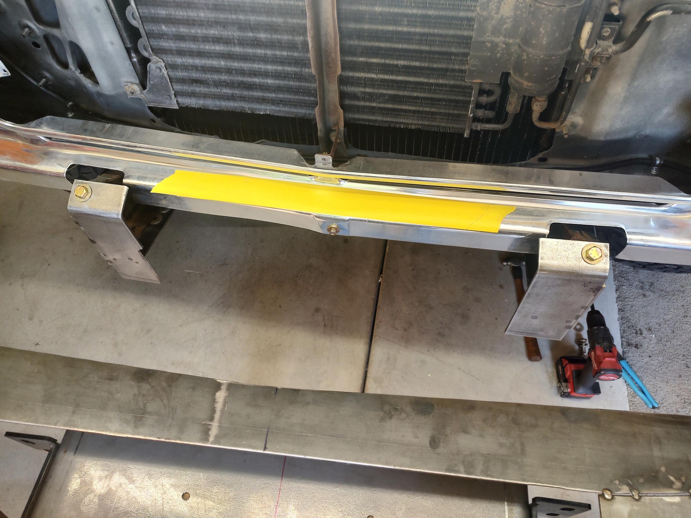

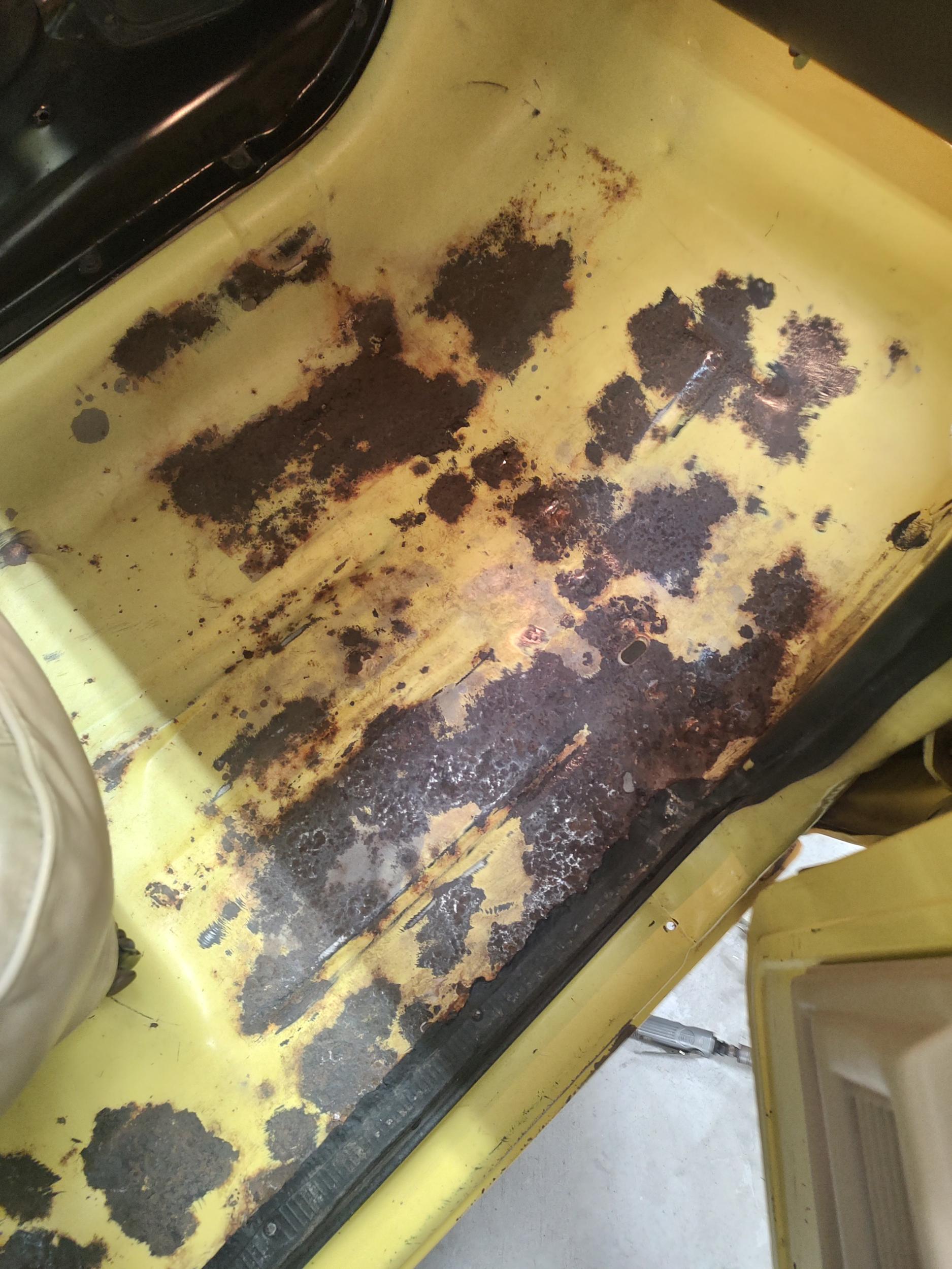

Since I can't finish the dash right now, I'm looking at starting the rust floor treatment on the driver's side (since it is just surface rust)(passenger side will be more involved) and I have started to mock-up the front Winch bumper. Of course it will be a custom fit as it is the WH's weld together bumper for Gen4 broncos.

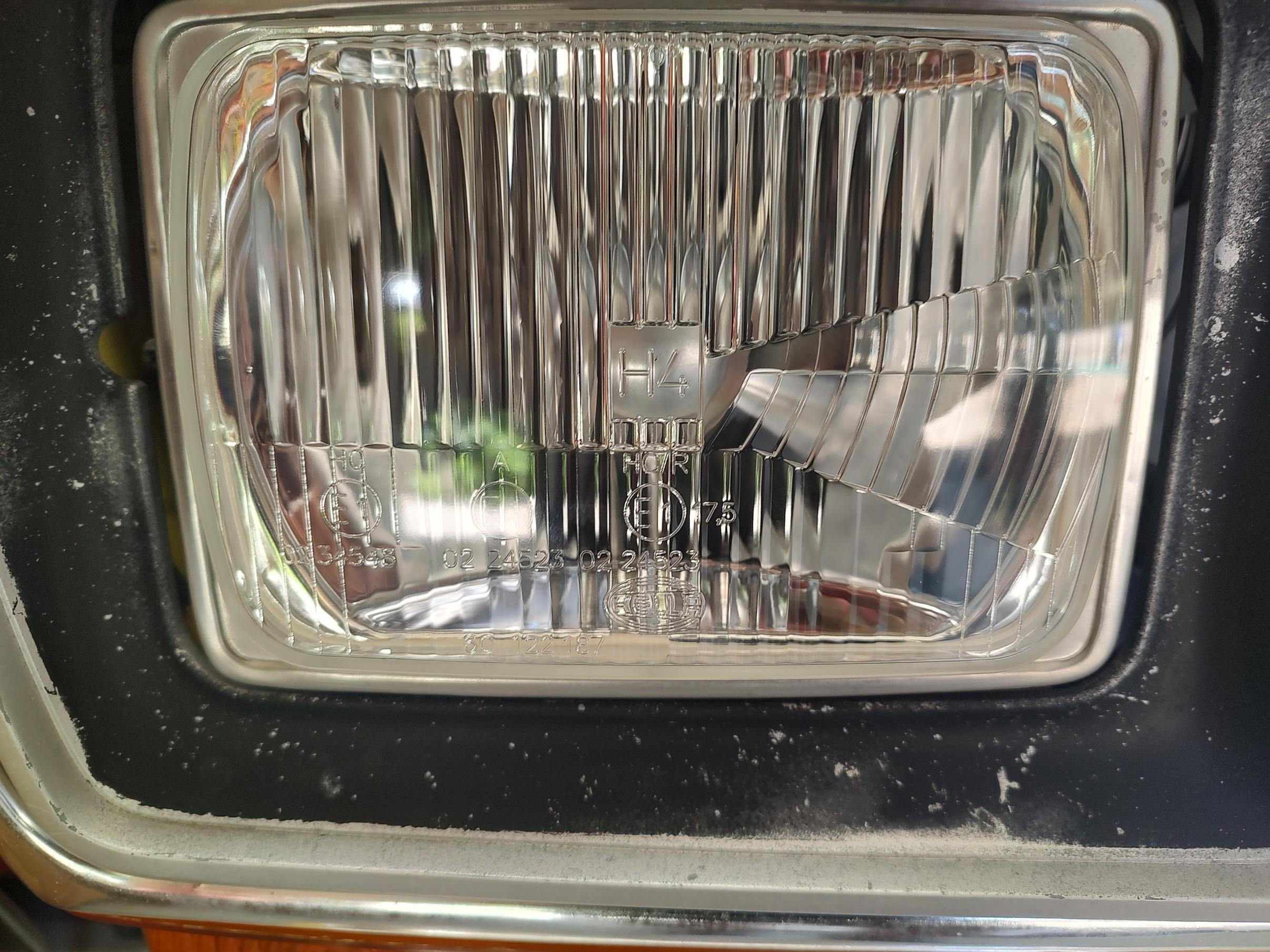

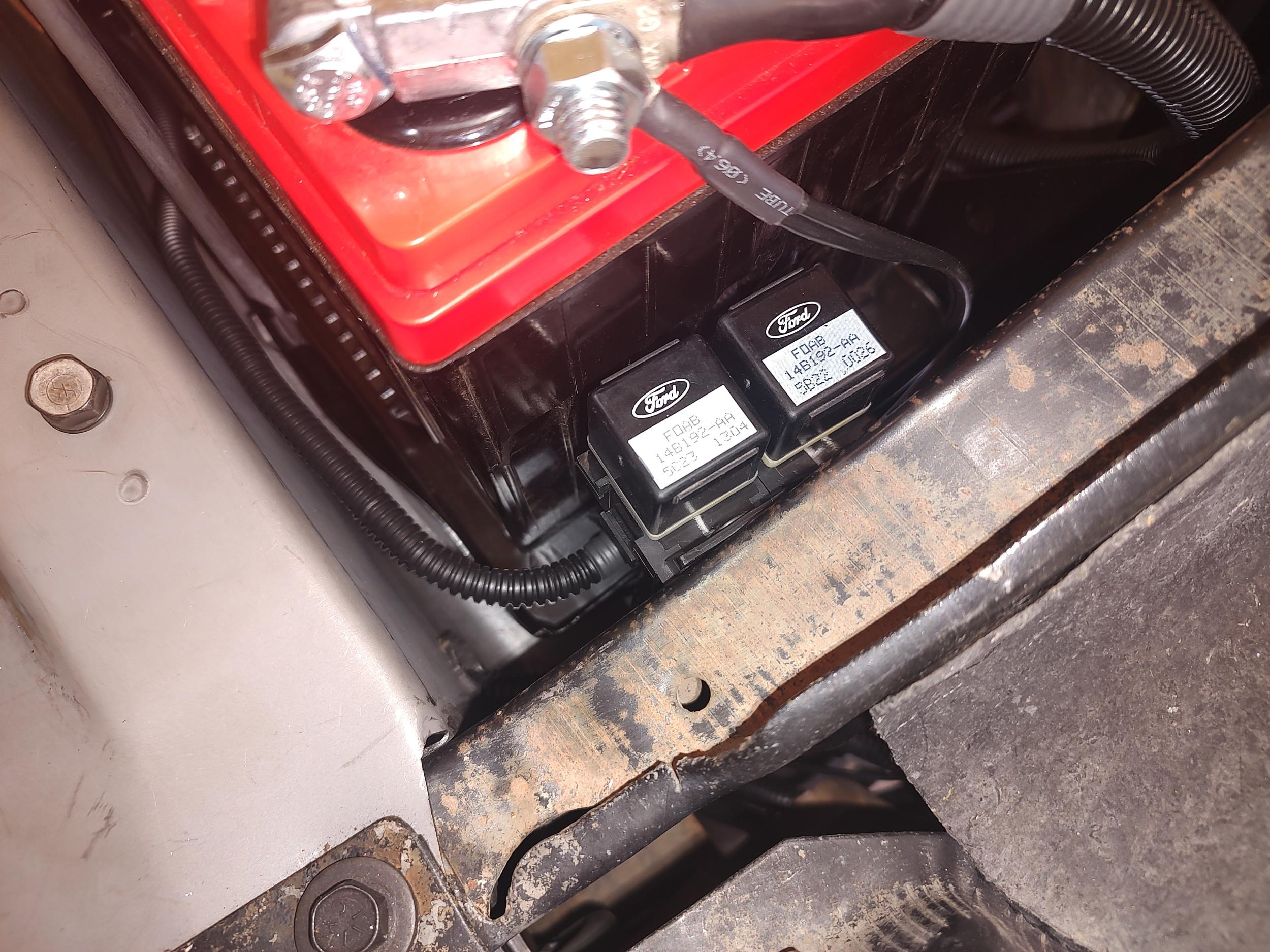

Busy doing some wiring for H4 headlight relays and for a Tach.

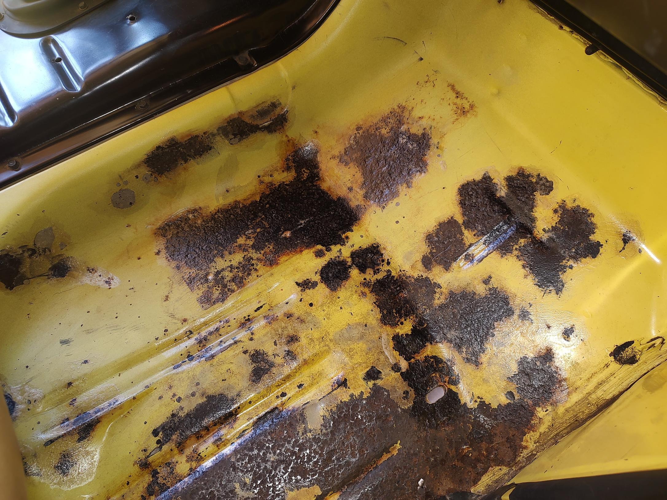

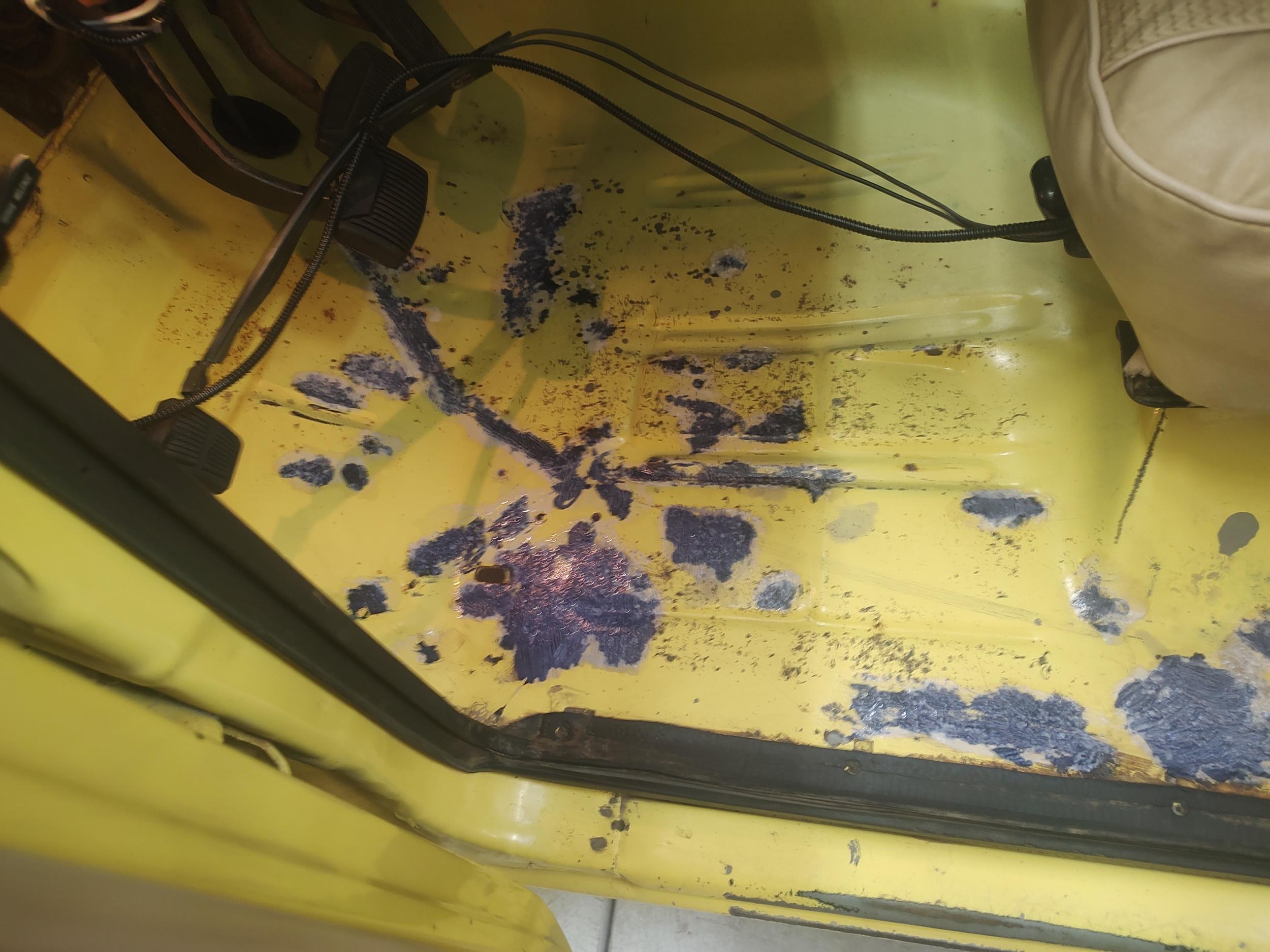

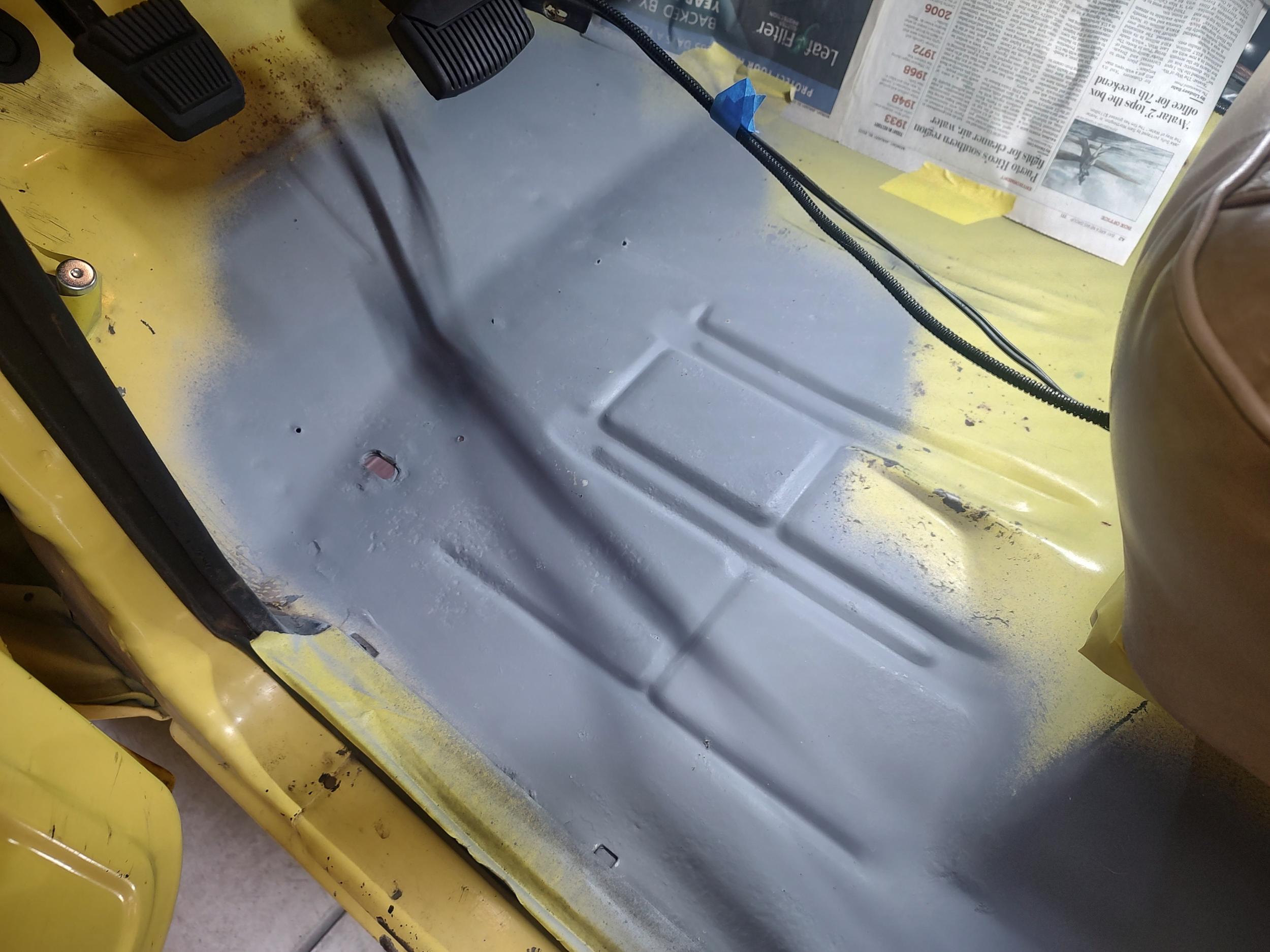

Driver side floor was sanded for the surface rust and rust converter applied

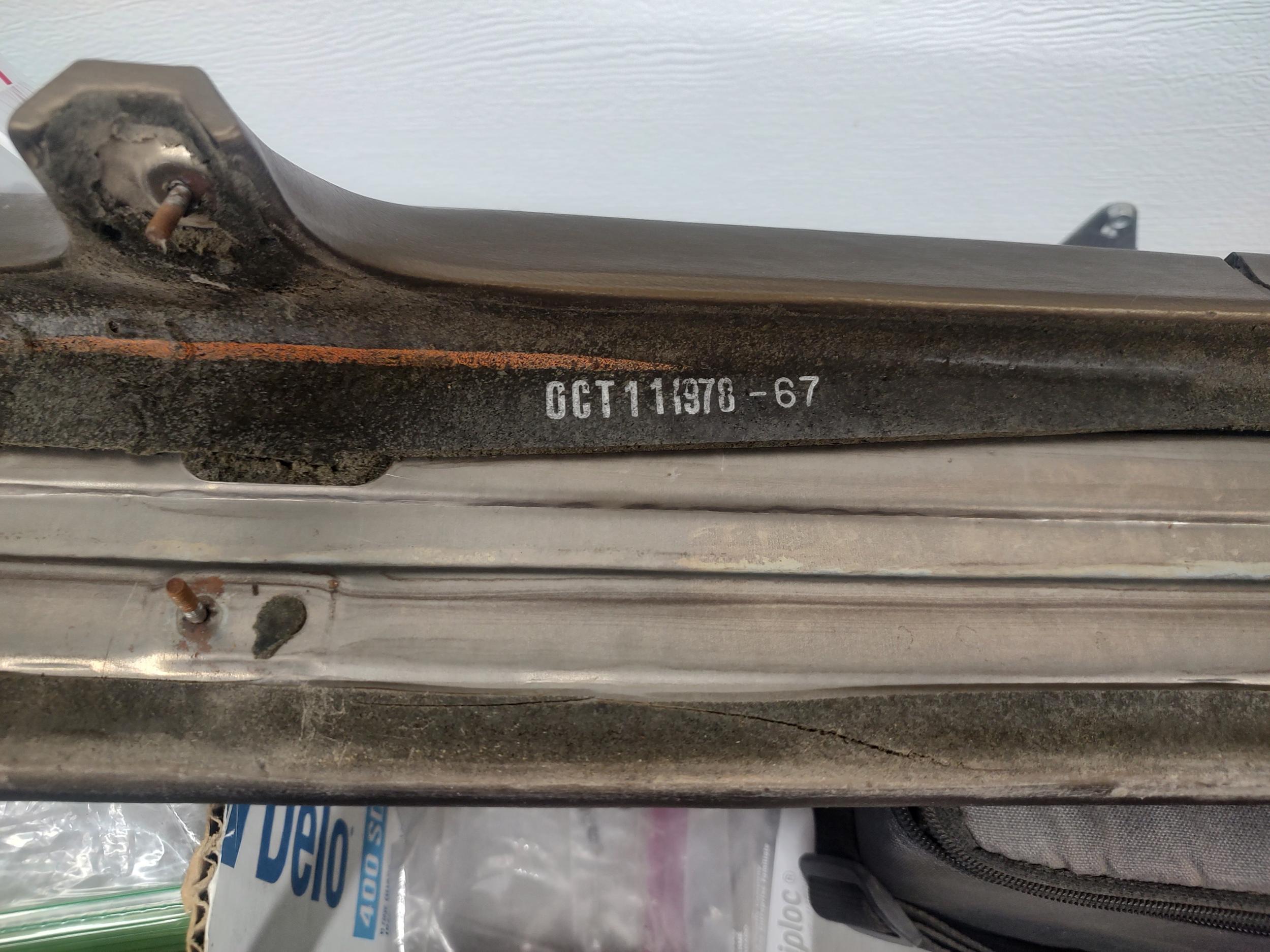

And I pulled the dash cover and found some info on the back side.Last edited by 904Bronco; 05-23-2023, 02:45 PM.2002 F250 Superduty, 7.3 241,500 miles and counting

H4 headlights installed with new harness/relays. Driver's floor has a coat of self etch primer, followed by 3 coats of high build primer. A little scuffing and then body color.

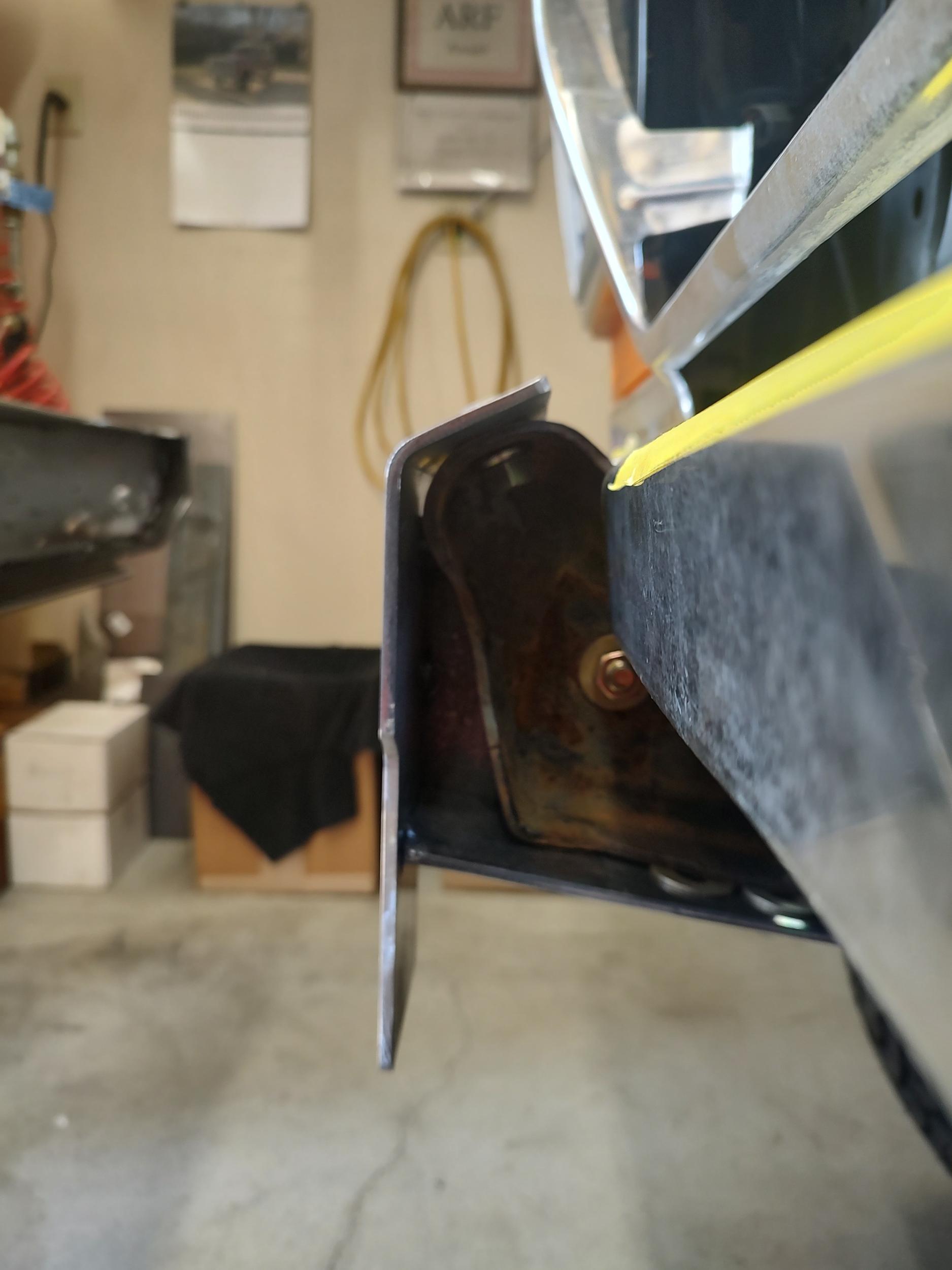

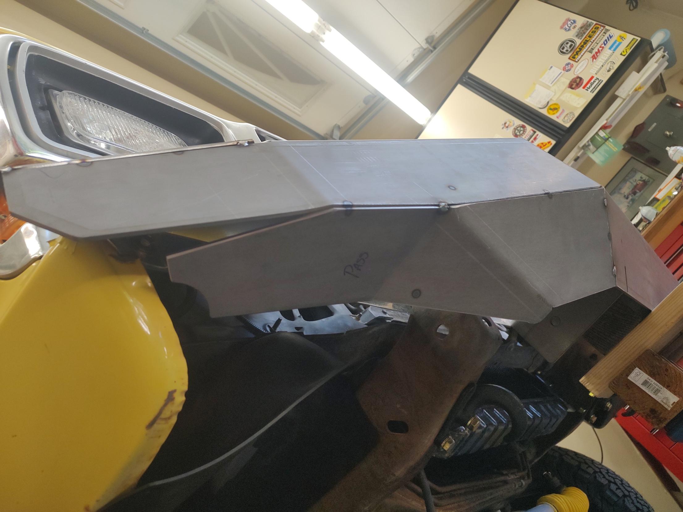

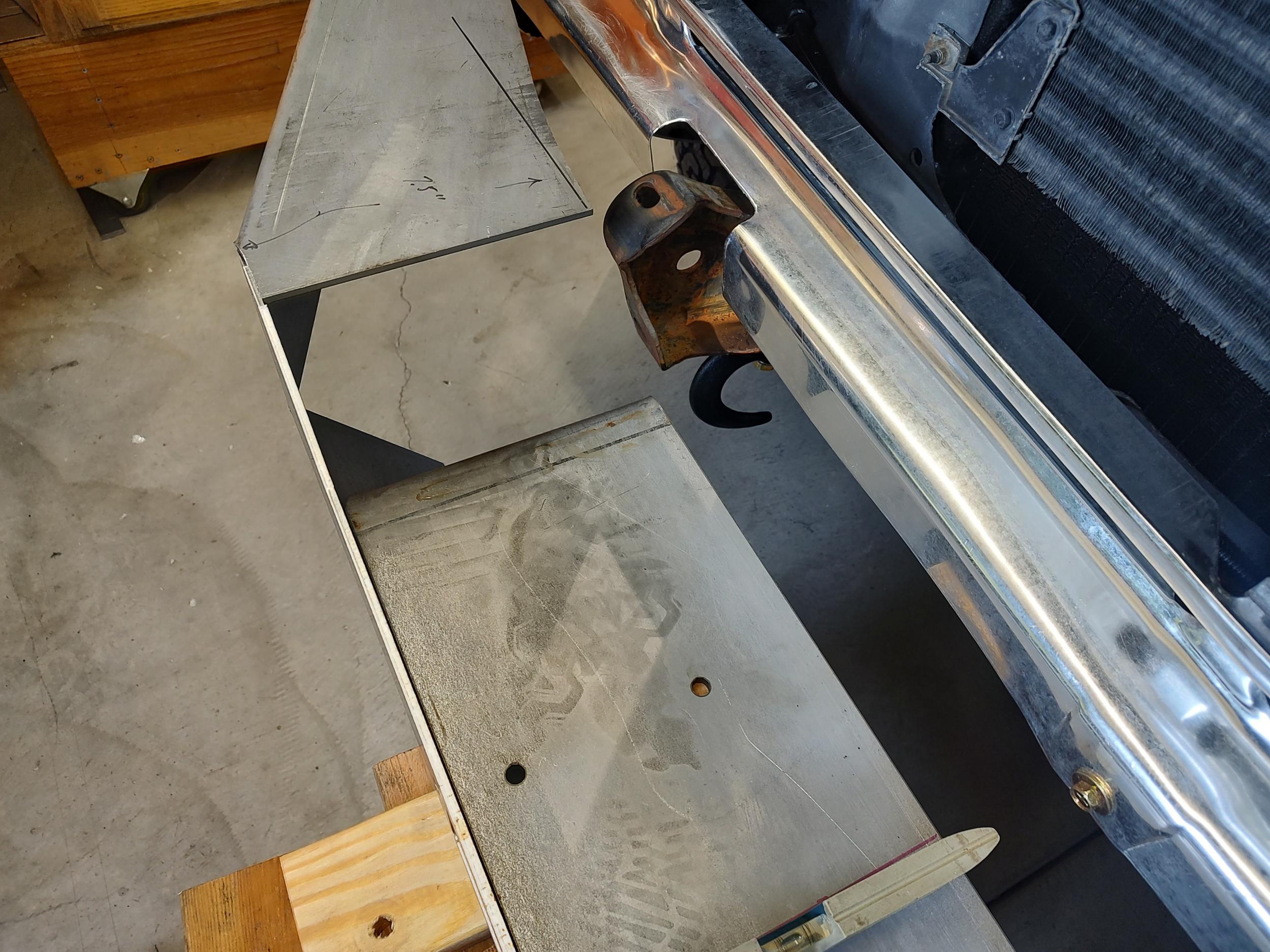

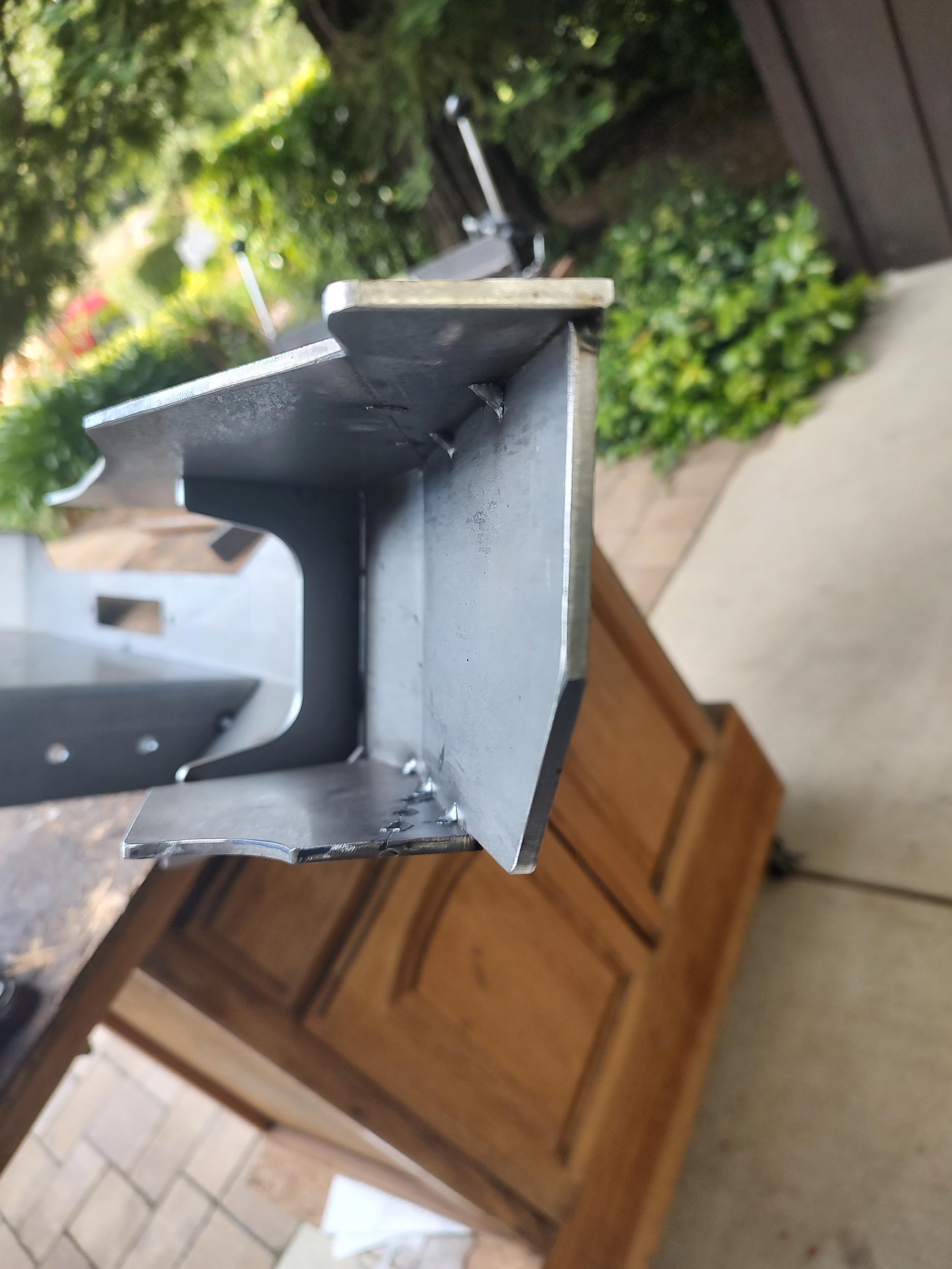

Been modifying the WH's front winch bumper. I had to bend out the outer front panel for more clearance and then back fill those areas. Got it mostly tacked together, making fill pieces now. Mounting brackets are next and then a full weld up. My welding seems to have improved over the years, all those replacement body panels installed probably helped.

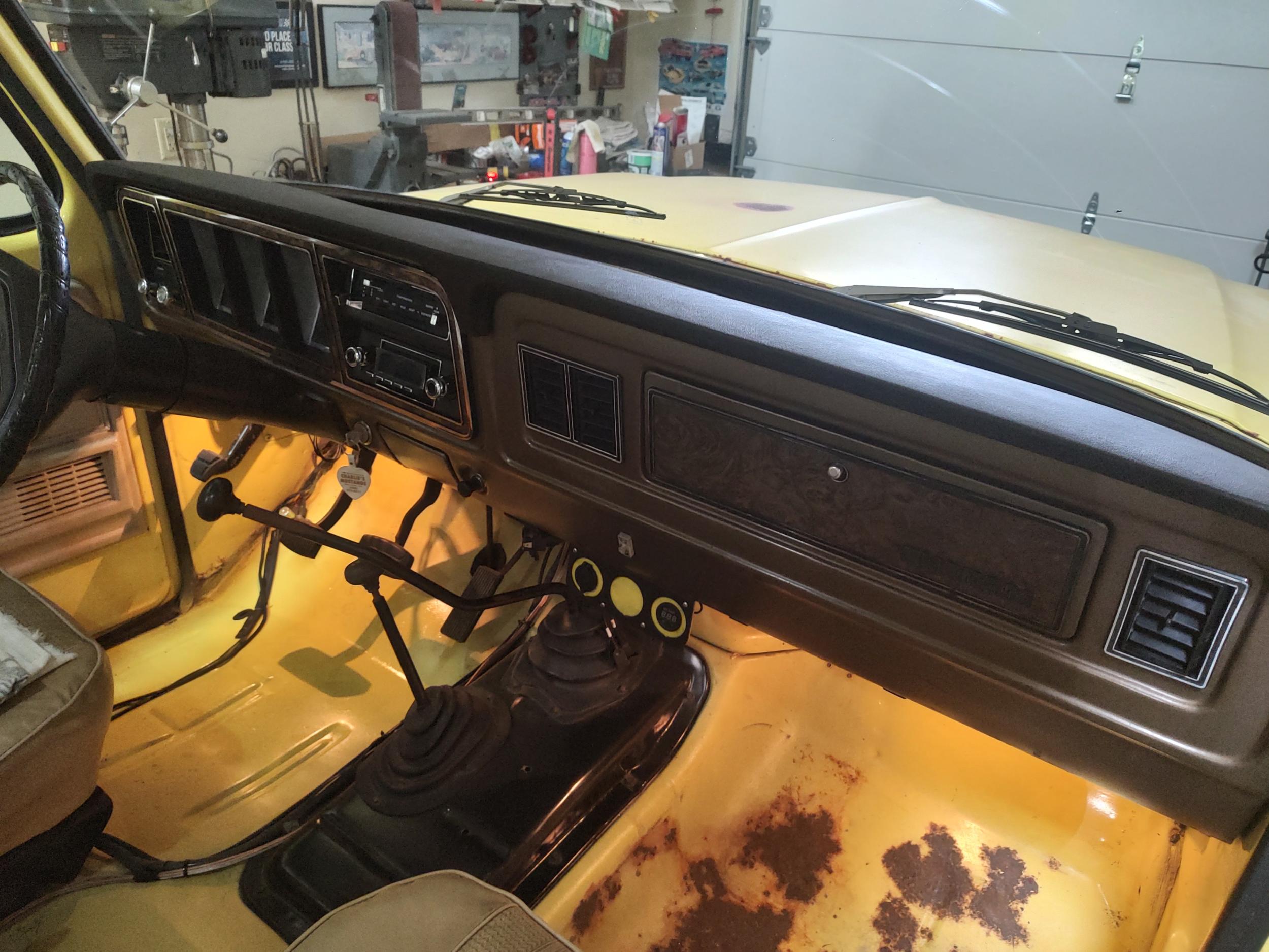

Dash pad finally showed up from DC, 3 weeks. Dash is about 50% back together, I need to put the center and L/side vents in and then the Glovebox liner/light.

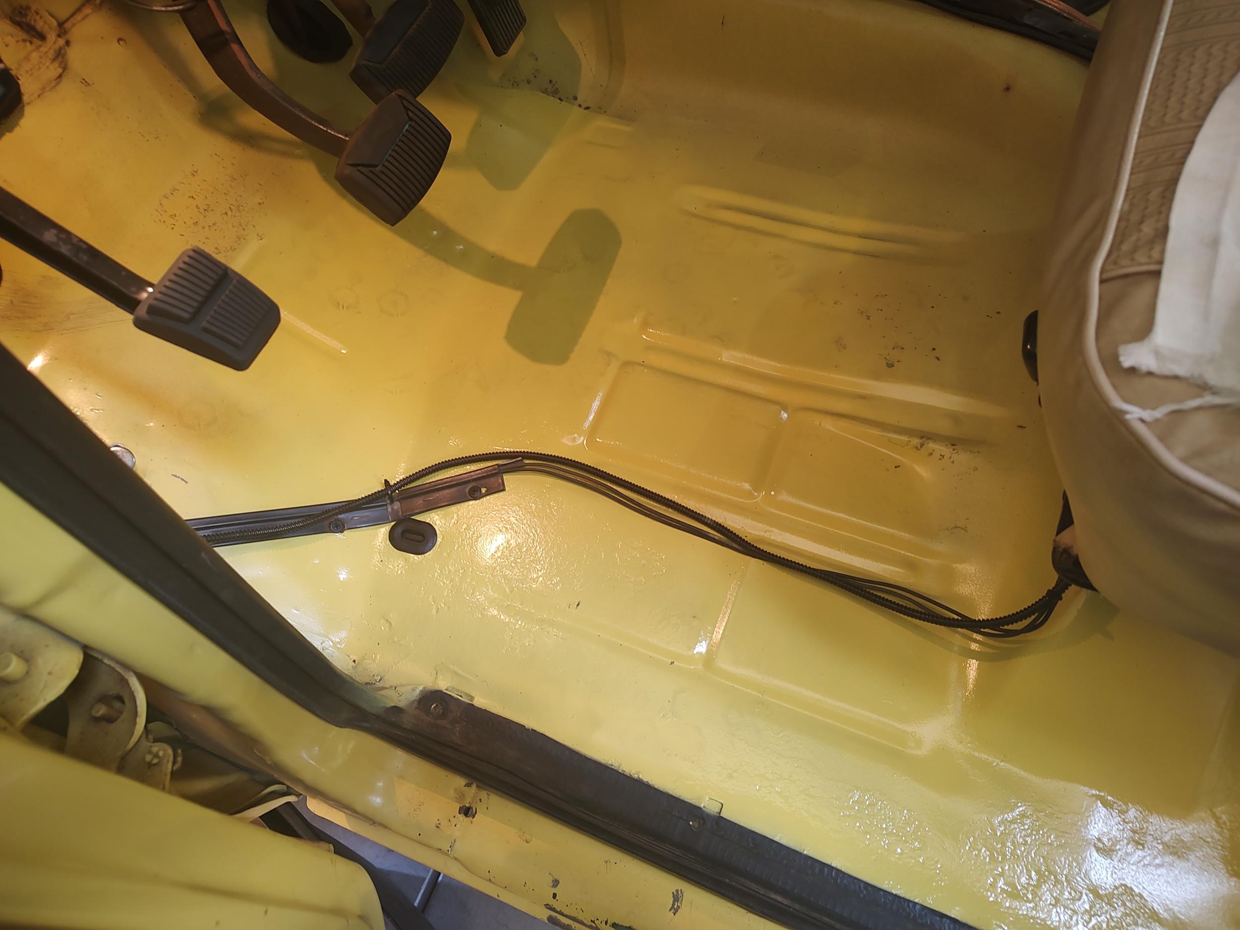

Drivers Floor well has been treated for the rust, primed, and painted.

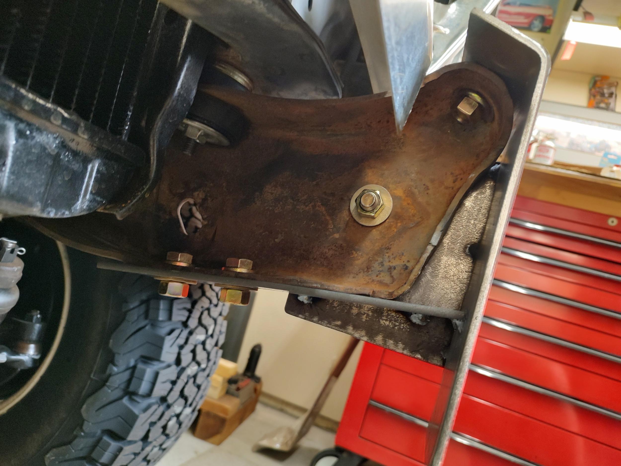

Front bumper is attached, Brackets I made and the Bumper itself needs to be fully welded. I still need to fuss with it some more, not fully happy with it yet. Would like to finish this up and have it powder coated.

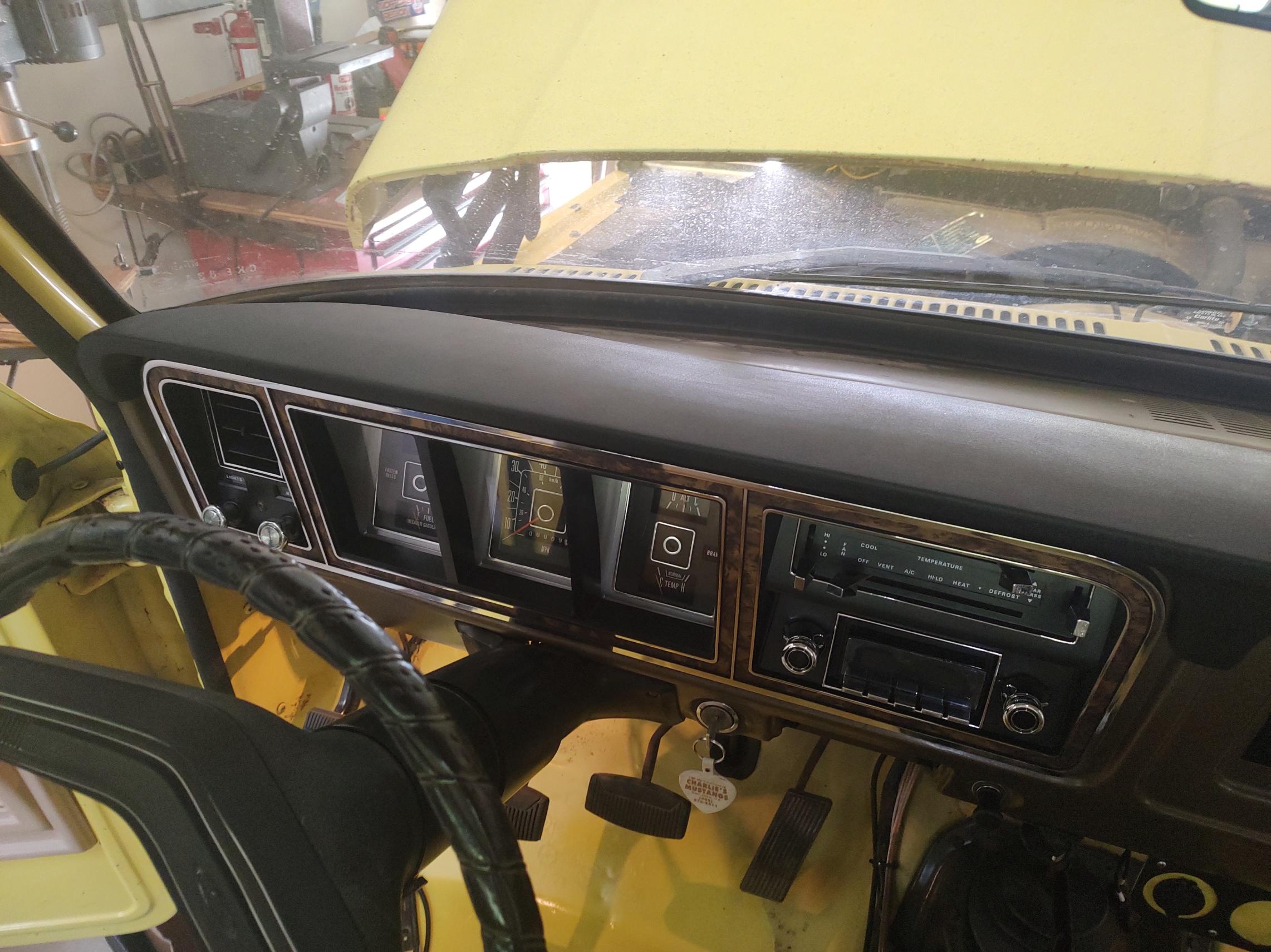

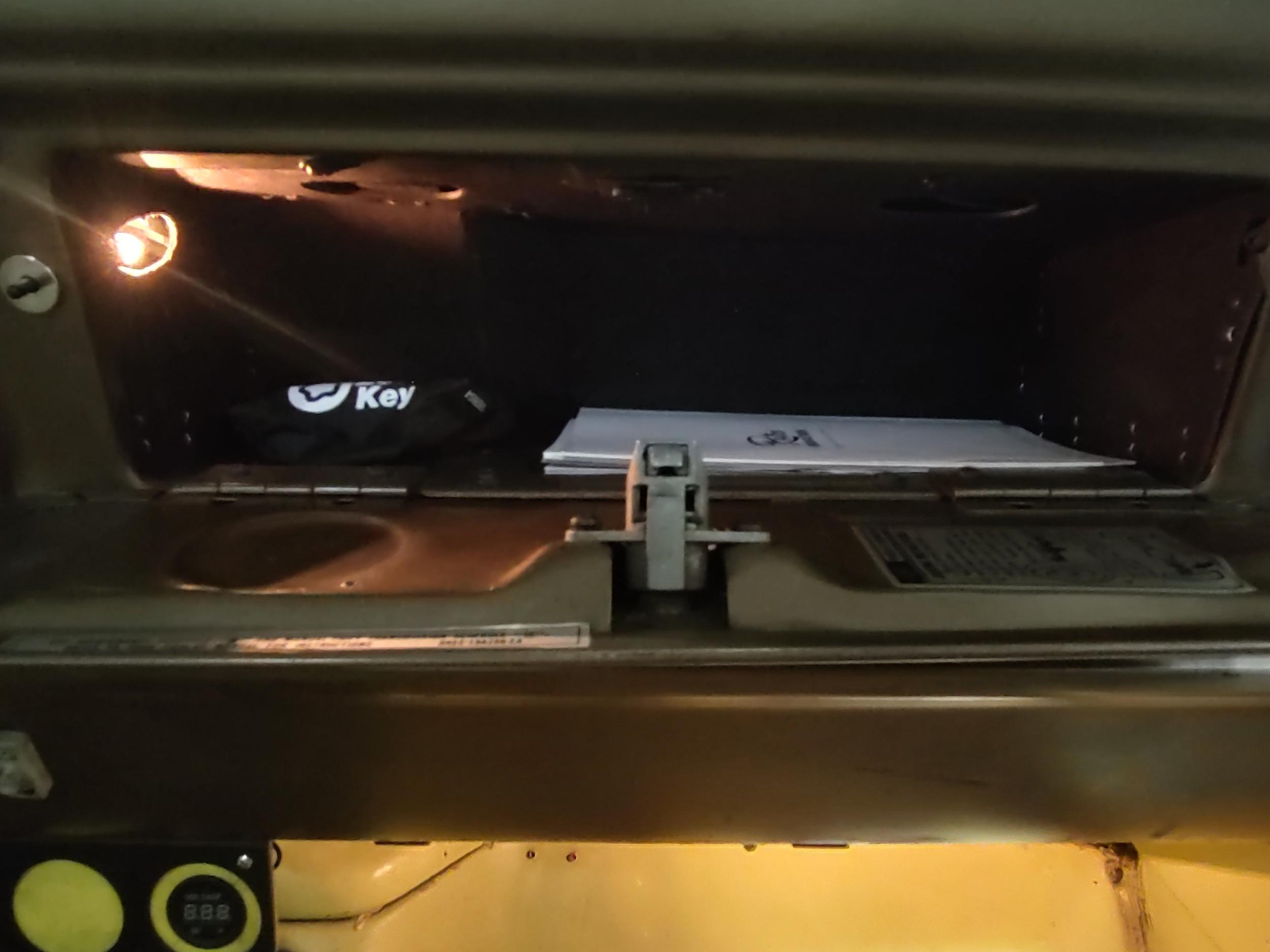

Rest of the Dash is together, even have a lighted Glovebox. Did a quick grind to the passenger floor, thinking of treating the areas that don't need patched.

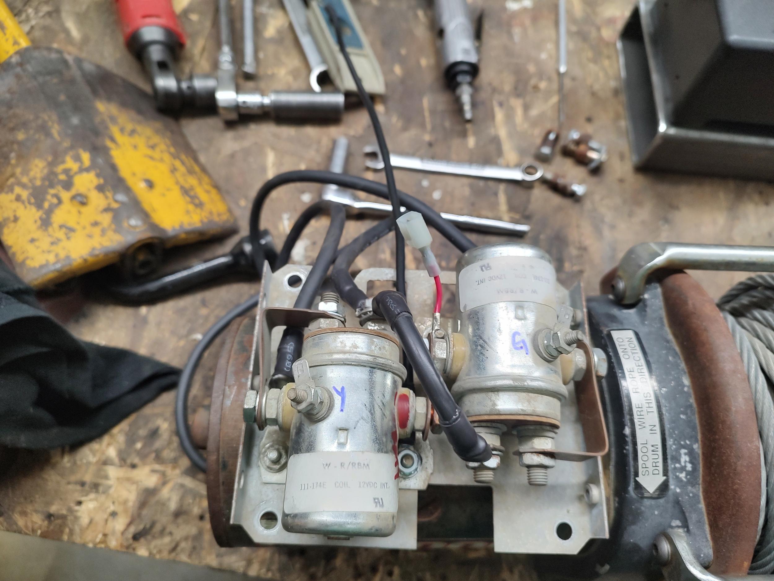

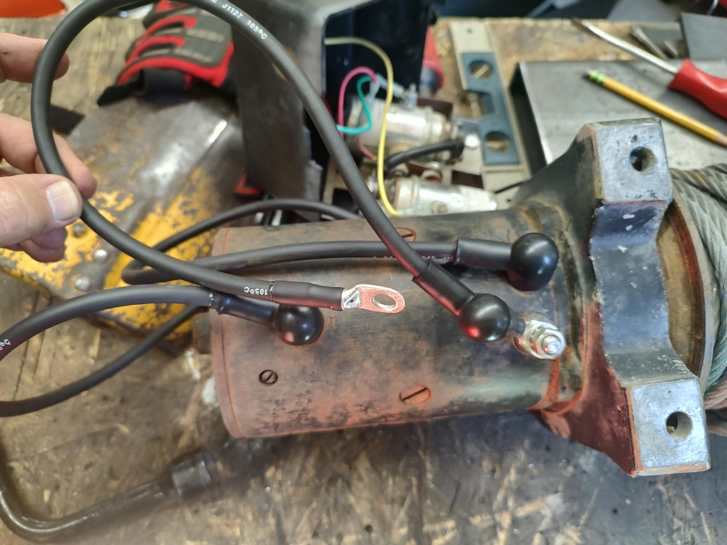

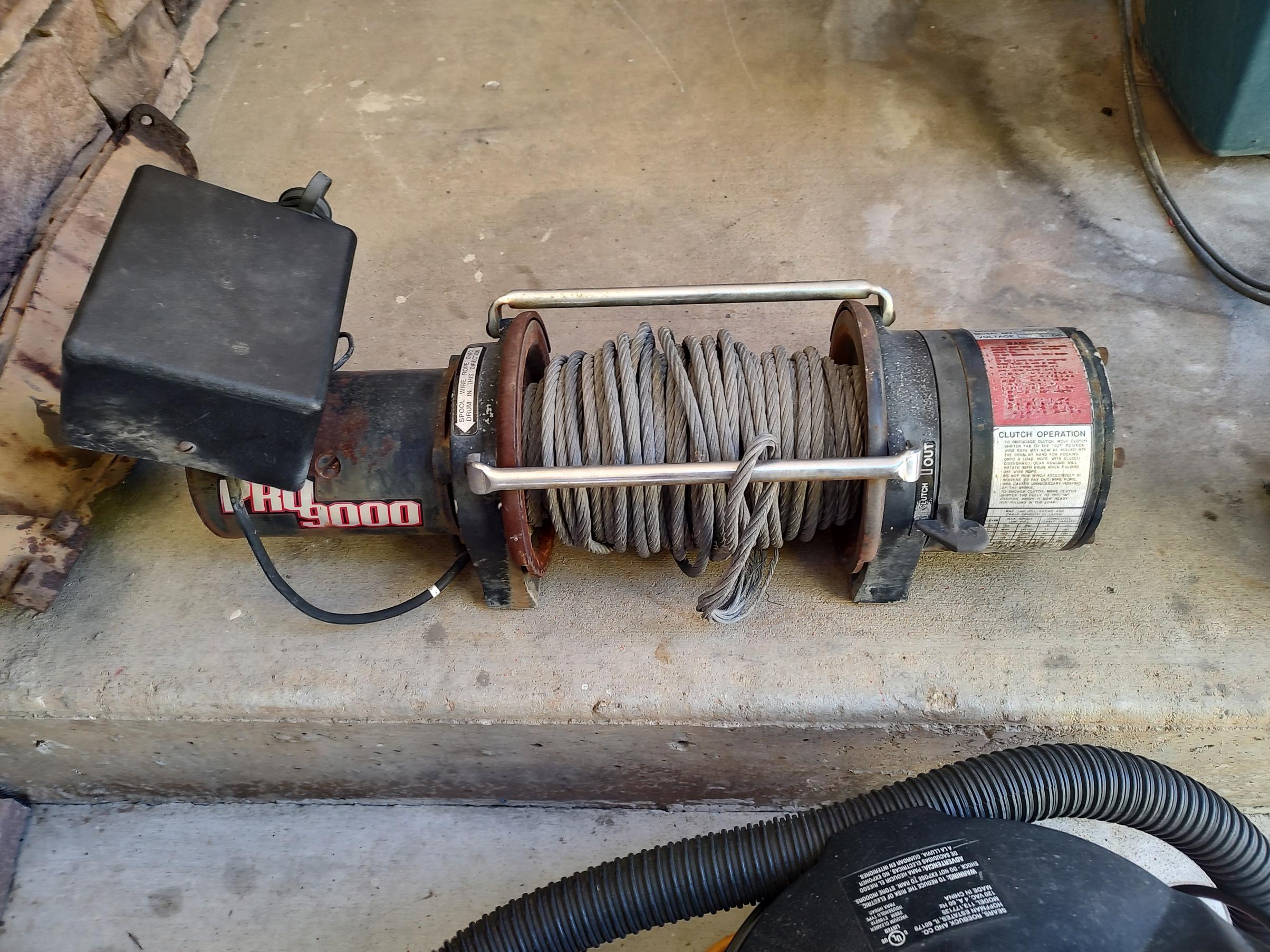

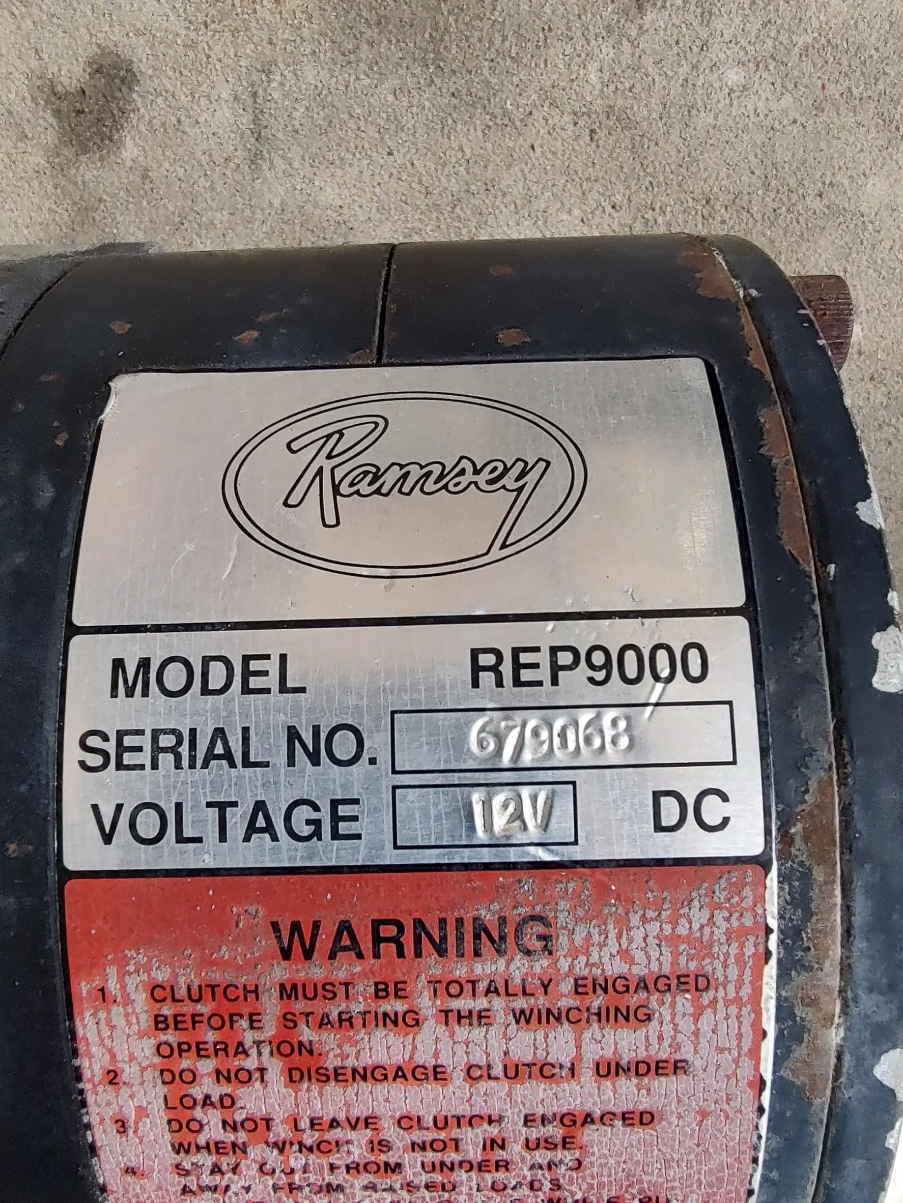

Pulled the REP Ramsey winch out of storage that came with the YS. It needs a new cable and new roller fairlead. Didn't realize this is a $1,300 winch now. It worked before I took it off...2002 F250 Superduty, 7.3 241,500 miles and counting

I dropped the front bumper off at my Buddies shop in town, said he would Tig weld the front side up for me.

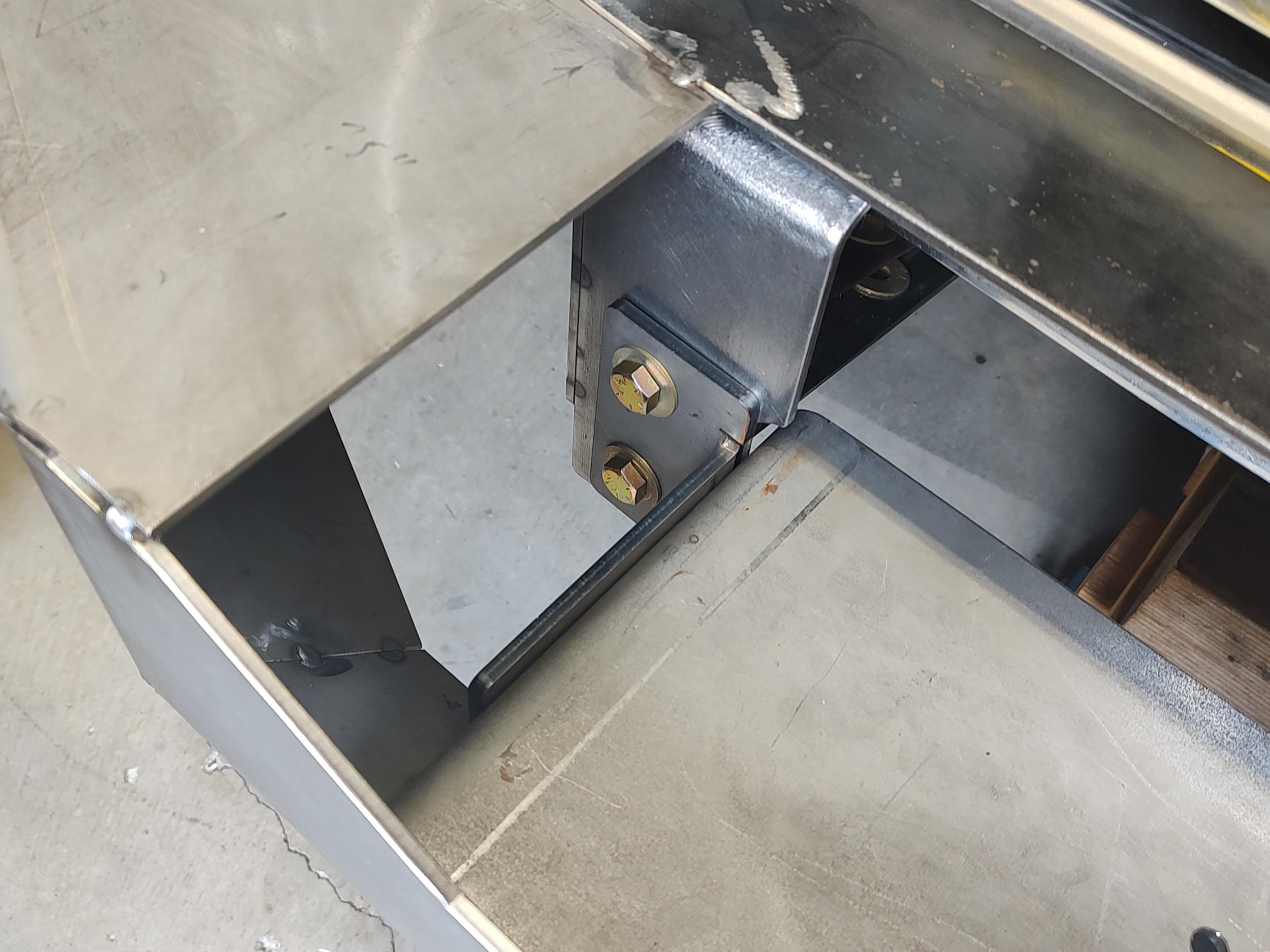

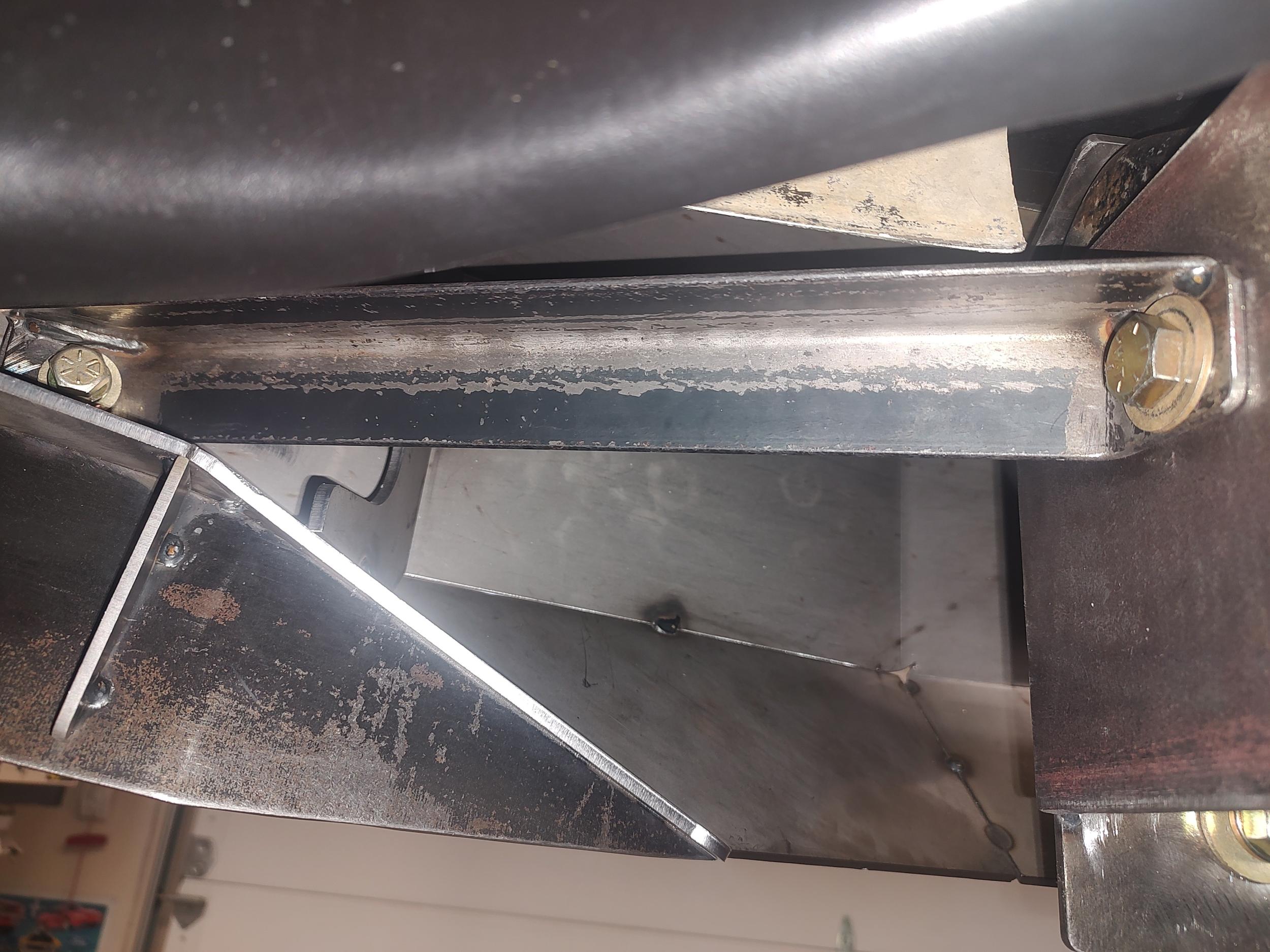

Before that happened, I made up a set of angle braces for the outside portion of the bumper. So much easier doing this on the rack, rather than laying on the ground!
Ordered a few parts for the Ramsey winch; roller fairlead and new cable. Picking that stuff up in OR when I see my oldest this weekend.

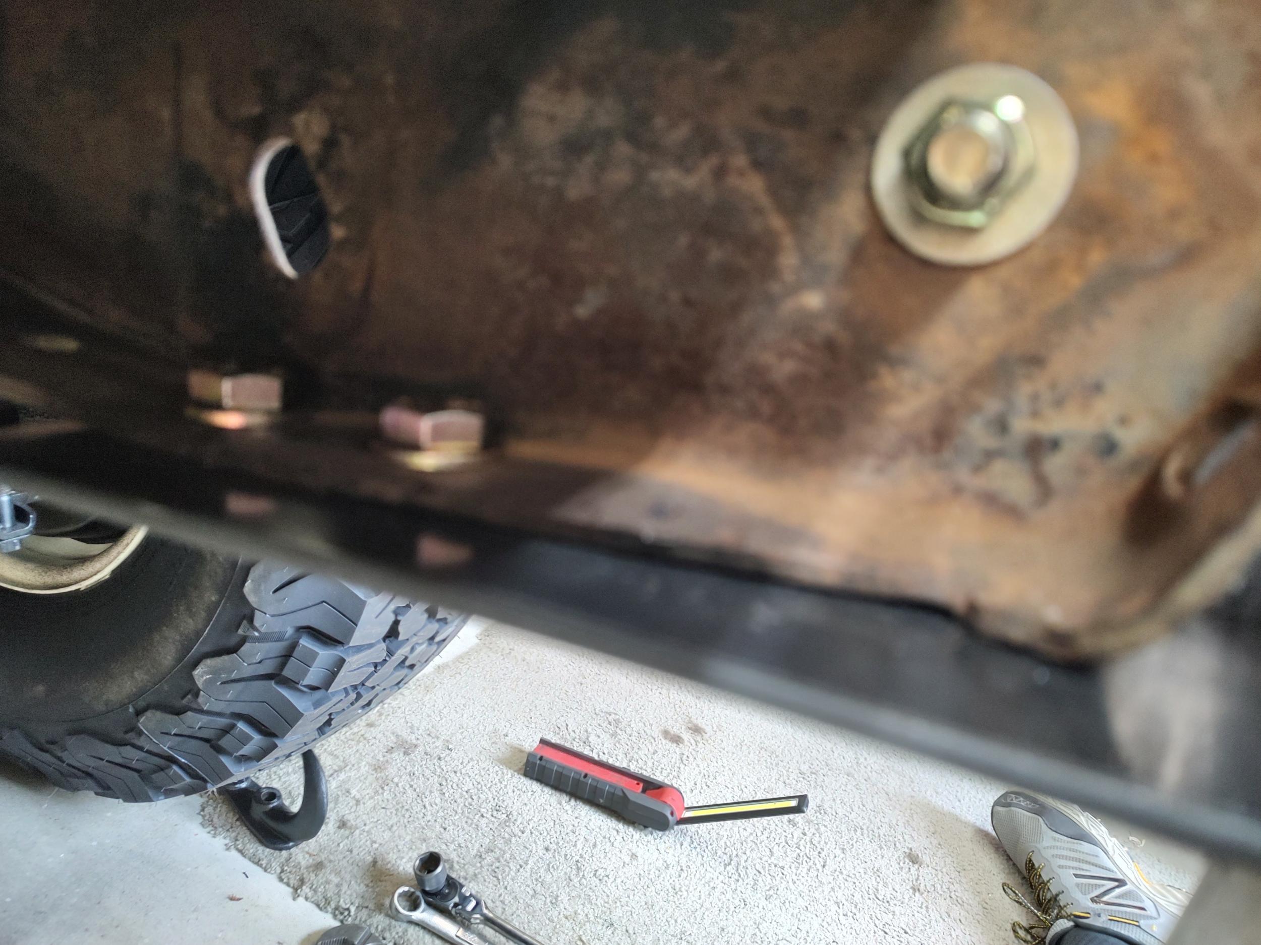

I got the Bronco out of the shop so I could treat most of the surface rust on the Passenger floor. There are 3 places where I need to replace metal...

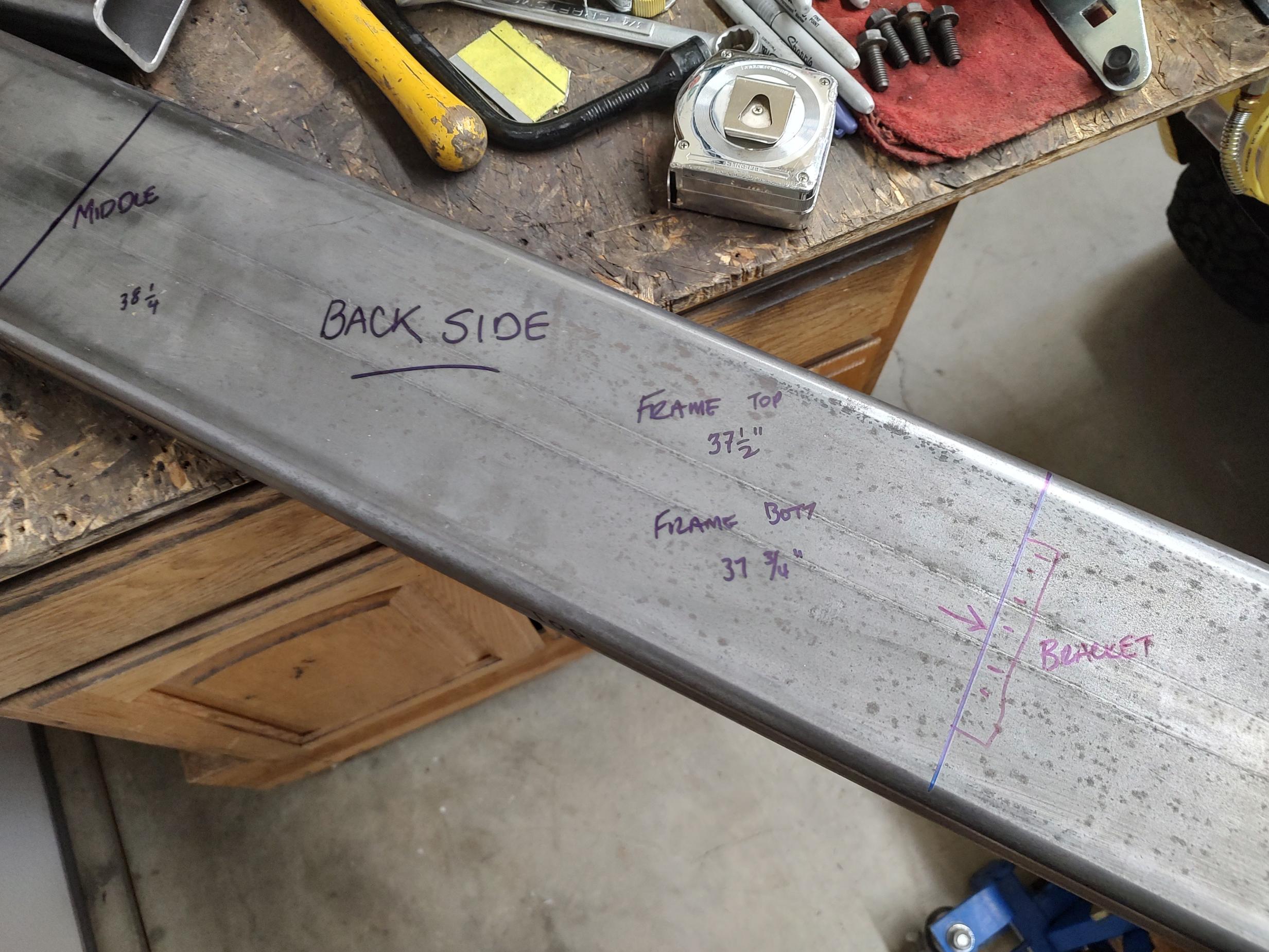

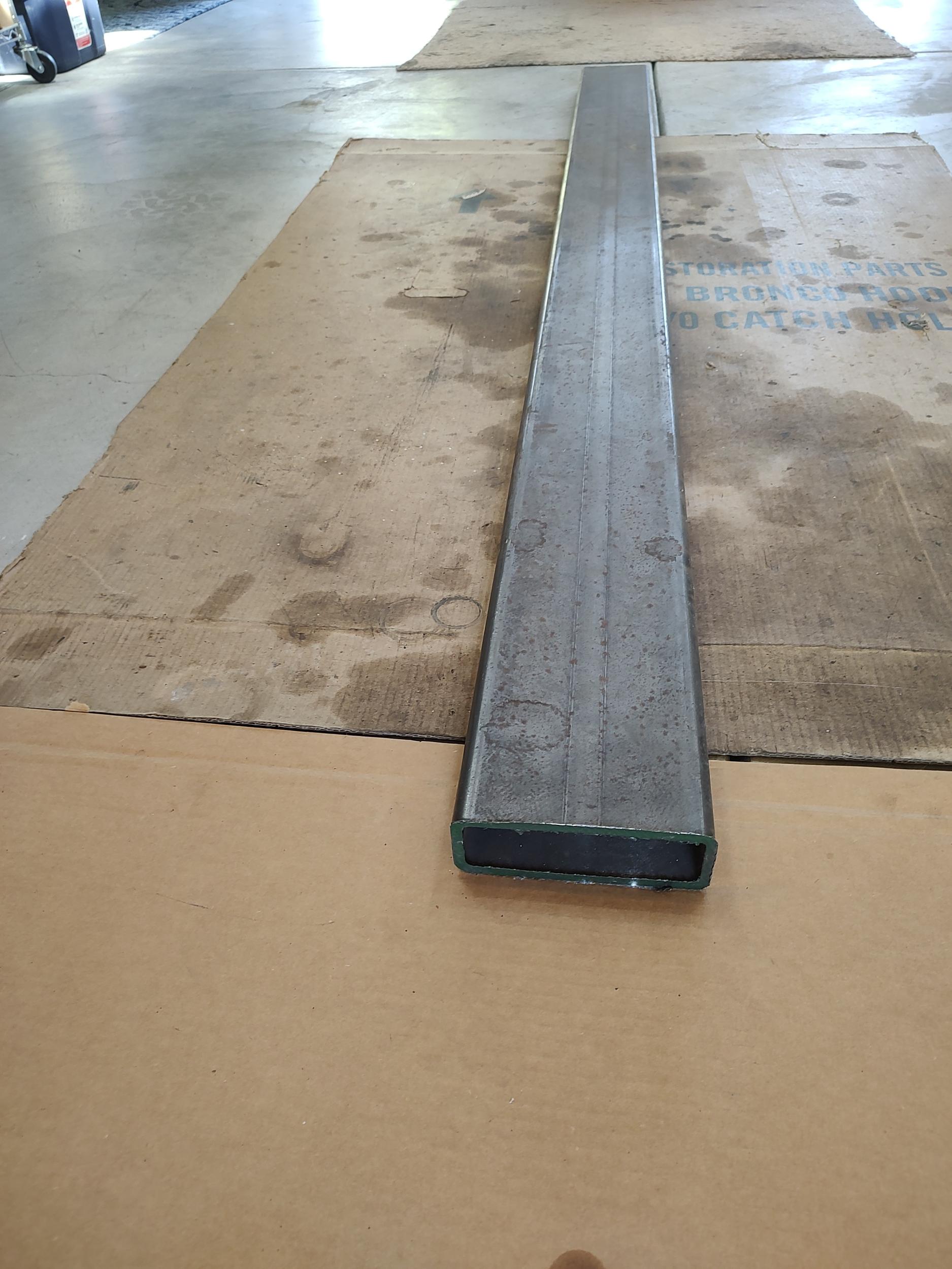

I started to at least think about the rear bumper, the material has been sitting on the shop floor since last September.

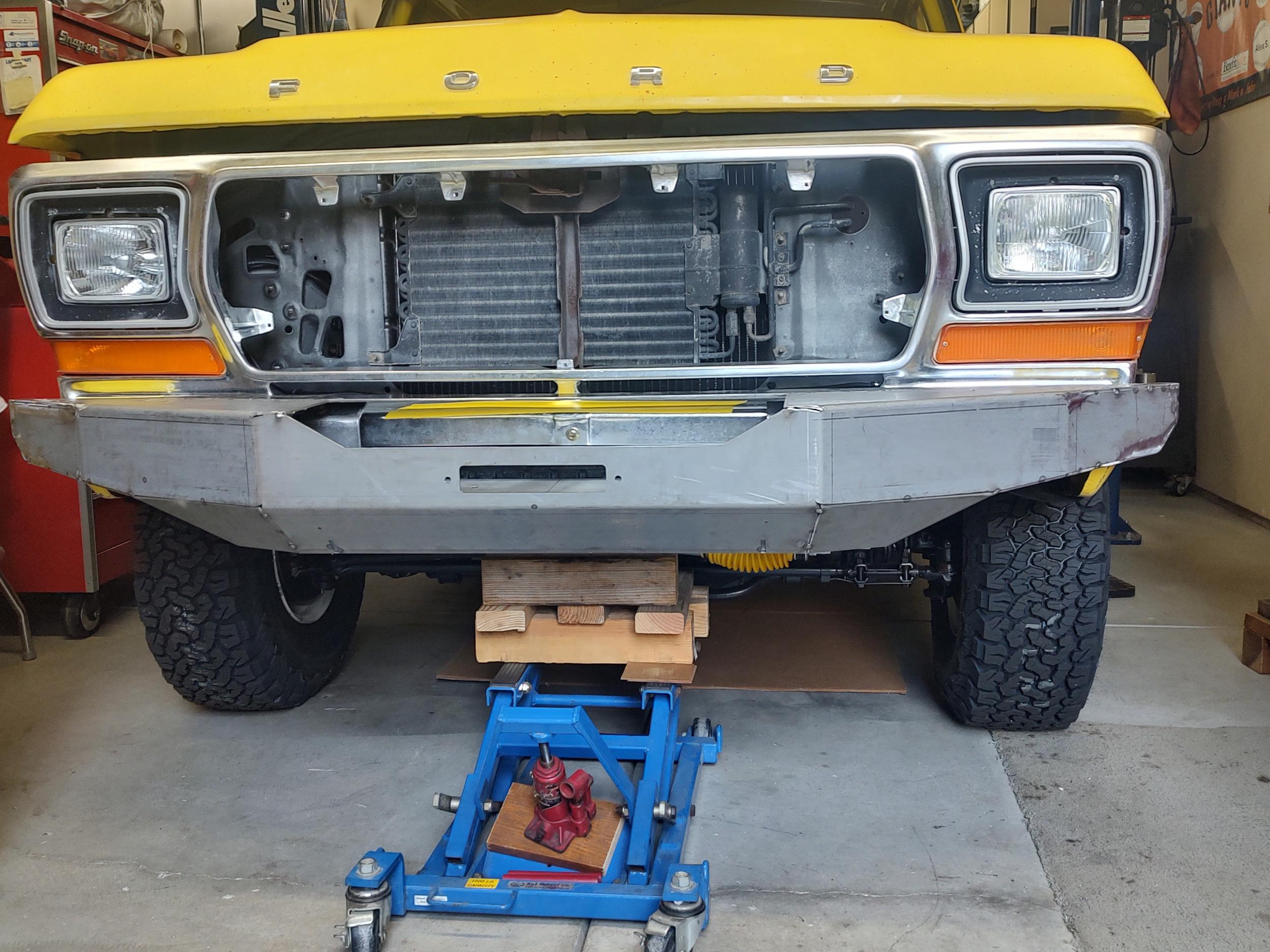

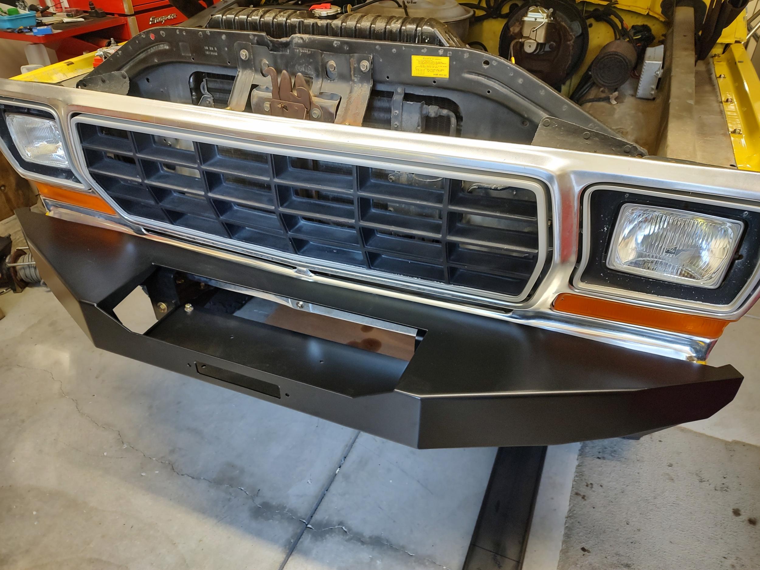

My Front bumper looks good almost finished getting welded up, my Buddy has offered to Powder Coat it as well. (I haven't got a price yet)

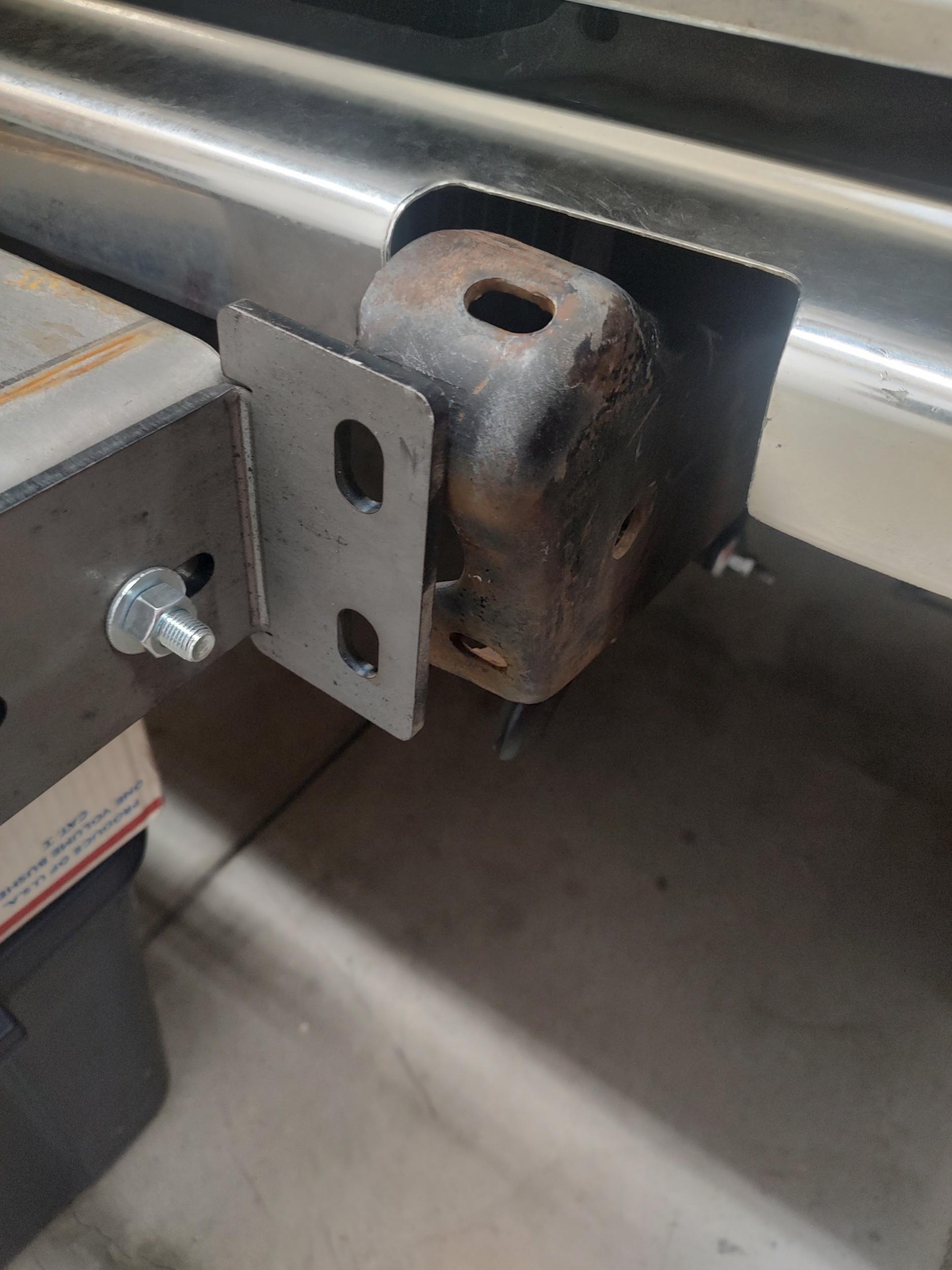

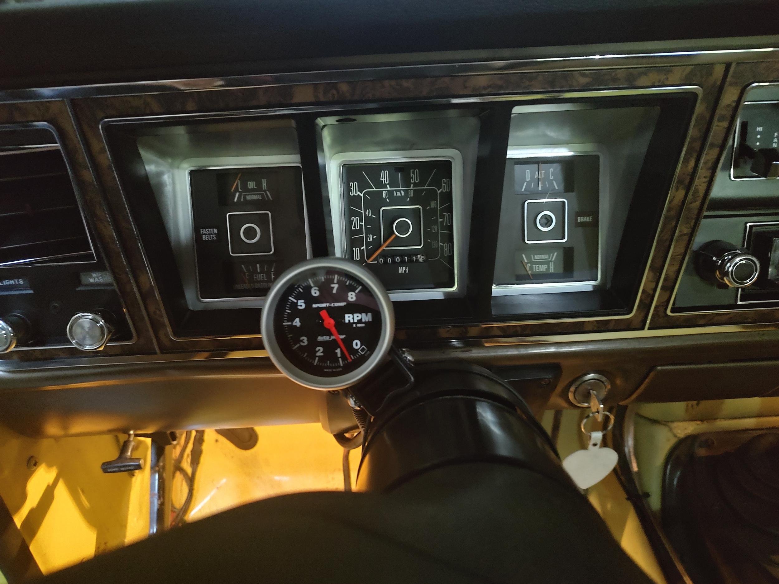

Installed the Mini Tachometer, and started the size up for the rear bumper. I salvaged the factory rear bumper brackets (or what was left) from the PO's kludge of a bumper and started doing a mock up. Cut down the square tube for just a little over hang on each side. My Buddy is talking about some thick material ( 1/2 > 5/8) to pass through the steel 3/16" tube so I can have solid anchor/tow points. It is a little beyond my pay grade, but he has this laser table and all... I'm always learning new things.
Add to that, the frame has a little ripple in the extended ends from the PO bumper, almost a 1/4 difference!

Front Bumper is done and mounted... I am going through the wiring on the Ramsey winch. I picked up a new cable and roller fairlead for it...

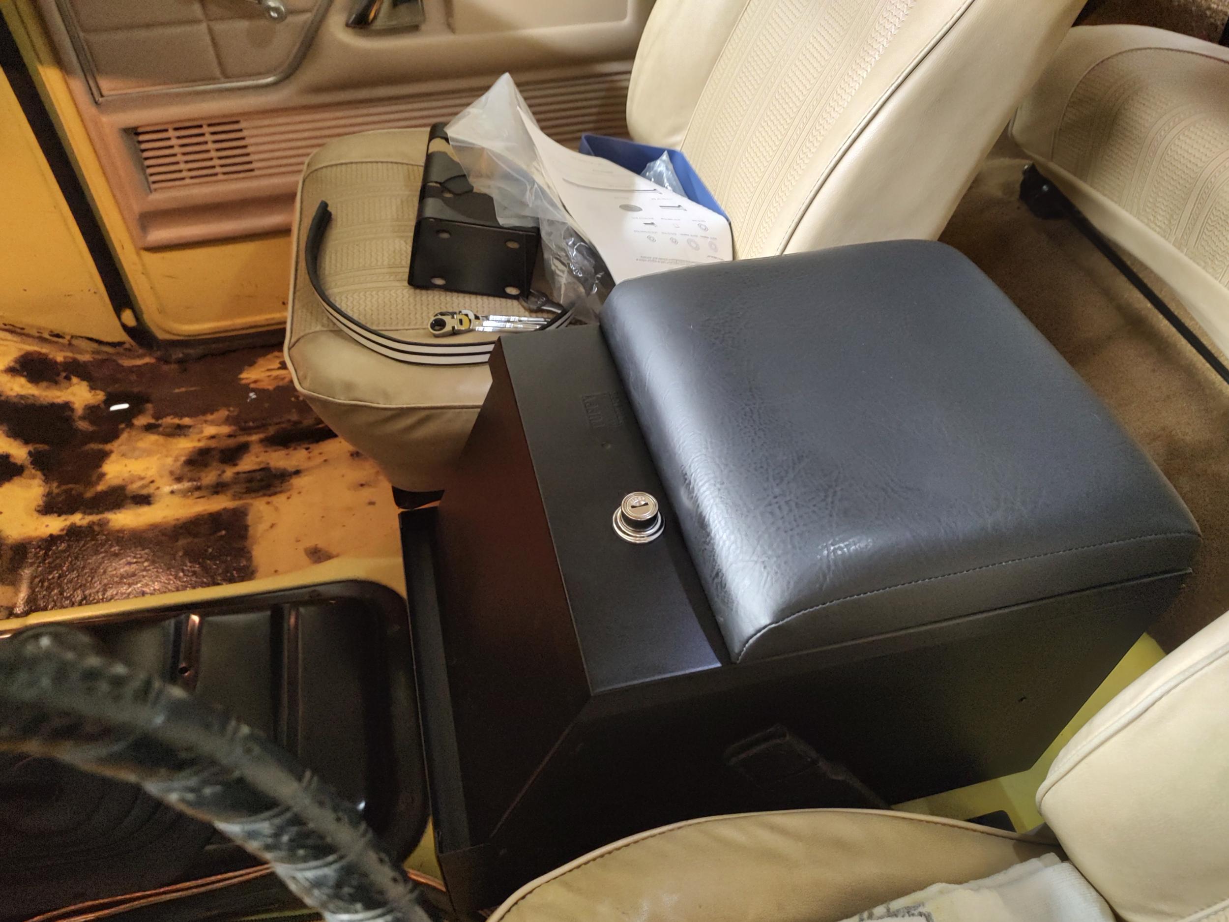

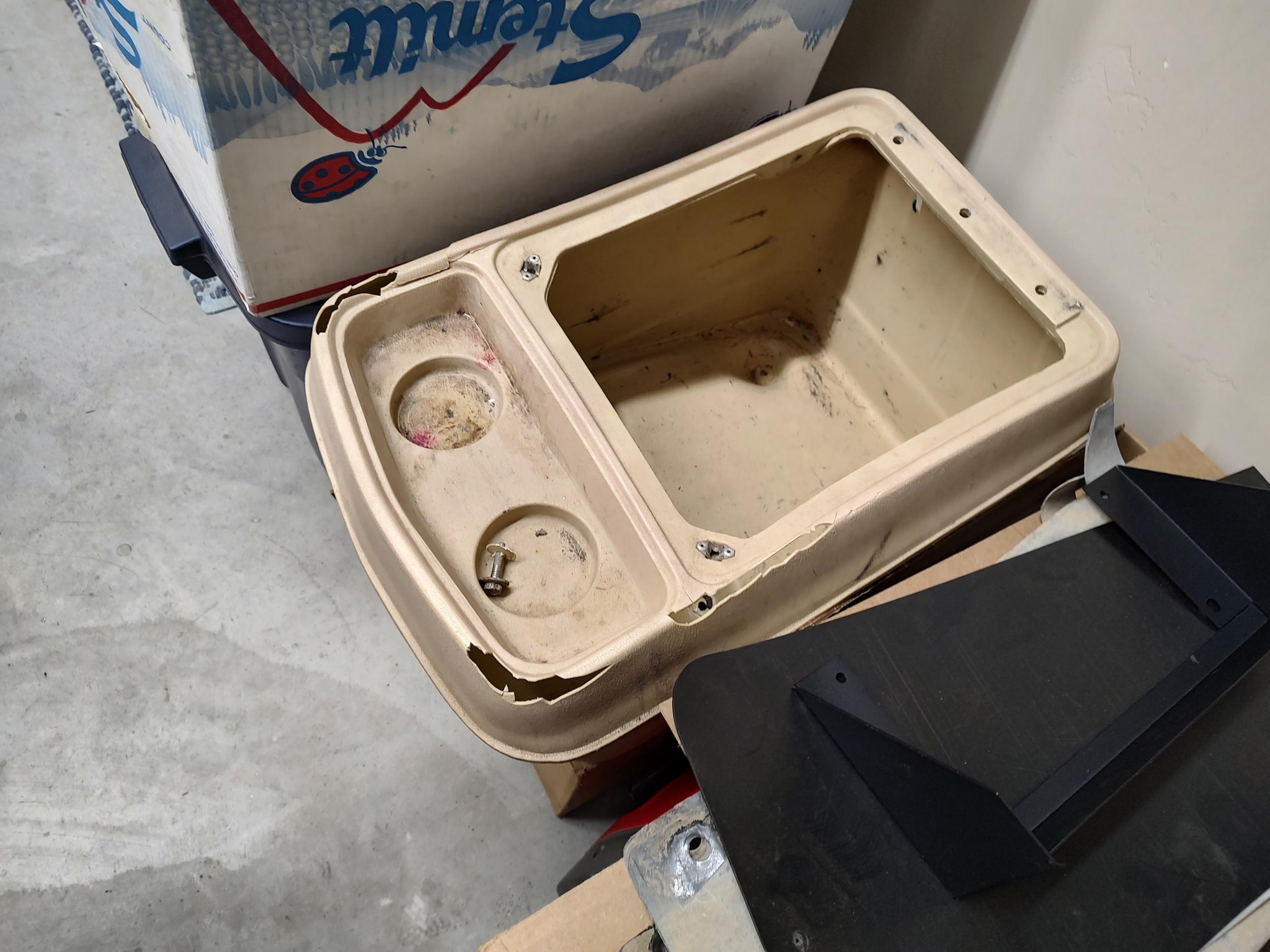

Picked up a Tuffy center console, factory one is toast, and well the used market prices +shipping are stupid.
Tuffy had a a 20% off sale on the 4th, $359 is the list price, $351 delivered to my door. Much better cup holders anyway! (As you can see in the last picture)

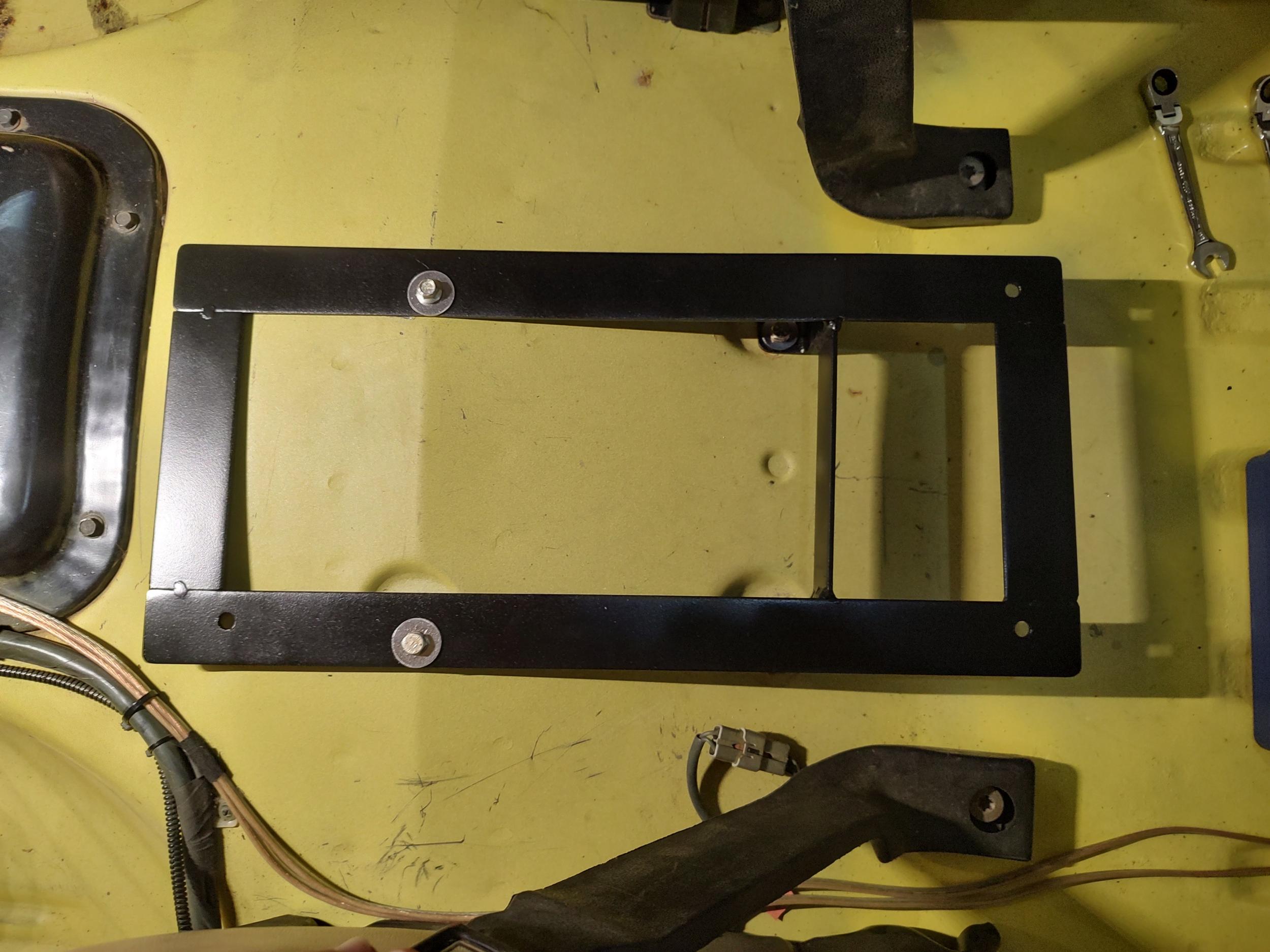

I had to make a mounting bracket, since the Gen II floor is not flat. Box is mounted, and the finish work will be done next week.
