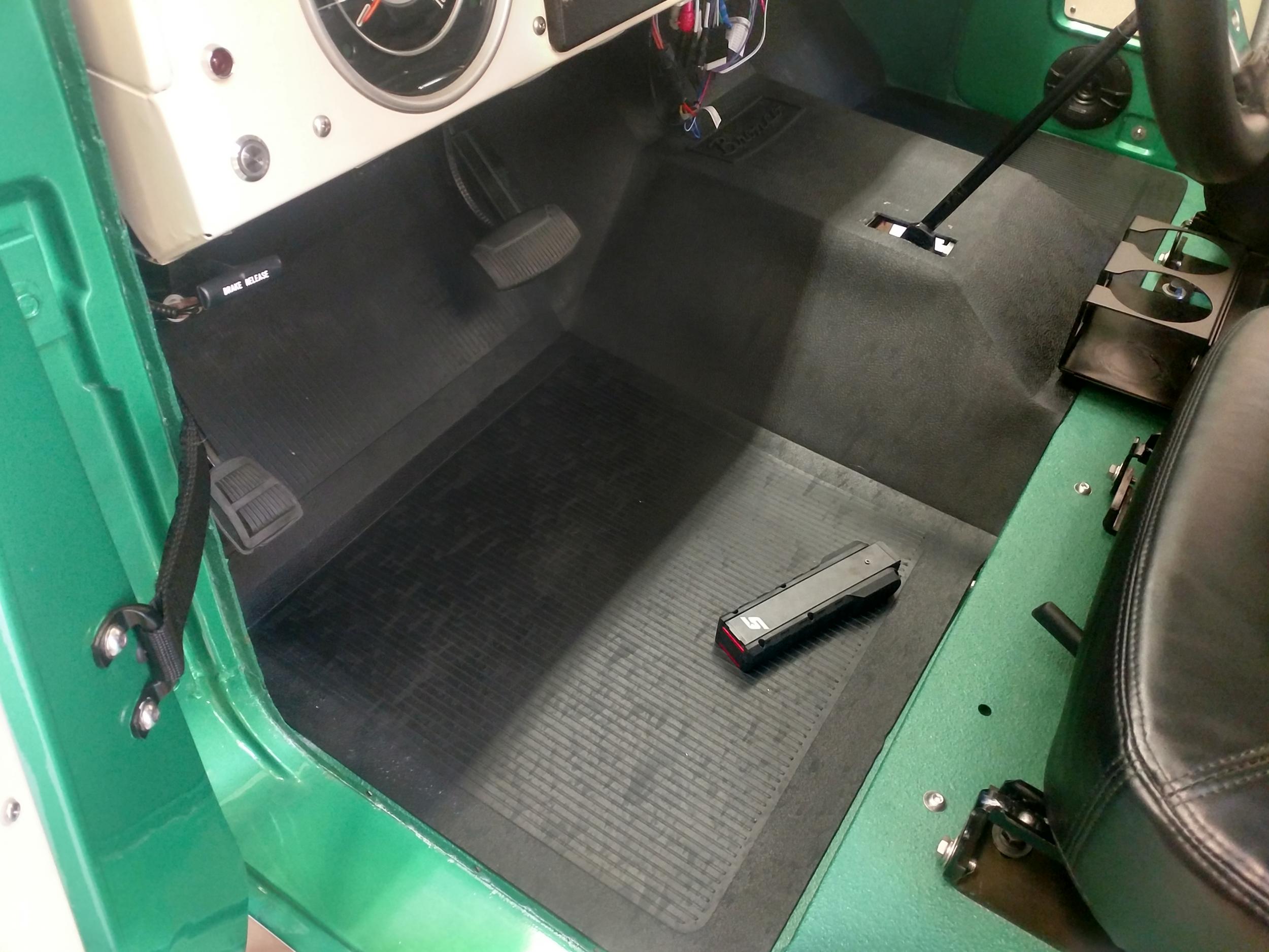

      Yes still working on it...

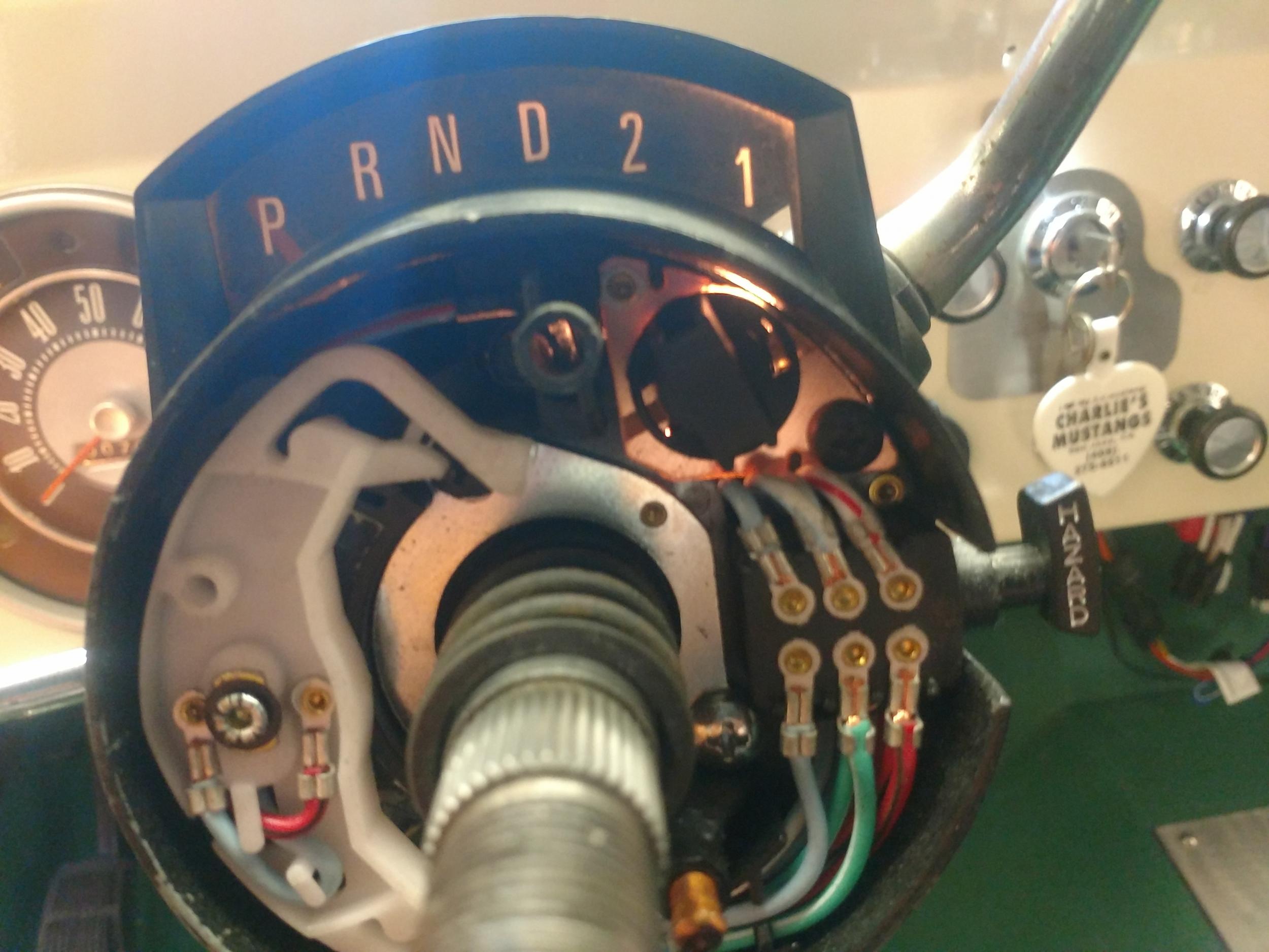

      Little things on the to do list, and the repairs of things that pop up... Like shifter illumination that stopped working.

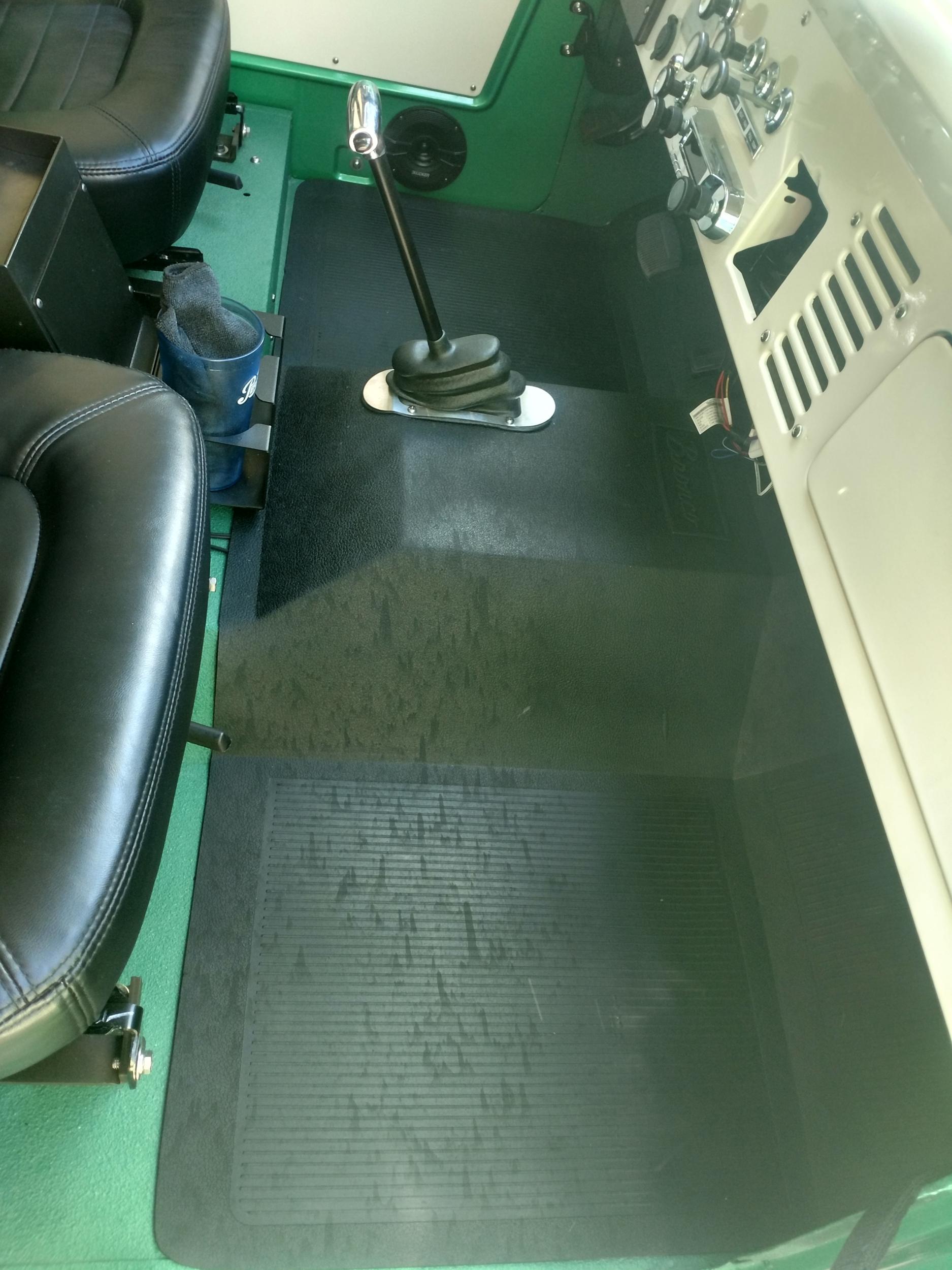

      New floor mat in front...
ID:	275013Click image for larger version

      • Re: 71 Lubr - Missing parts Build
        I like that floor mat. Looks good and probably helps quite down some of the road noise too.
          Looks great Doug.
          Patrick that mat is really nice. I put the same one in the front of my bronco, over top of dynamat. It definitely helps quiet things down, and decreases heat too.

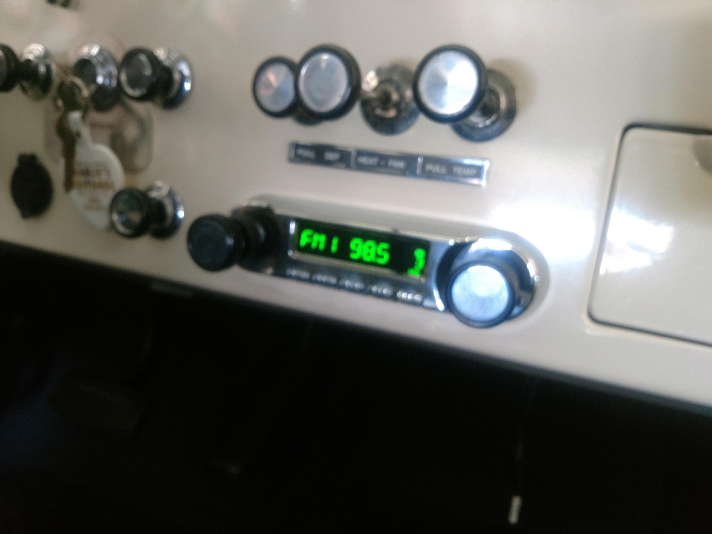

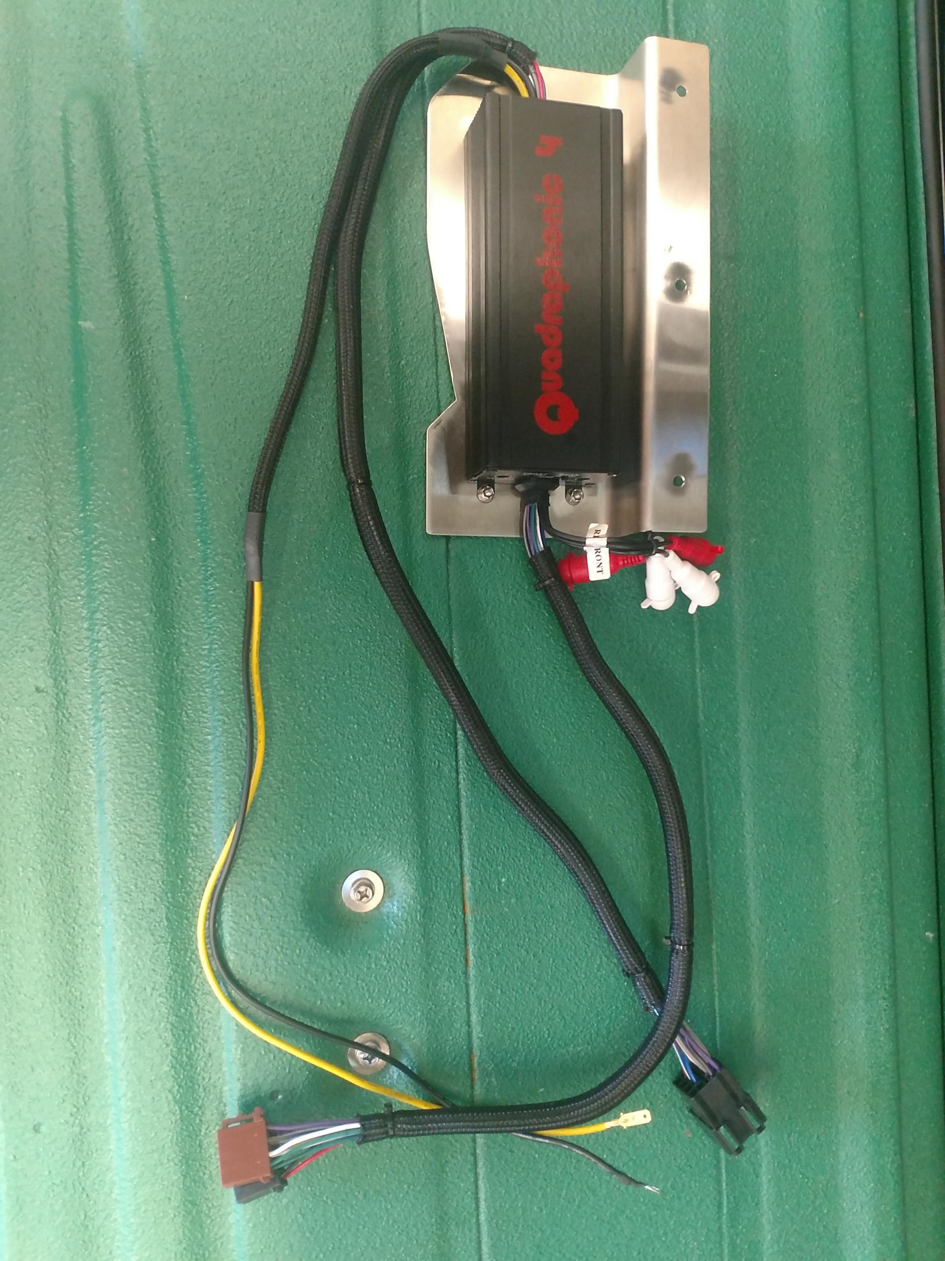

            Got the Resto-sounds Radio installed with its matching amp. Very Happy with the sound. Got all the components from WH's.

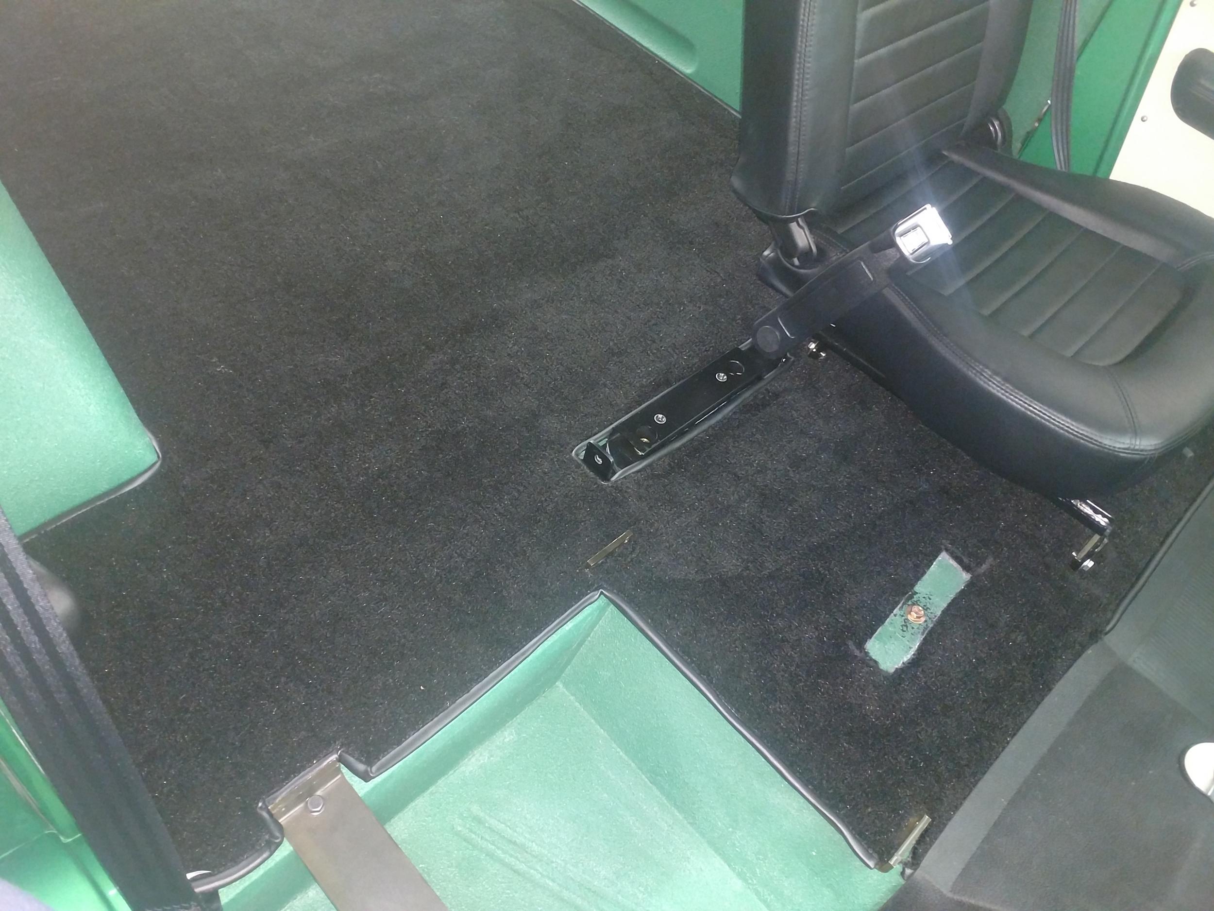

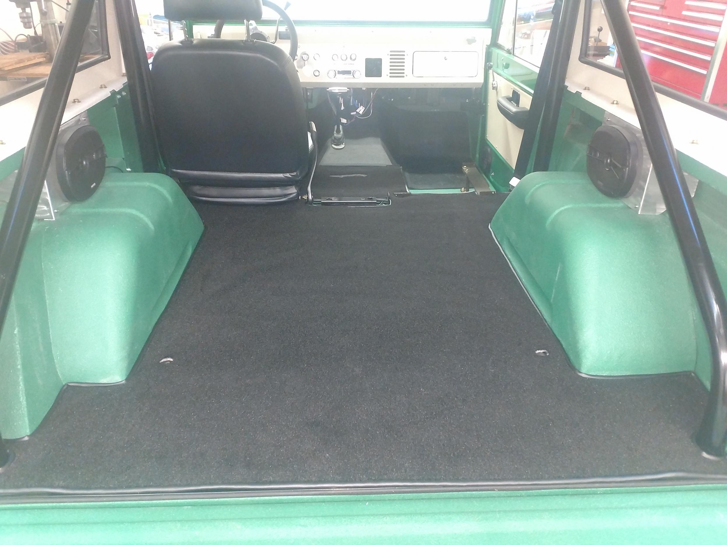

            Had carpet made for the back at a local shop.

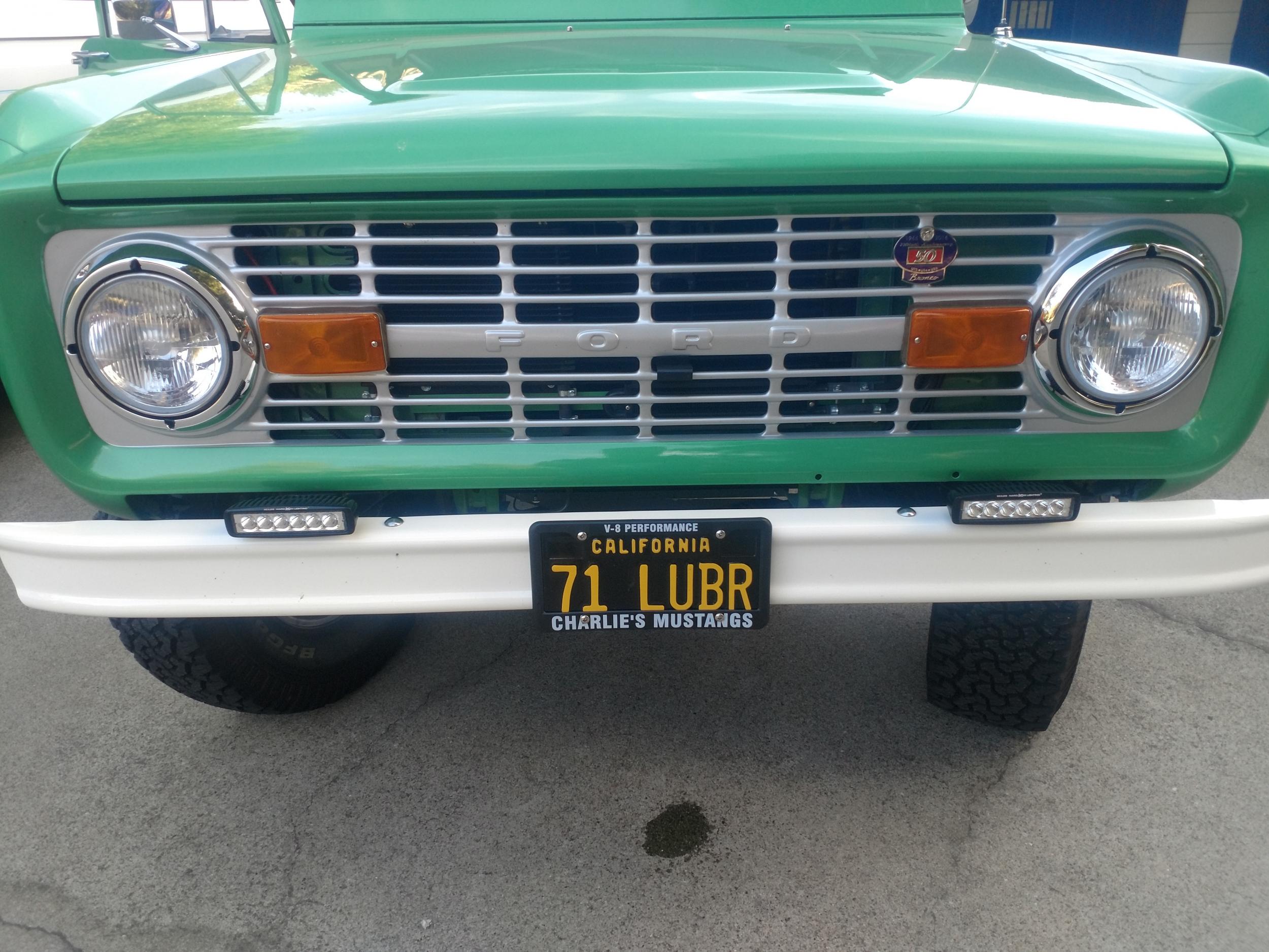

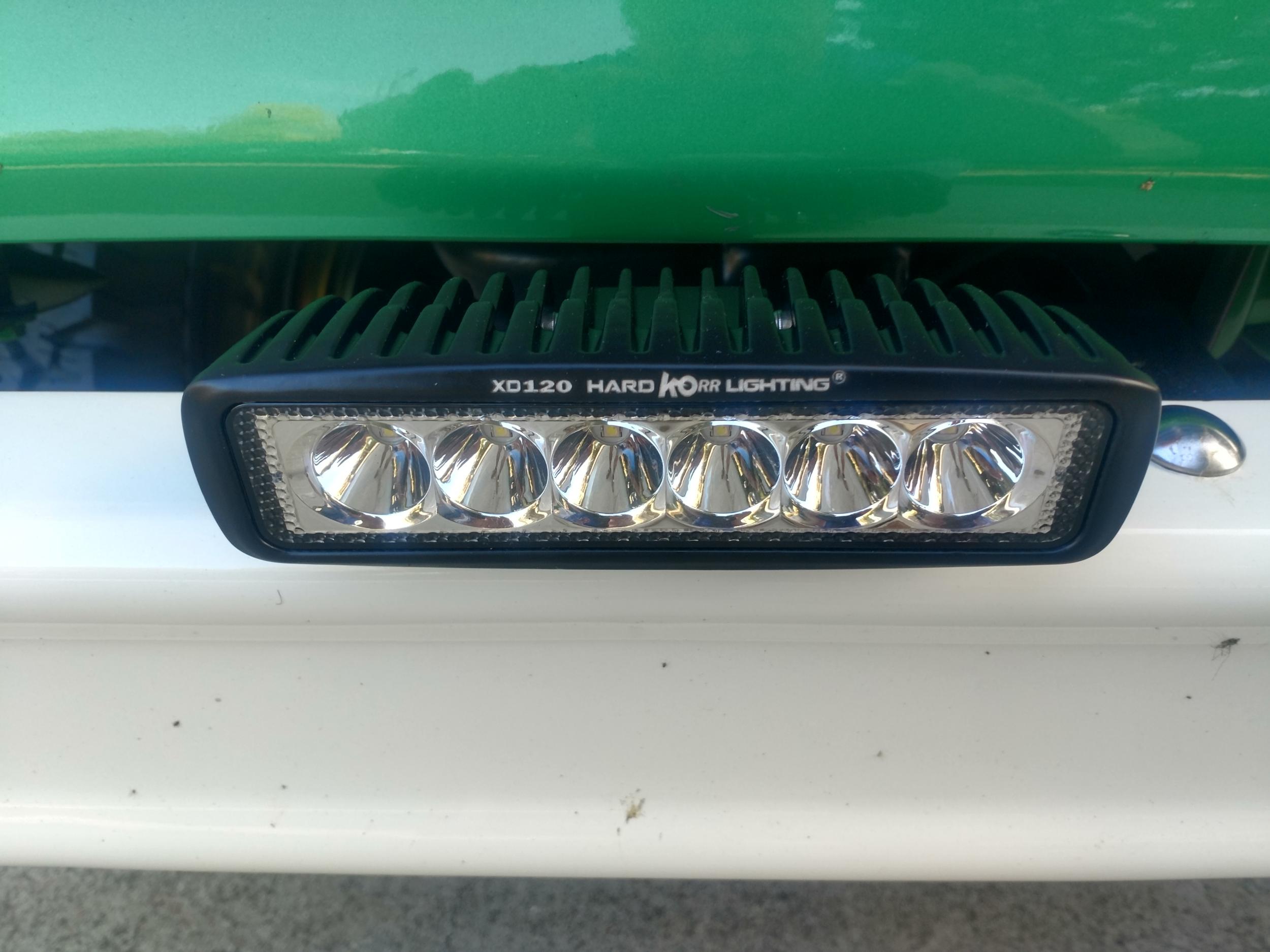

            Found these Hard Korr lights in a Booth at SEMA. Guys are from Australia and just opened an Office in LA. High end Osram bulbs, but Chinese built. Got a screaming deal on the price since it was Friday and they did not want to pack them up to take home.

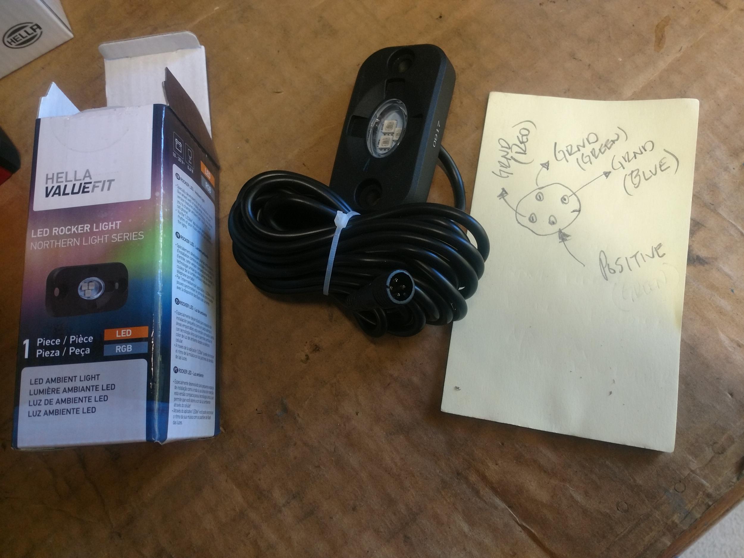

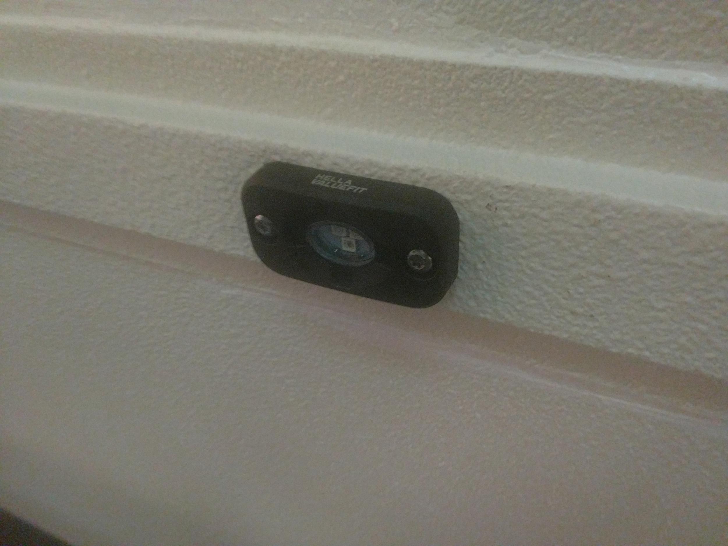

            Found these lights in the Hella booth at SEMA. Made for exterior lighting that you can tie into music for Bling or adjust colors with an App from your phone. I got them (two) for interior lights. Depending on how you power them, you can have a red/blue/green/white light. All three tied together is the brightest for the white. ($9.95 ea at Summit)

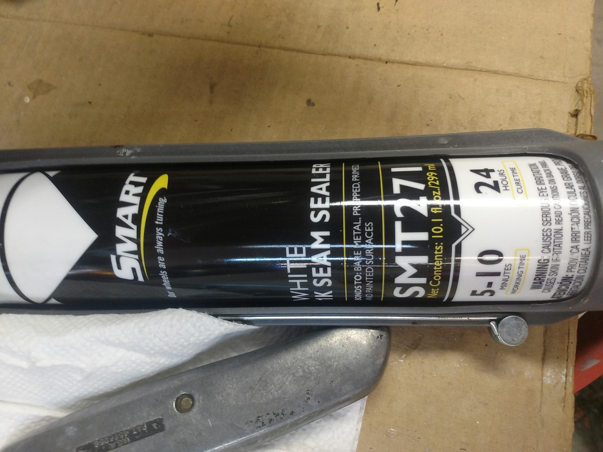

                Looks good Doug! I would like to see that aluminum wiper cover once you get a picture. What did you use to adhere the bows back to the hard top? I need to do this to mine and I wasn't sure what kind of adhesive to use.

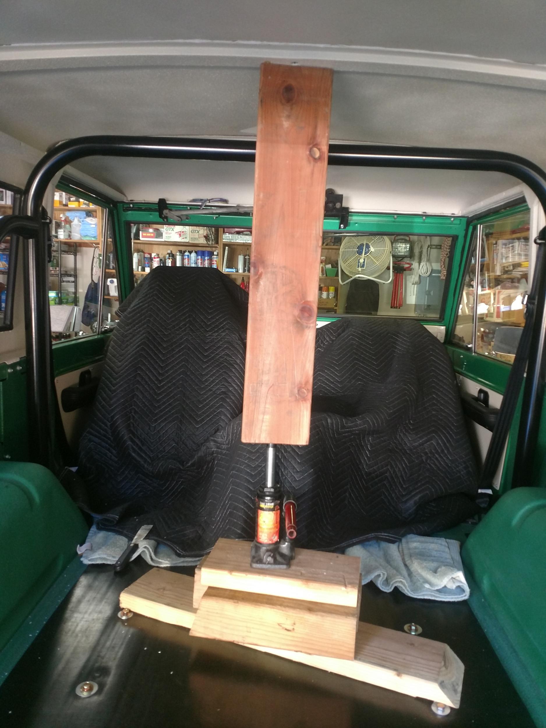

                  Patrick, I went round and round with Finish Masters in Gilroy (body/paint/supplies place) about what to use. A hard bond may cause issues with heat/cooling...
                  The body shop here in town said the stuff pictured as it will allow flex due to temp changes. You have to remove the two sided tape Ford used and clean thoroughly B4 use.
                  I did a 24 hr set time with the jack in place.

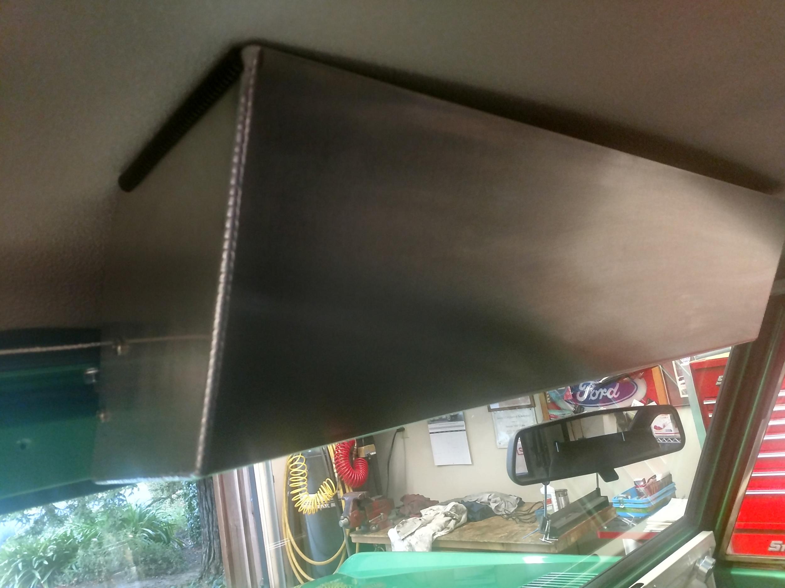

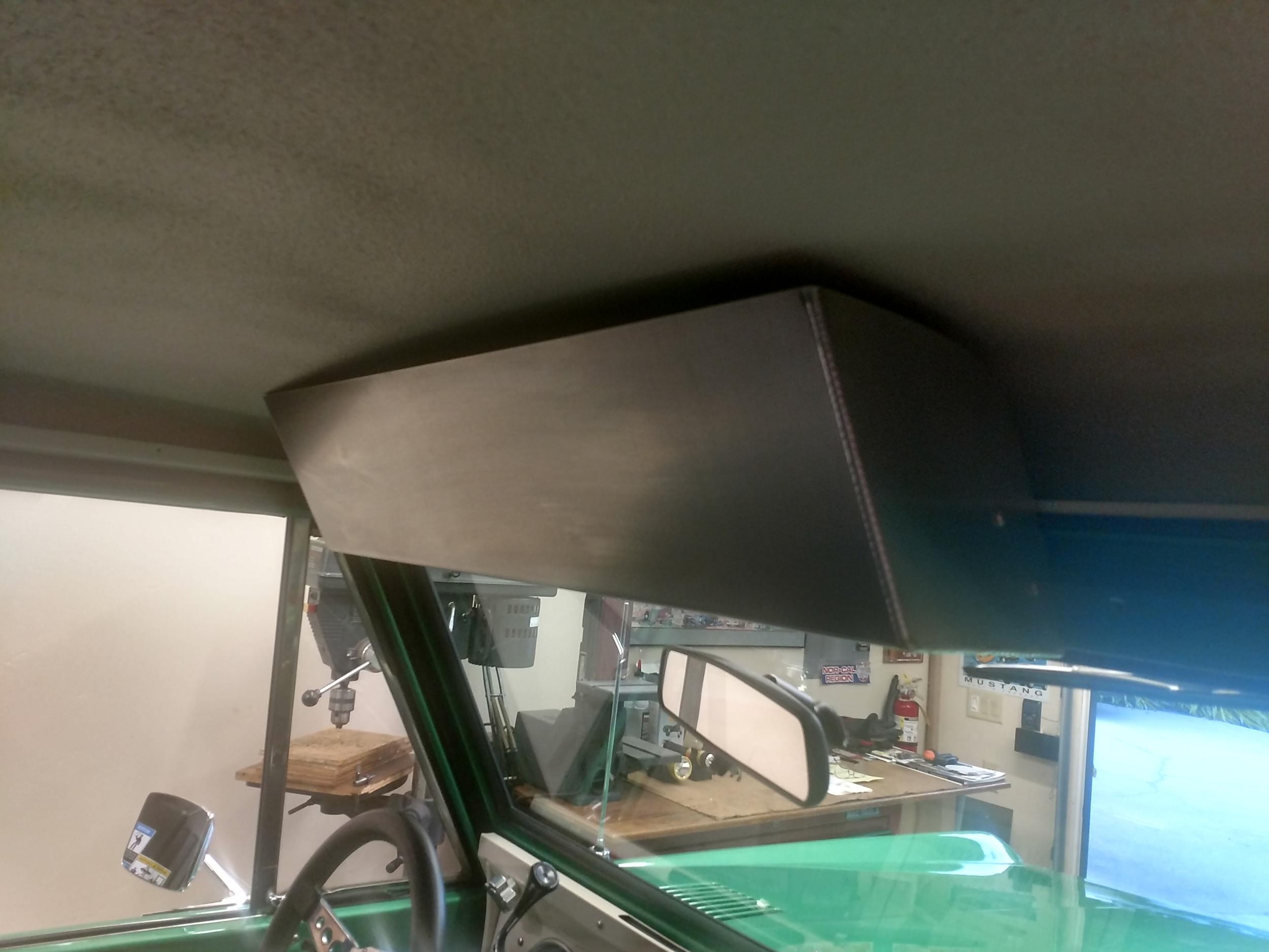

                  Wiper cover, fits using the factory brackets. I could have made it a tad shorter... The idea was I could put gauges in it, like I had in the 68.
                  The factory gauges are not close to what the ECU is seeing from its sensors... Voltage is low on factory rehab'd cluster, Temp reads high?
                  I like the idea of an all in one aftermarket instrument cluster, but the price is ...

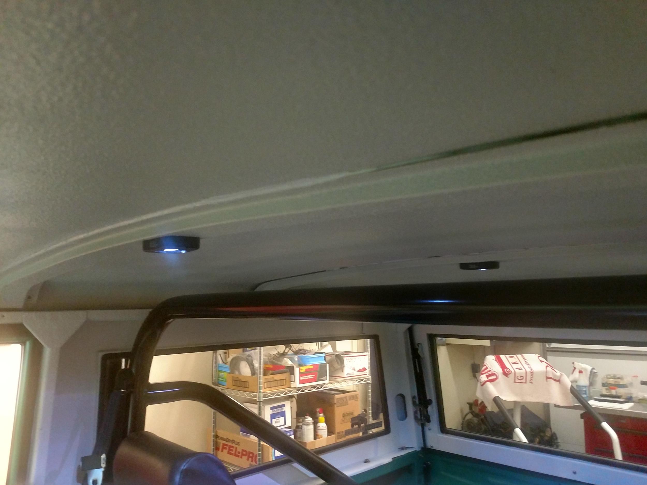

                    Hella lights installed.
                    Drill one hole to pass wire through, fish it down the support bow to the side, drill two more to mount unit with short self tapping screws.
                    Ground and power come from windshield area, with a GM weather pack connector if I want to remove the top.

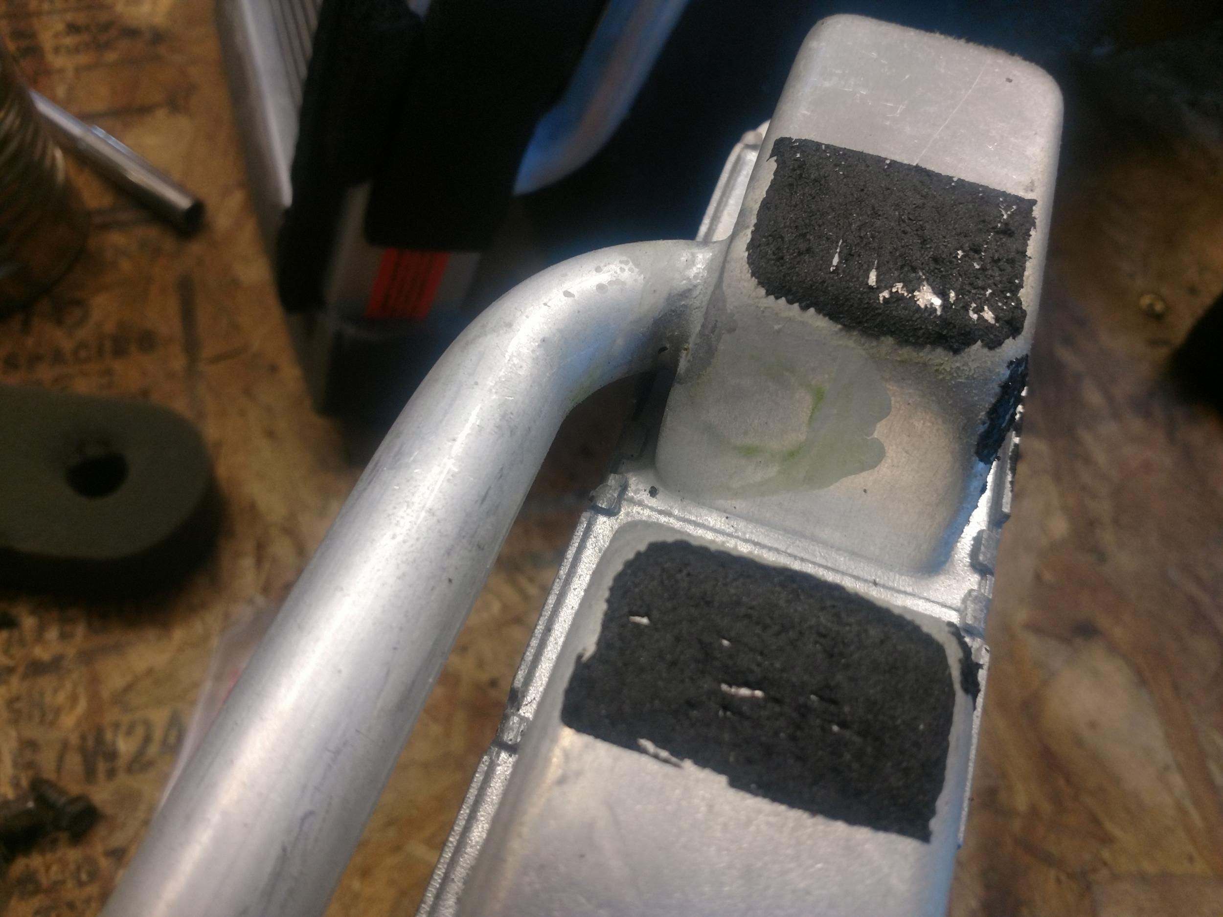

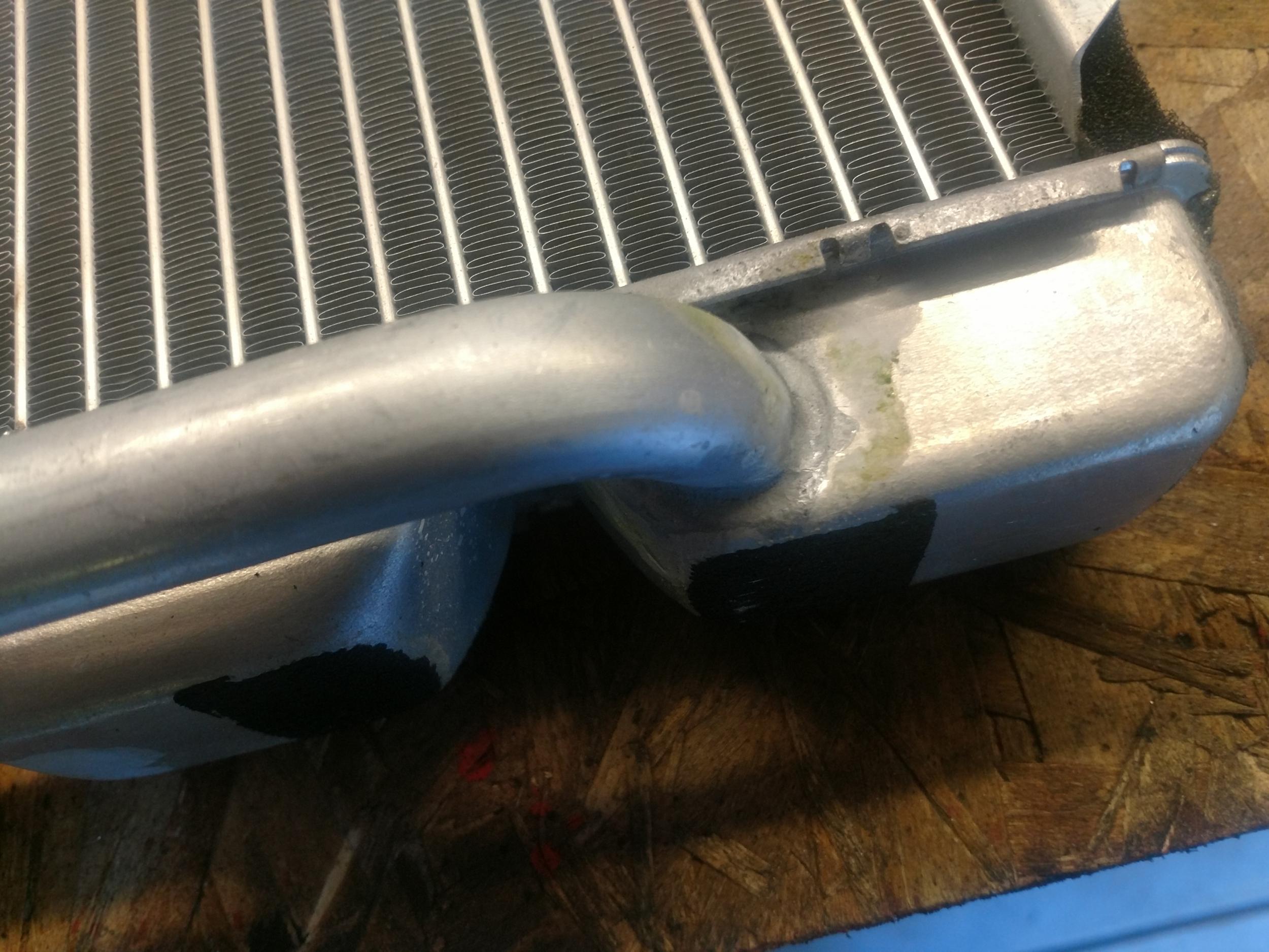

                        So 1,600 miles on my Bronco and the new heater core (NAPA) started leaking the 1st time I used the heater this year... A do-able job, but one I was hoping not to revisit sooo soon.
                        Trying a WH's Heater core this time.

                          The leak... What a bitch it is to take out the heater box after you add stereo, lighting, sound deadening, etc

                              My WH aluminum heater core leaked in that exact location with about the same time on it. I’m in the process of changing mine out for an old ford one I picked up in a swap meet.
