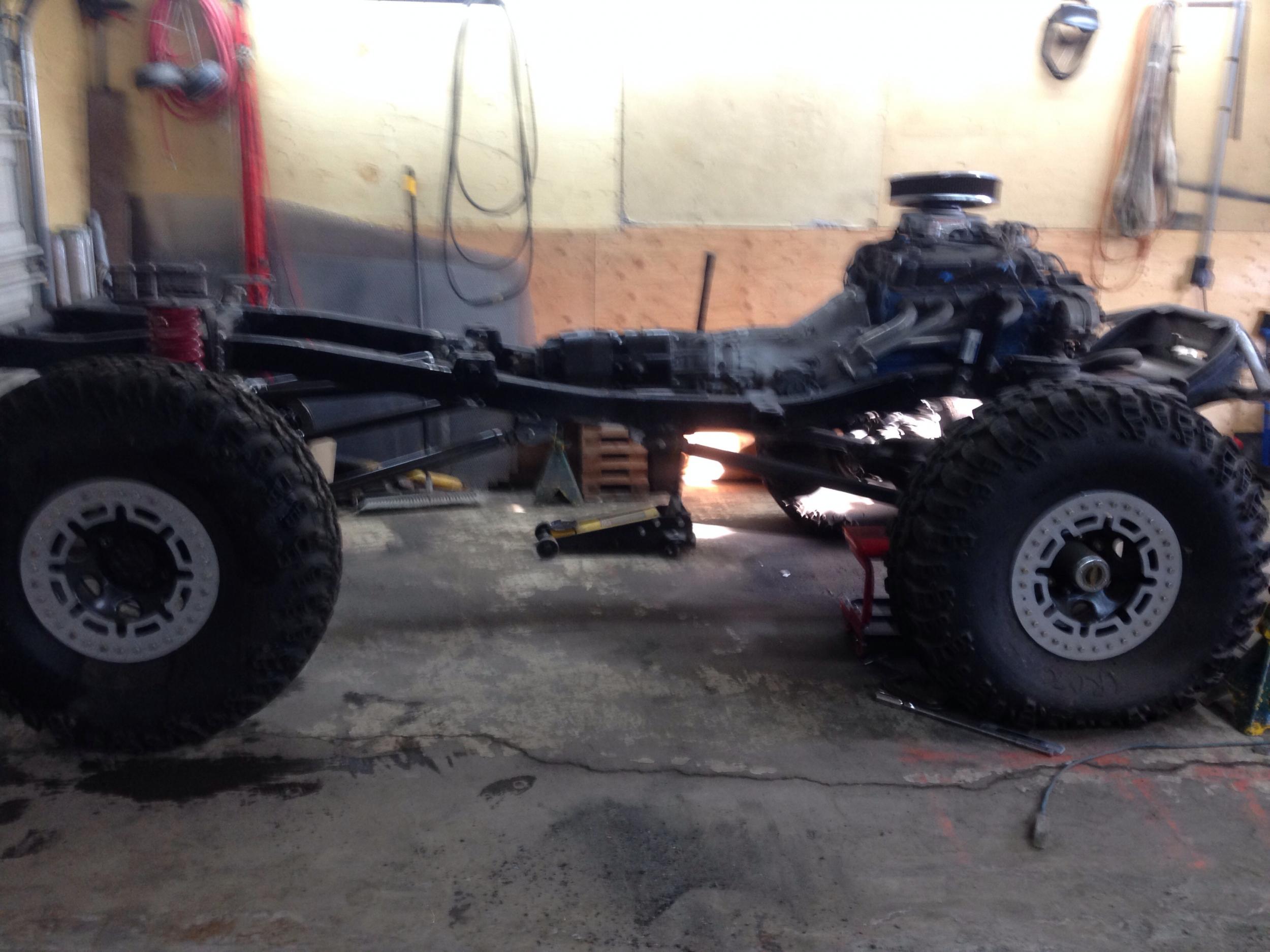

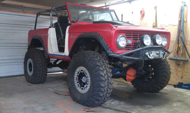

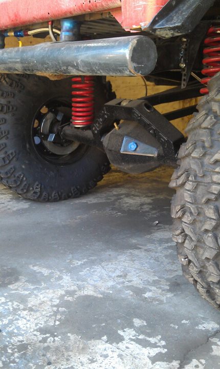

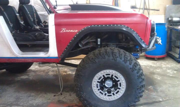

79 HP D60 with 4.88 Eaton Elocker, Yukons and Spicers, 35 spline Warn Premiums.

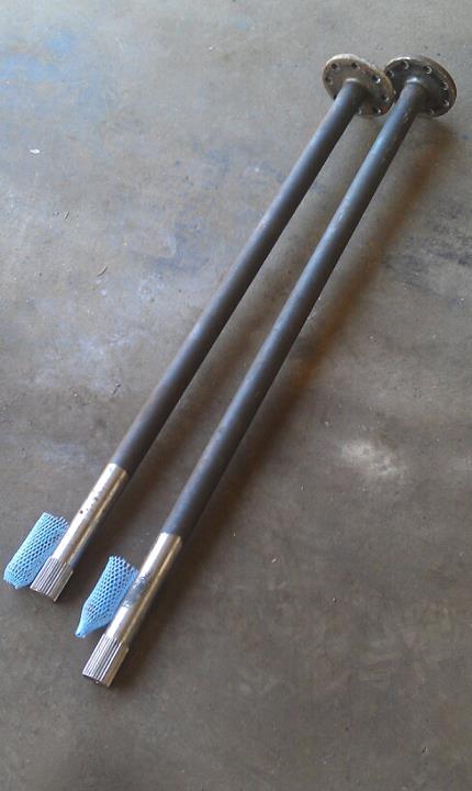

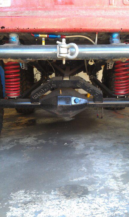

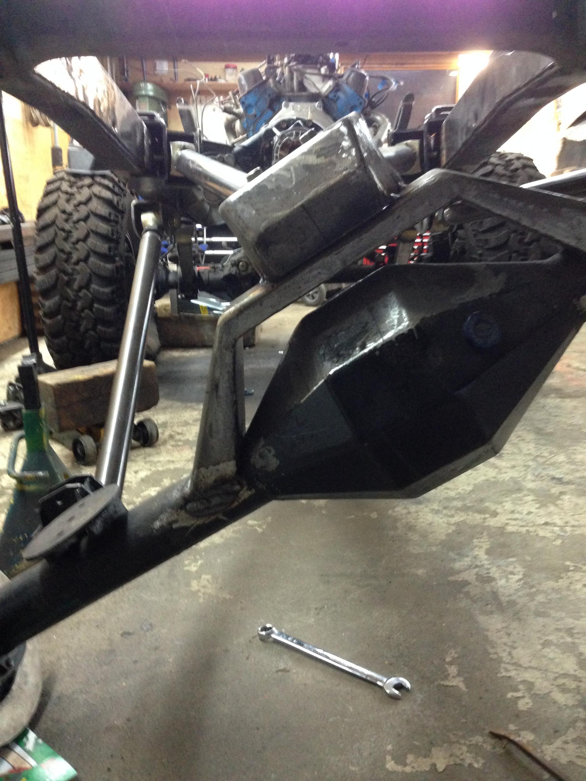

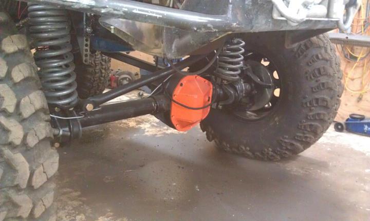

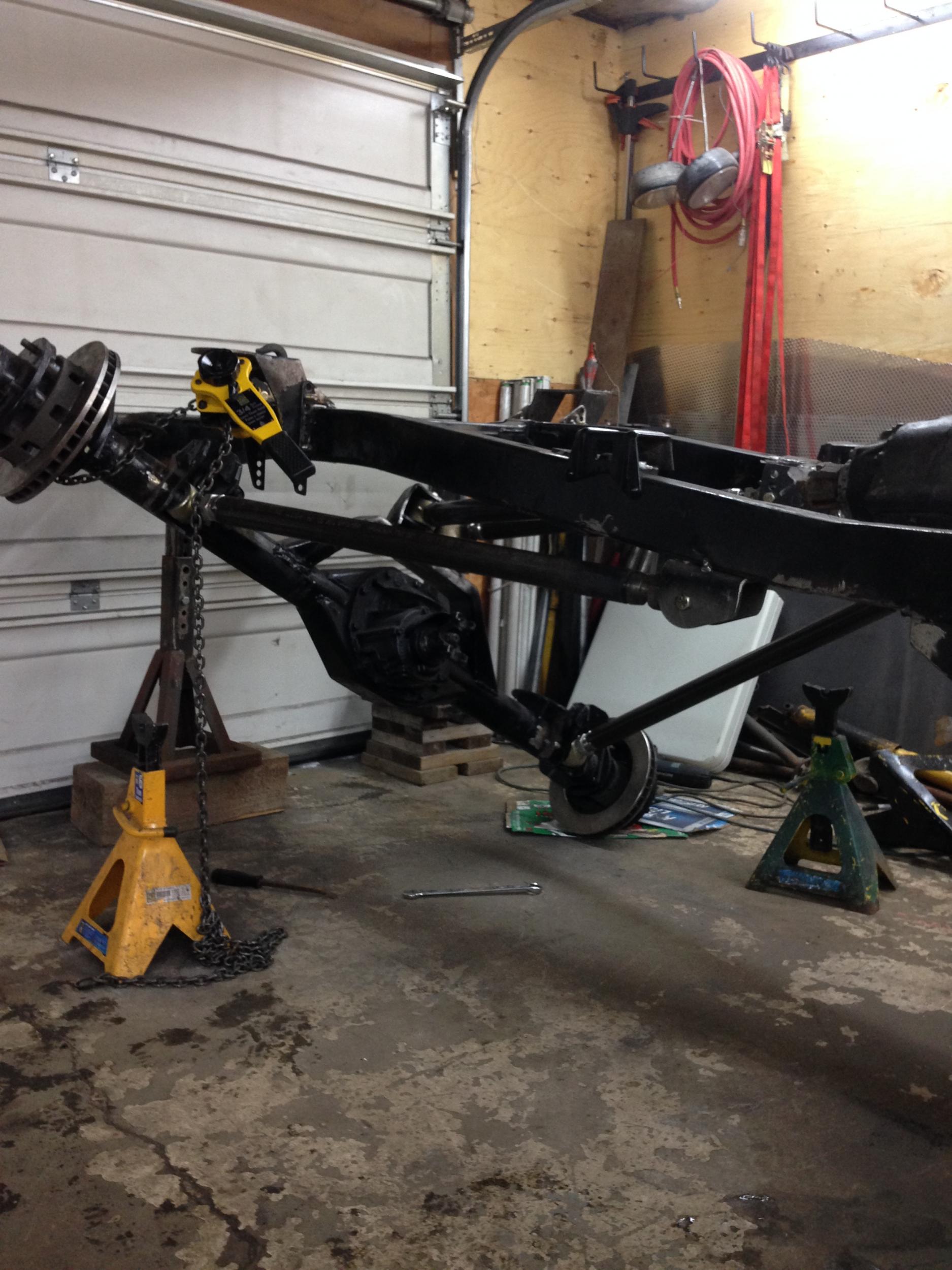

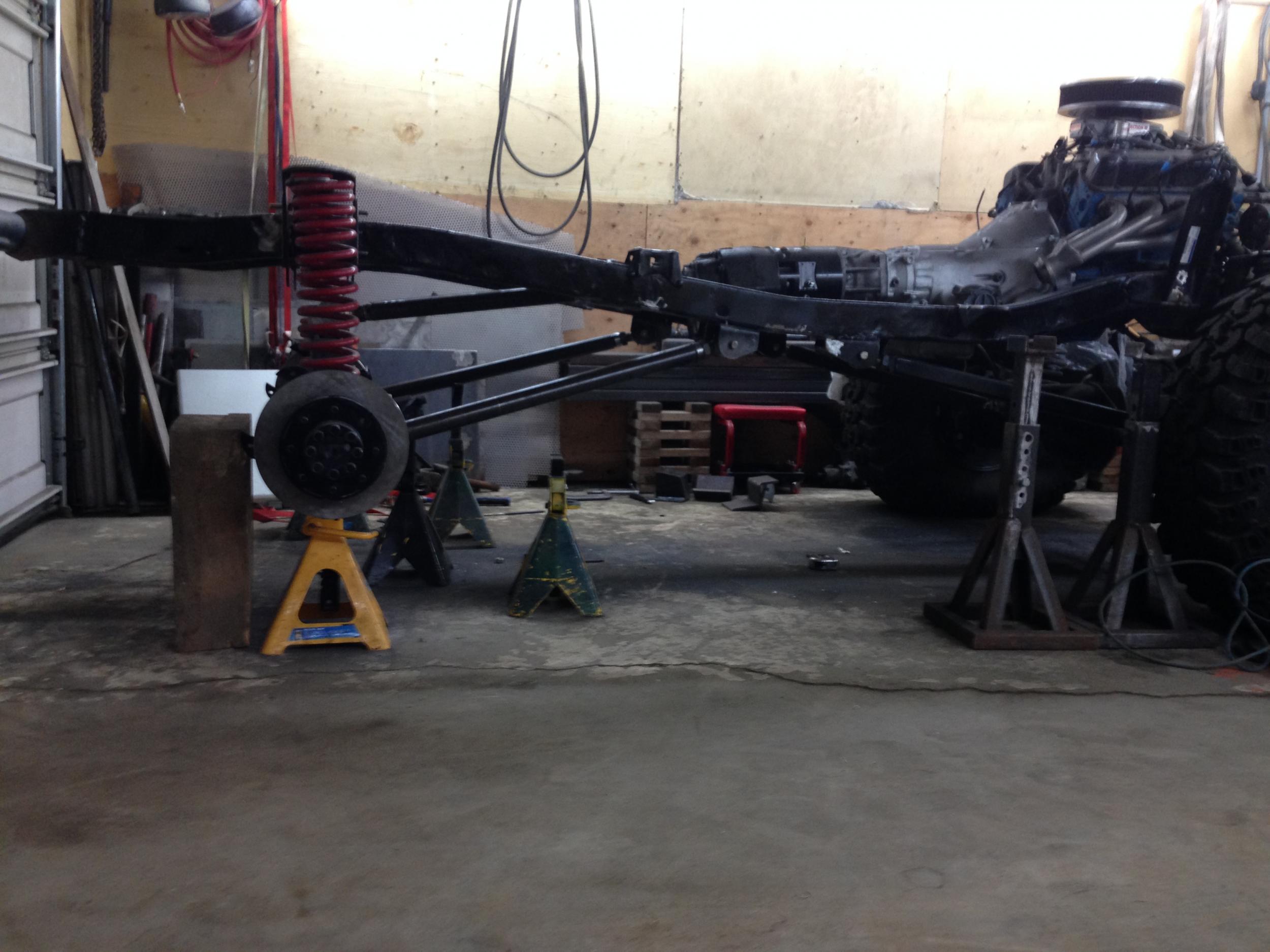

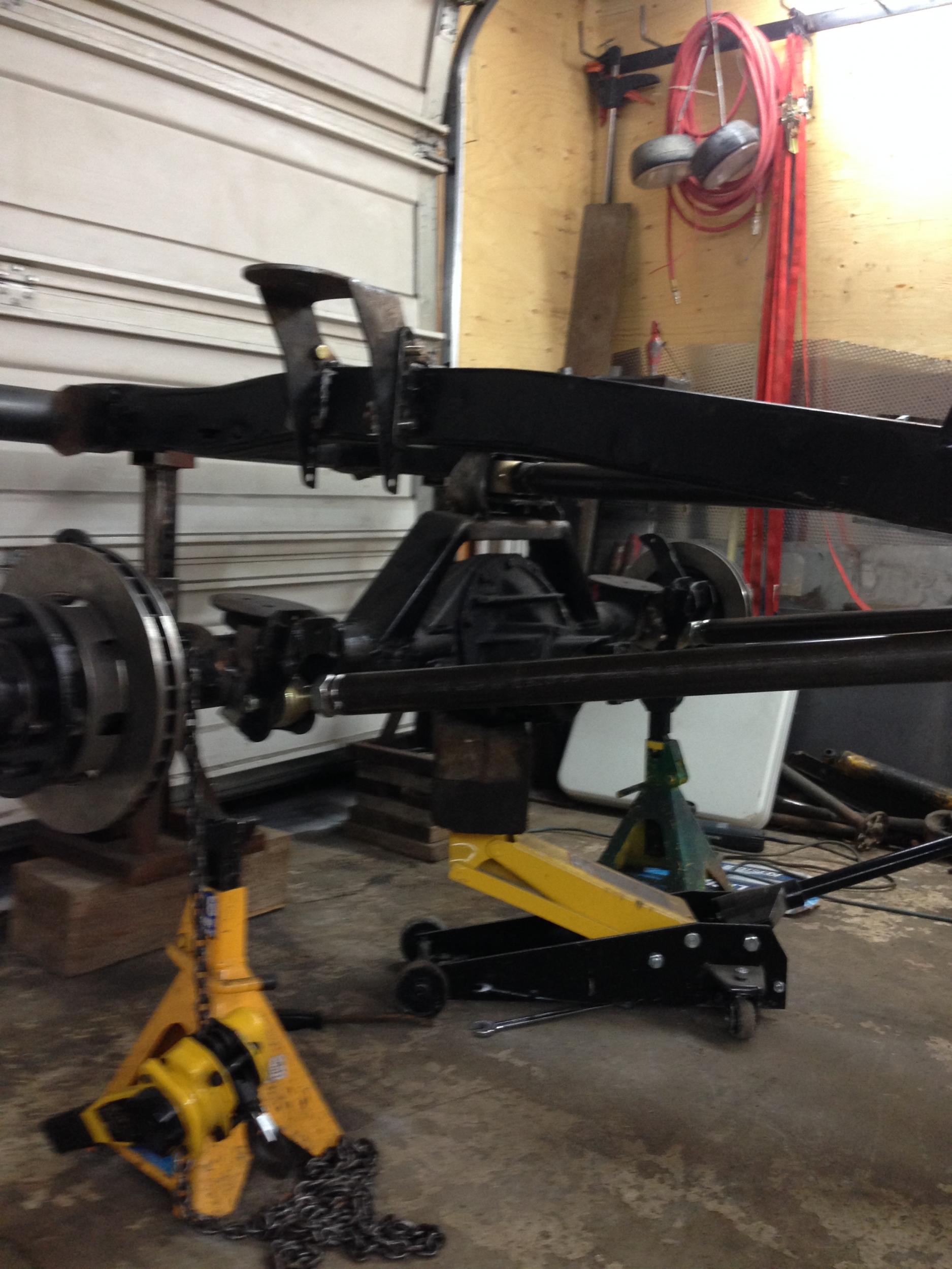

SpiderTrax 3.5" tubed housing with cut off and welded 14 bolt outers and disc brakes, 4.88 Detroit Locker from the old housing, shortened and resplined 14 bolt axles to fit my 9" Detroit.

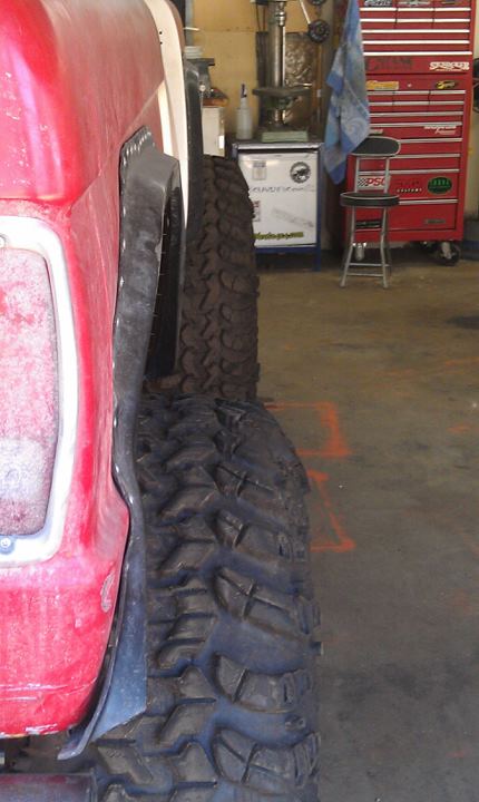

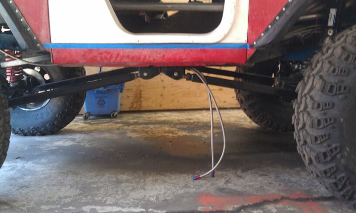

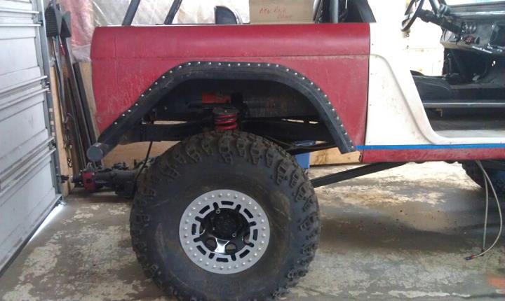

Long arm up front, Triangulated 3 link with coils. Front pushed forward 4", Rear the same, so somewhere in the 99-100" WB range with 3" out each side.

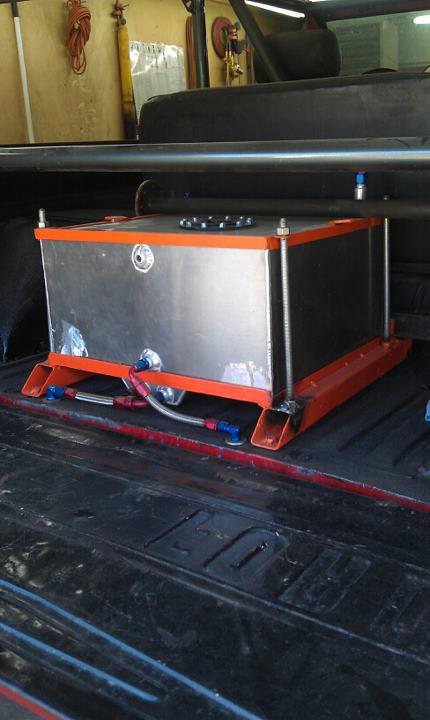

15 gallon fuel cell (probably get swapped out for a custom one to move the back seat back some) for ground clearance.

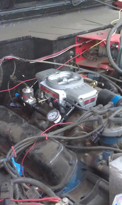

PowerJectionIII throttle body injection, tryin it out since its laptop tunable.

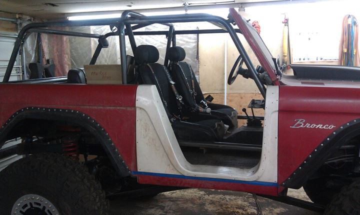

New cage for more head room front and back, may incorporate dash and center console into it.
