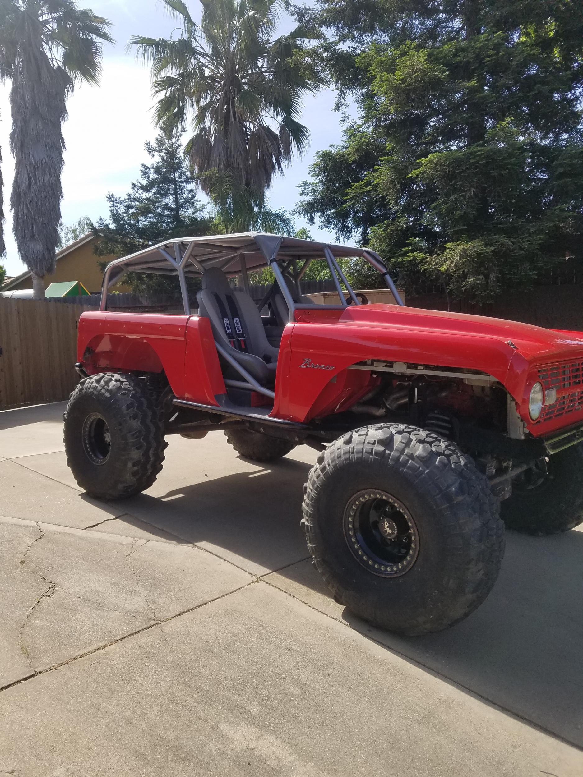

    Shiniest rockcrawler around! Looks great with red corner guards.

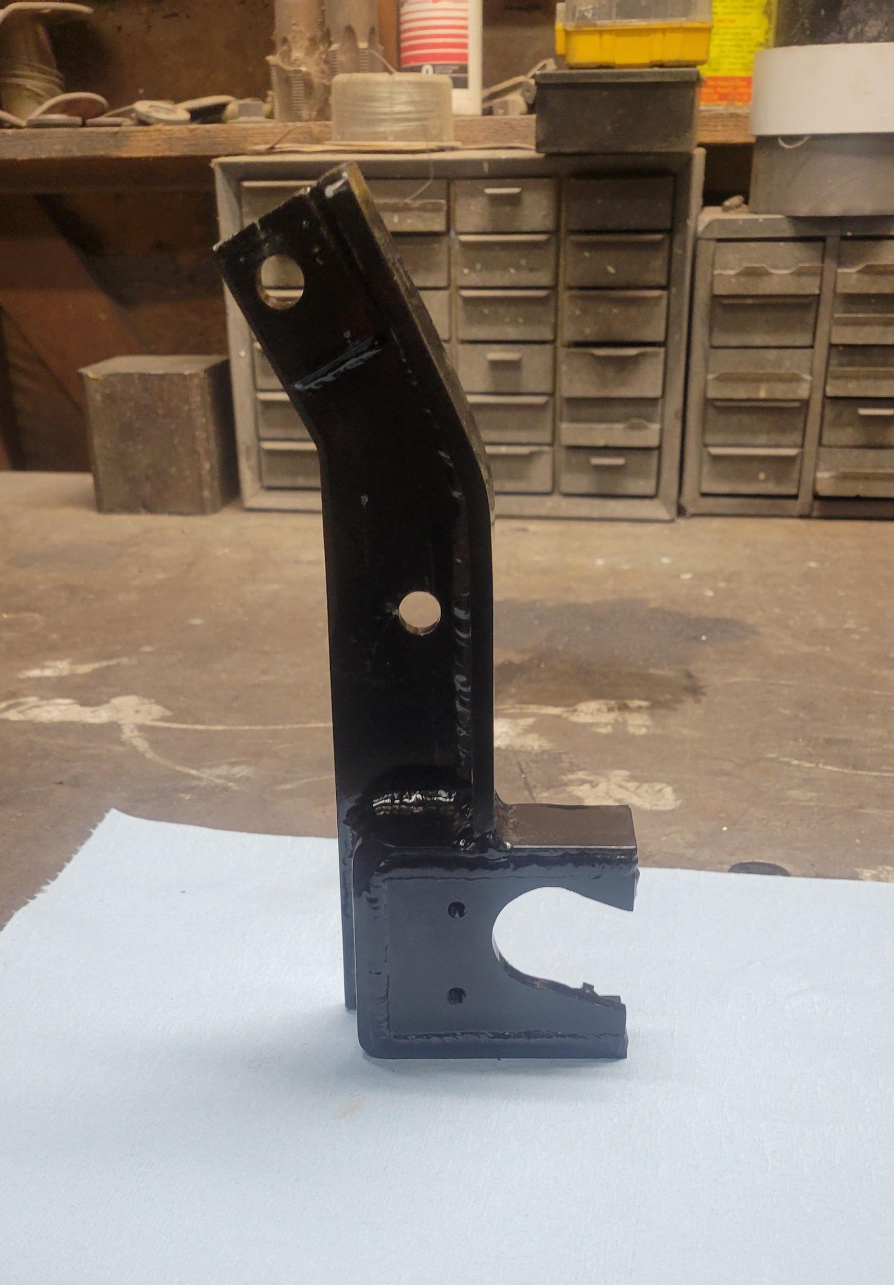

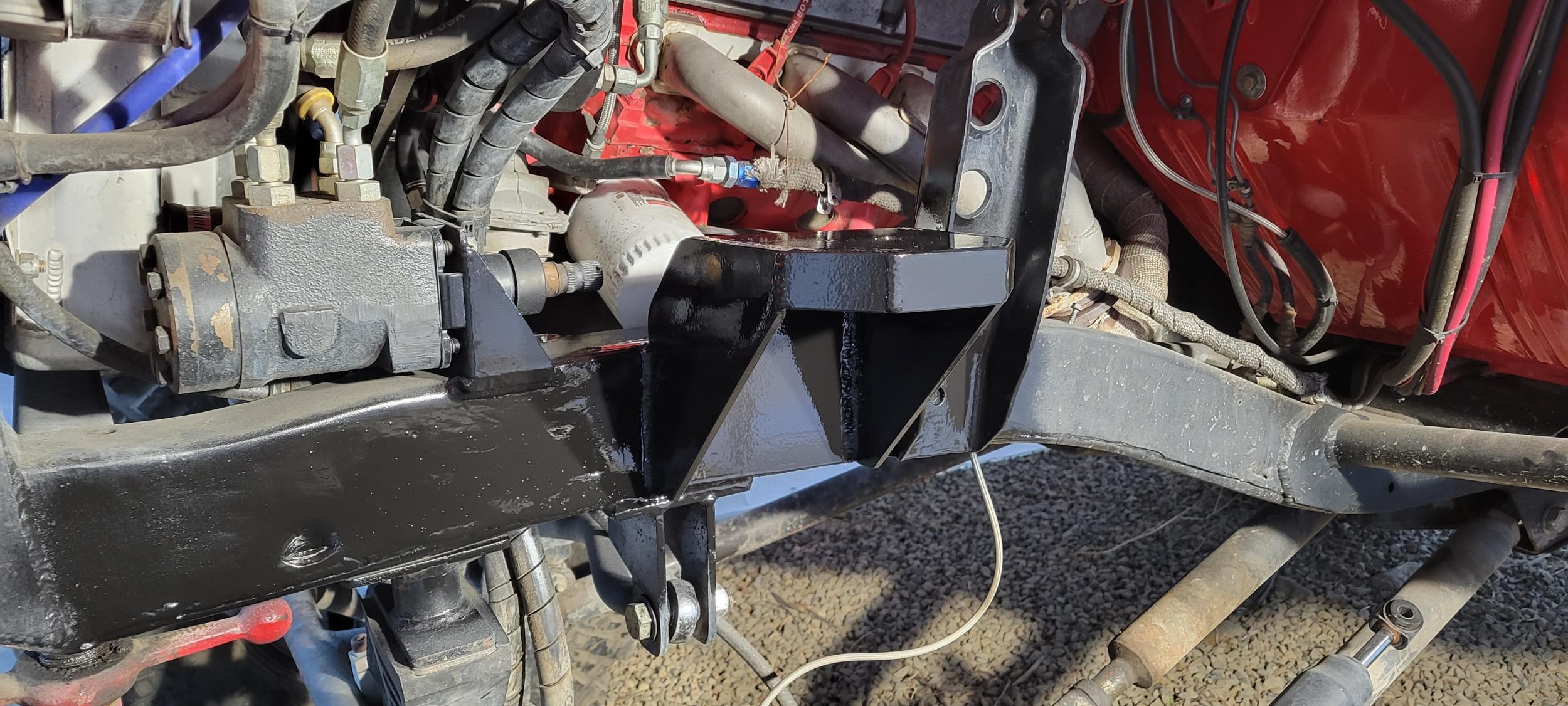

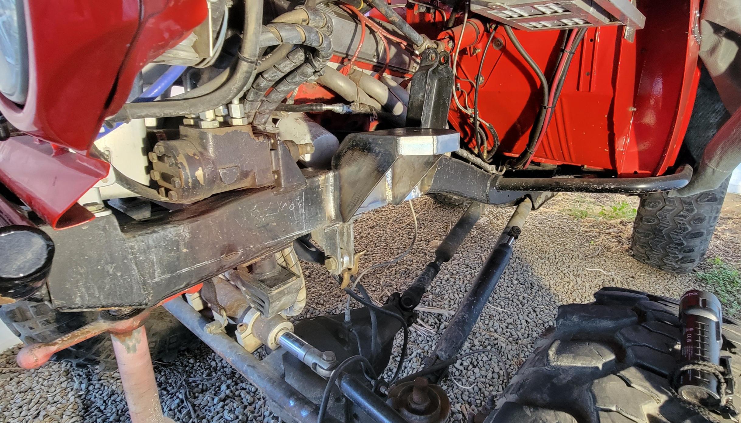

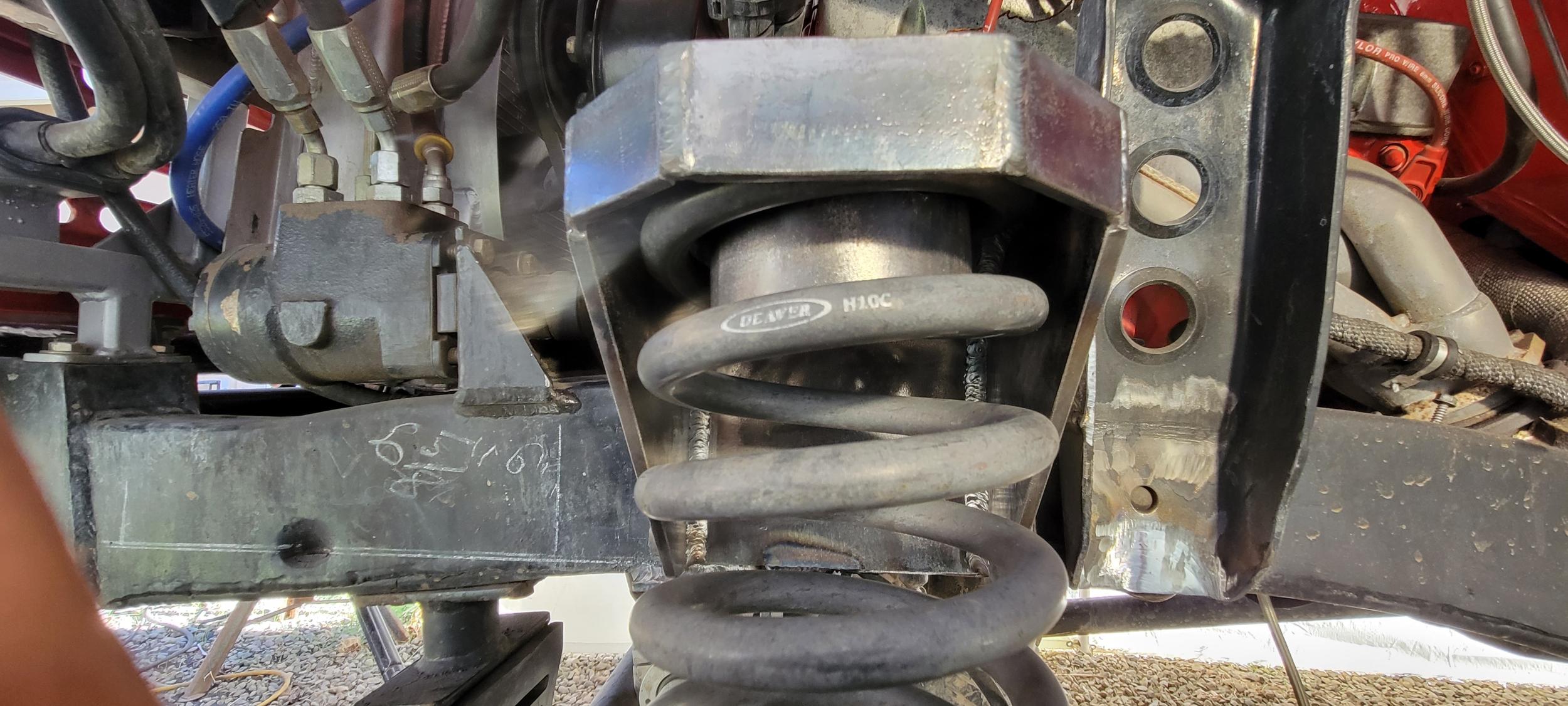

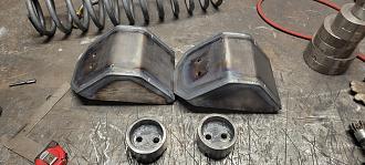

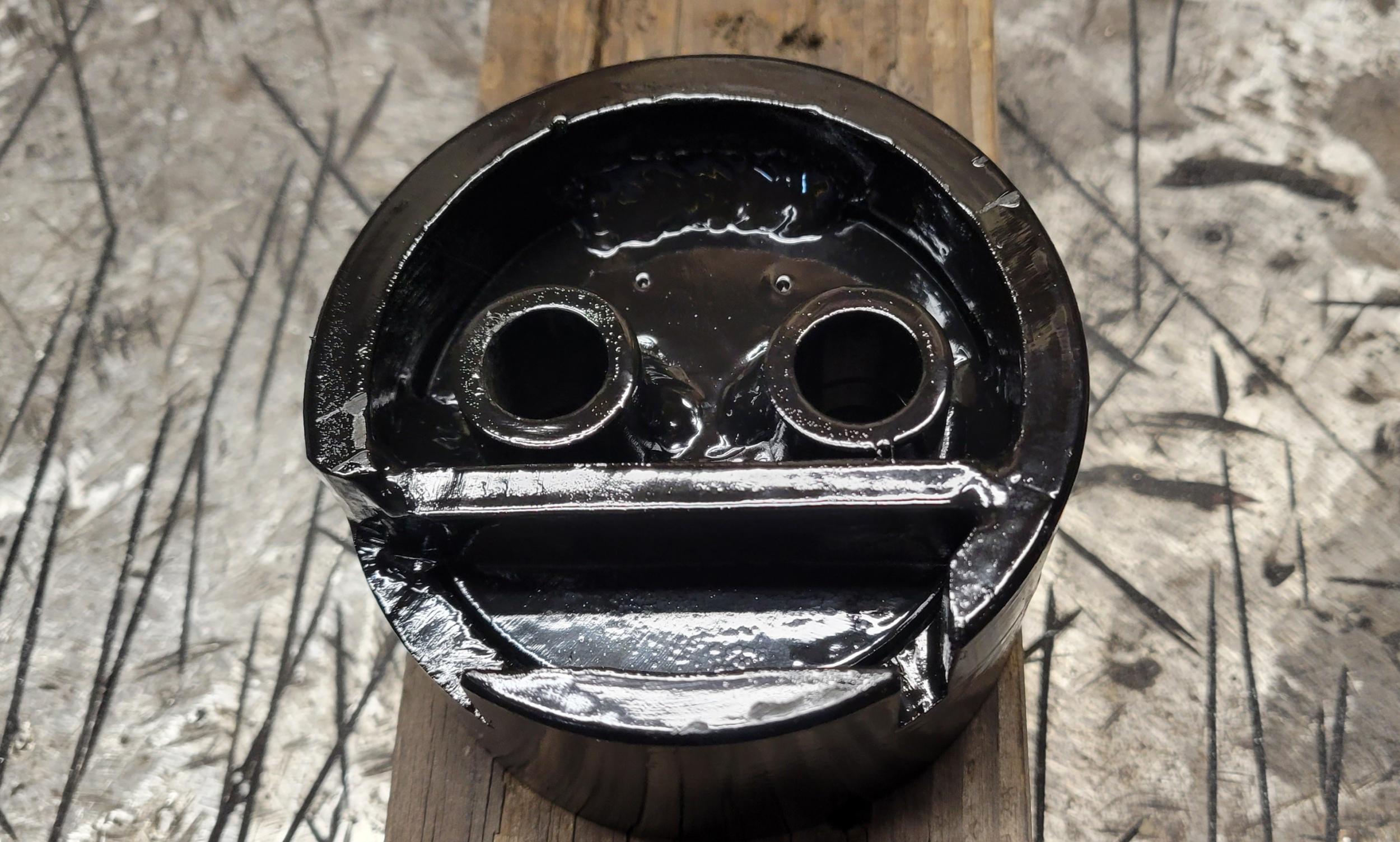

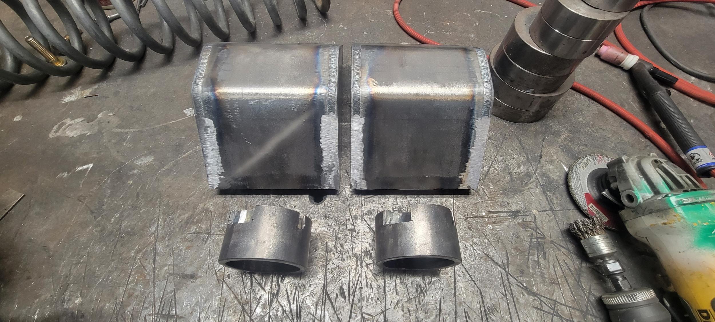

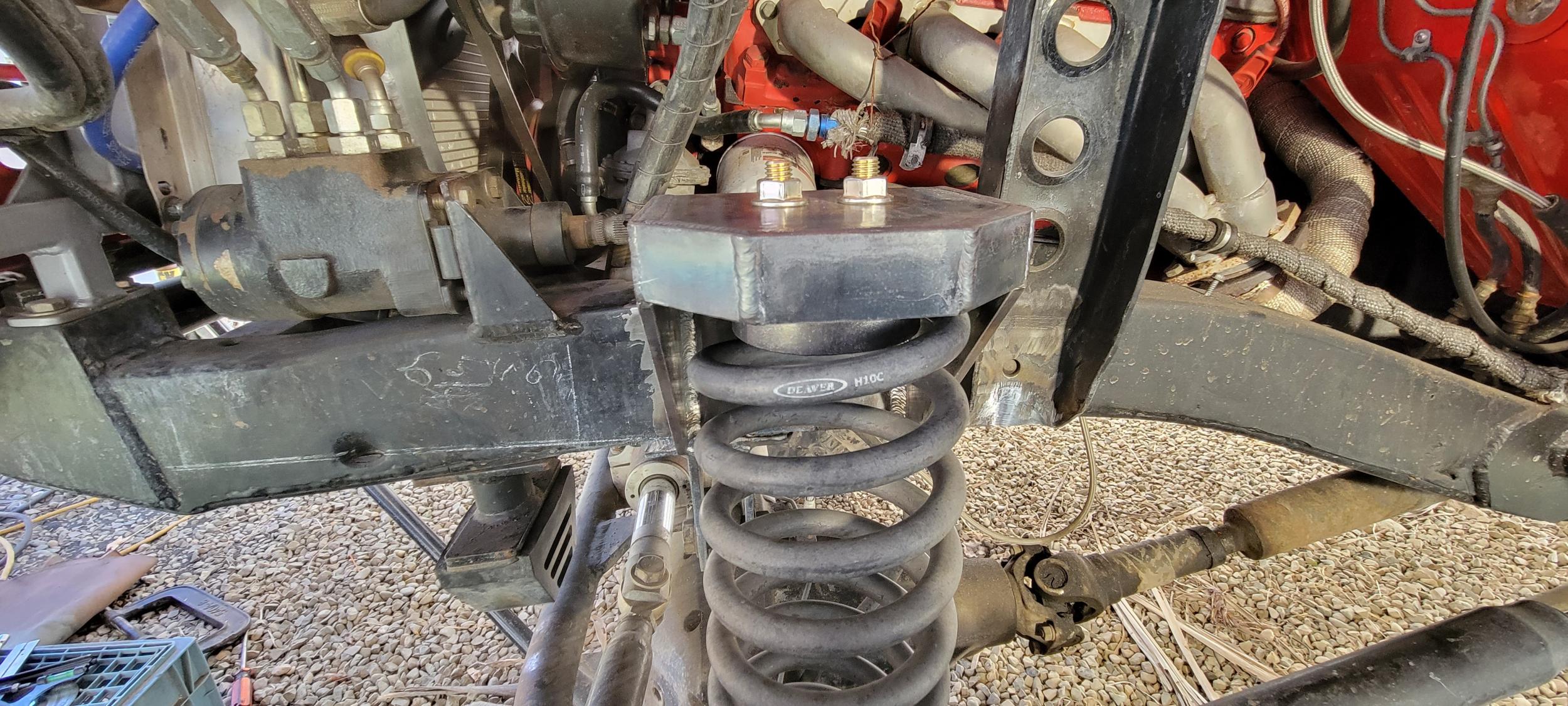

              • Click image for larger version  Name:	20231110_144938.jpg Views:	0 Size:	474.6 KB ID:	319901 Click image for larger version  Name:	20231110_173426.jpg Views:	0 Size:	436.6 KB ID:	319900 Click image for larger version  Name:	20231111_134239.jpg Views:	0 Size:	356.1 KB ID:	319898 Click image for larger version  Name:	20231111_134247.jpg Views:	0 Size:	524.3 KB ID:	319902 Click image for larger version  Name:	20231111_154912.jpg Views:	0 Size:	576.9 KB ID:	319897 Click image for larger version  Name:	20231111_164237.jpg Views:	0 Size:	427.9 KB ID:	319899 Fabbed up some front coil spring buckets,
                Got the driver's side installed and painted.
                Have the passenger side left to do.
                • Very Nice....
                  • Does that inner cup retain the coil?
                    {o===o}
                    EXCUSSSSSSE ME oh RUBIMASTER!!! I forgot how Awesome YOU ARE!!! I BEG your forgivness....
                    Originally posted by CityHick
                    I don't give probabilities in percentage format anymore

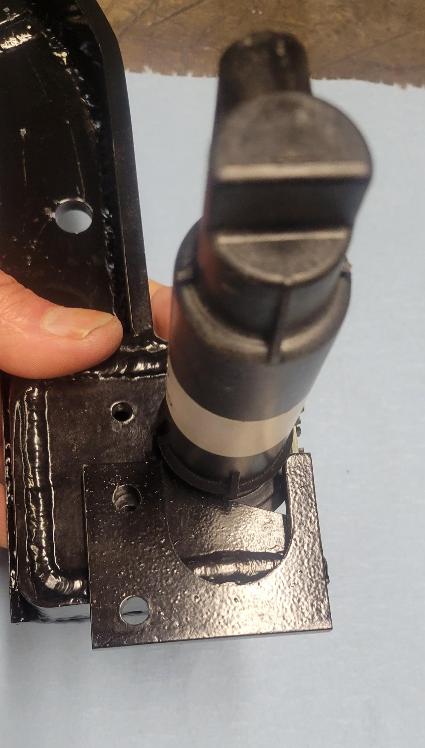

                      Yes, the pigtail goes into it. This picture shows it better.
                      • Good idea. Looks plenty stout.
                        It's amazing how the stock retainer holds the spring.
                        I always get nervous seeing a bronco coil stretched out with the stock setup.

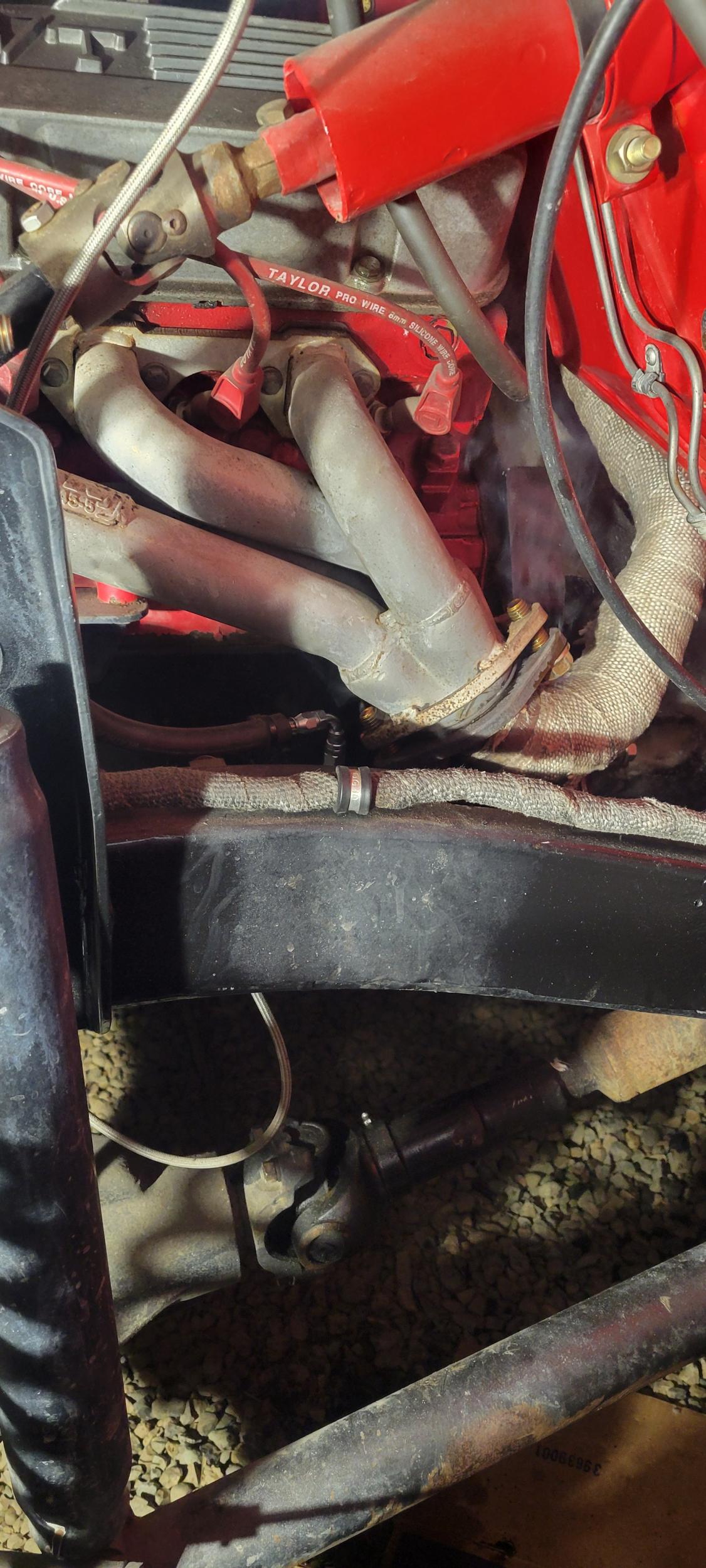

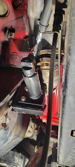

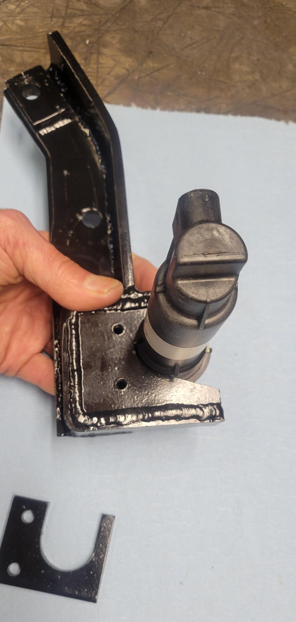

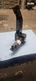

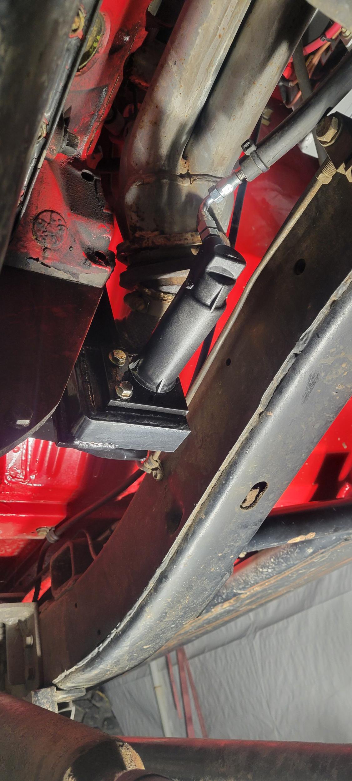

                          • Click image for larger version  Name:	20250319_173717.jpg Views:	0 Size:	322.4 KB ID:	320900Fabbed a slave cylinder bracket to use a ford slave cylinder from the mid 80's to mid 90's.
                            It's common and my wilwood slave cylinder was junk since new.
                            Close to my exhaust, but didn't feel to warm when I started it up.
                            I have fox body shorties on it now, looking at early mustang shorties, the driver's side collector is farther back, which would help.
                            Click image for larger version  Name:	20250319_173808.jpg Views:	0 Size:	200.5 KB ID:	320901
                            Click image for larger version  Name:	20250319_173828.jpg Views:	0 Size:	285.7 KB ID:	320903 Click image for larger version  Name:	20250319_174906.jpg Views:	0 Size:	218.7 KB ID:	320902 Click image for larger version  Name:	20250321_204656.jpg Views:	0 Size:	316.5 KB ID:	320904 Click image for larger version  Name:	20250321_204731.jpg Views:	0 Size:	334.6 KB ID:	320905 Click image for larger version  Name:	20250321_204221.jpg Views:	0 Size:	349.1 KB ID:	320906
