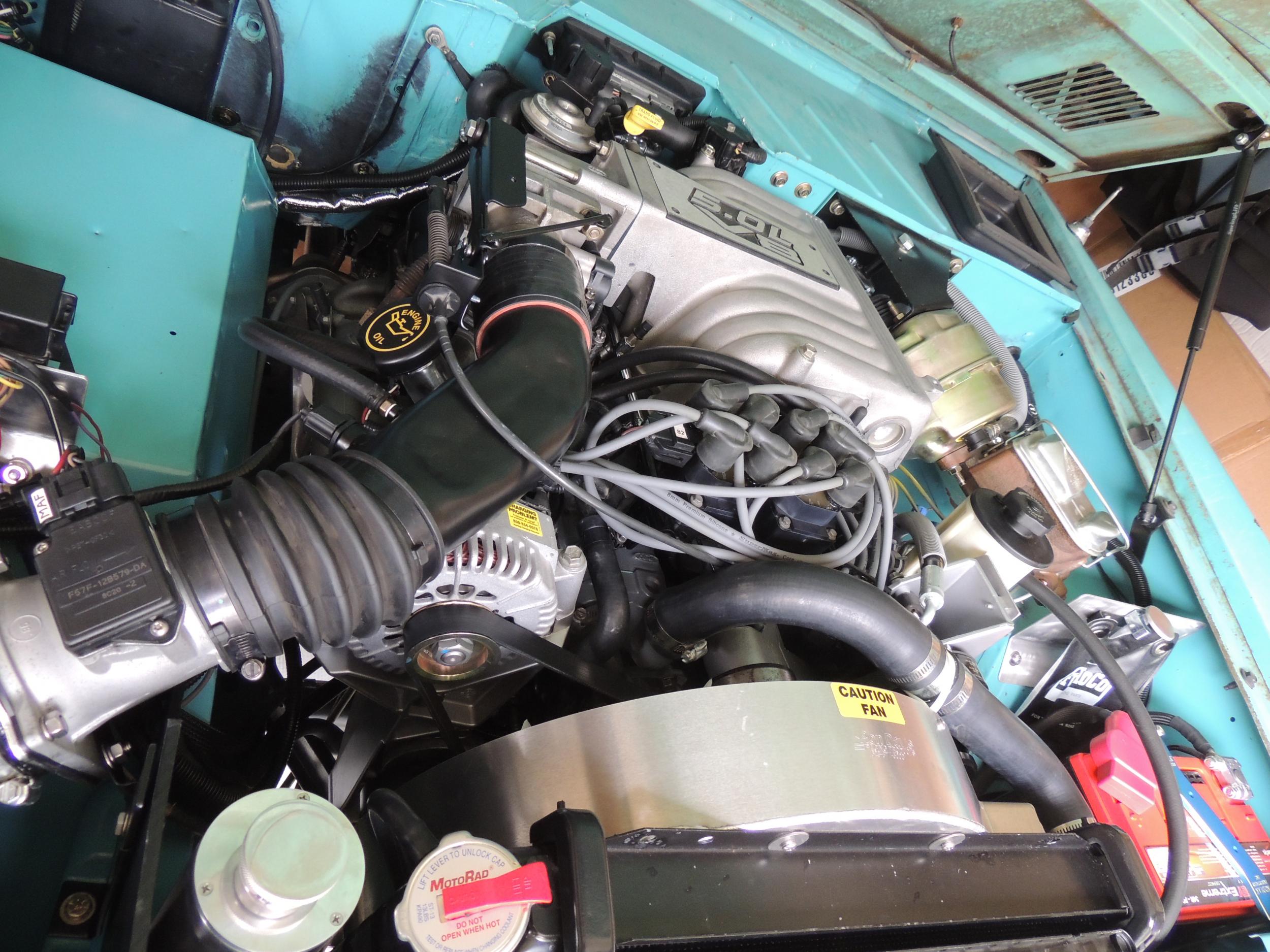

      So the update this evening...
      Yesterday I got the Bronco started, but it was not running correctly. After a lot of double checking I found this morning that I had 1 of 2 open vacuum ports for the PCV. (Duh)
      I started the Bronco and after 30-40 seconds there was a noise . It sounded like a bearing going out in a belt driven accessory. I pulled the Serp belt, and no change. I pulled the inspection cover for the trans looking for contact noise. Nothing. So the engine, at this point, has never run longer than 1 minute. Called the Machinist to come over to listen to the noise and well he did not make it today. It was a Monday for him at the shop...
      EFI Guy from Classic Broncos has been working with me on this, so we chatted some this afternoon.
      It came down to conversations I had viewed on the Explorer Forum regarding Cam position sensors - noise. Seems they have a bushing in them that does not get a lot of oil, causing them to fail at 70K.
      The 1st rebuild had a new O'Reillys Rich Porter unit installed - Chinese made. We found that there was a lot of slop in the drive for the oil pump shaft, more so than the 176K unit that came out of the donor. So for the 2nd rebuild I went out and bought a new $160 Napa Echlin unit made in the USA.
      So guess what........................ The new Napa unit was making noise. I put the 176K Motorcraft unit in and fired it off. No Noise. I put the Serp belt back on, no noise. I put the tranny cover back on, no noise. So I have heat cycled the new motor and topped off all fluids. No noise. I hope to get it on the road tomorrow...

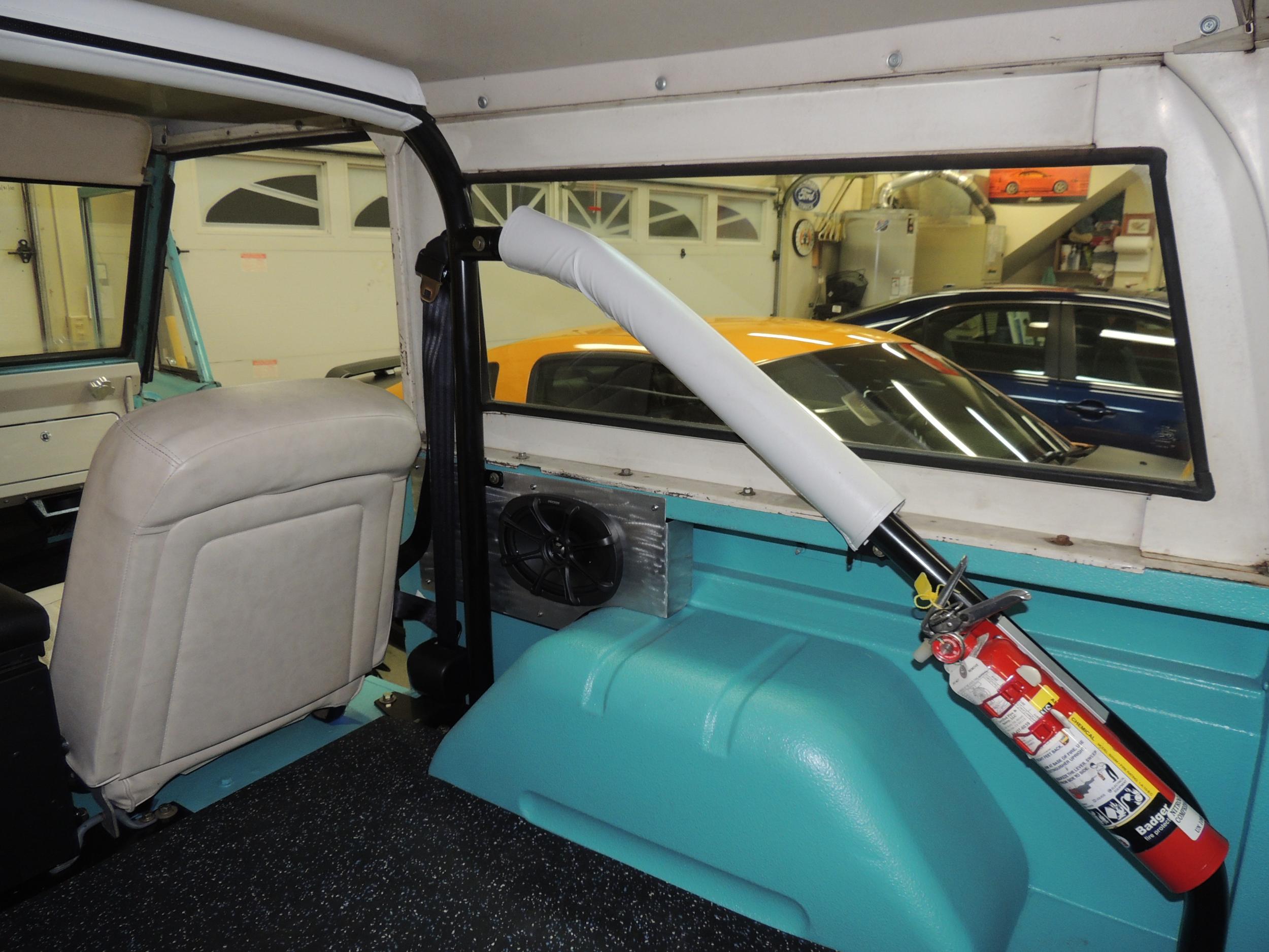

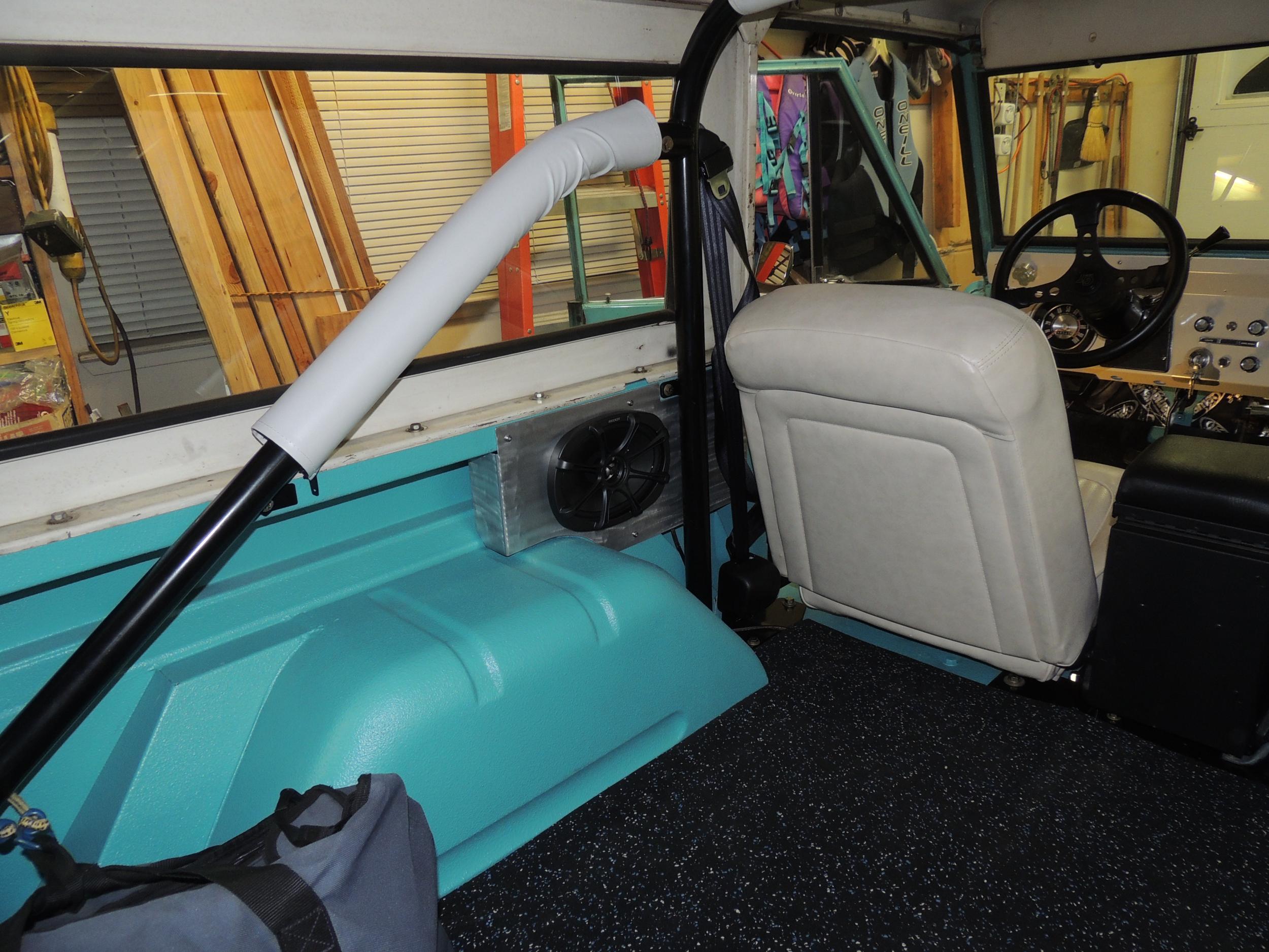

                      Well time for an update...
                      Working on almost 700 miles on the motor. Bought a touch pad and loaded ForScan on it. Bought a Blue tooth adapter that plugs into the OBD II port so I can data log while the engine is running. 2400 rpm at 70mph with the 4:56 gears in Overdrive. Bronco mechanical Temp gauge is off 10-15 degrees. Program is good for watching fuel metering...
                      Installed the rollbar/seatbelts, stereo/speakers, and all of the A/C in the dash. Added some LED backup lights. Tuffy box between the seats. Not happy that the Factory AM radio no longer fits in the dash due to the A/C ducting. Finished installing the glovebox...
                      Still working on odds and ends...
                      Trying to put the tire carrier back together, fixing the PO's previous modifications
                      No wipers, need to get together with 14Justice to do the vacuum to electrical conversion.
                      WH 2.5" springs are sagging talking to Dirtdonk about what can be done.
                      Need to install the Drier and compressor harness so I can get the A/C finished.
                      Filled the fuel tank all the way and the sending unit needs pulled and adjusted. And one of the gaskets on top failed, so there is gas smell when the tank is full.
                      New Brake booster failed from Tom's, but they provided a replacement. Just the time to diagnose and then wait for the part.
                      Took off the Grant steering wheel again and had to machine a bushing to keep the horn contact plate farther away from the horn contact button. Some time spent on the phone with Ididit and Grant.
                      The ToDo list is getting shorter, happy with how the rig is coming together.

                        I like those speaker enclosures in your rear quarters. Painted to match the body and most might not even notice them.

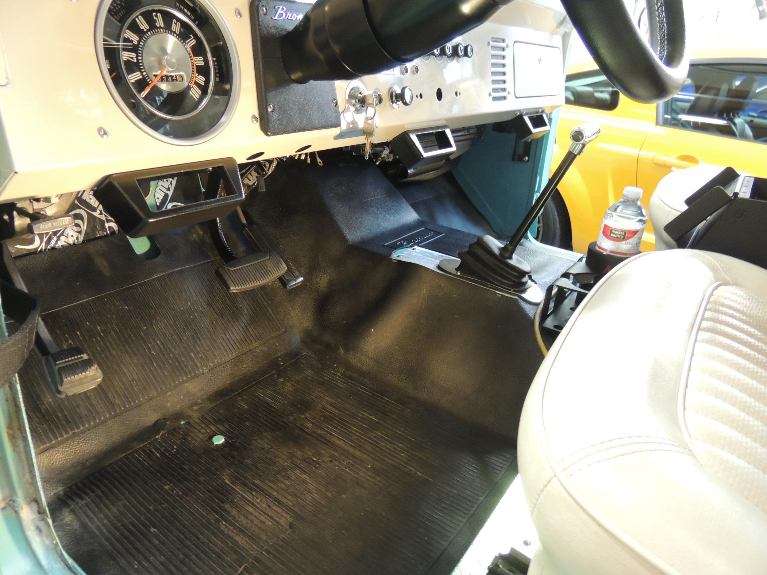

                            Where did you get the rubber flooring up front at ?......bronco looks great
                            • Re: The 68 Lubr...
                              It is the original one that came with the Bronco...
