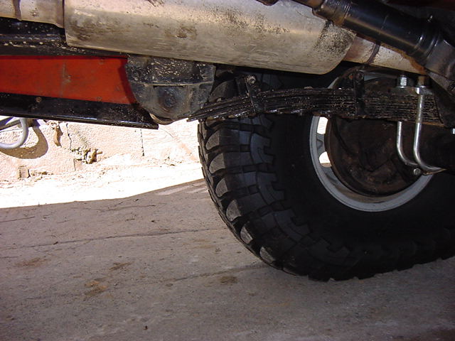

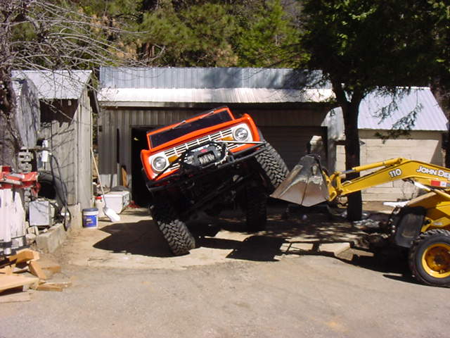

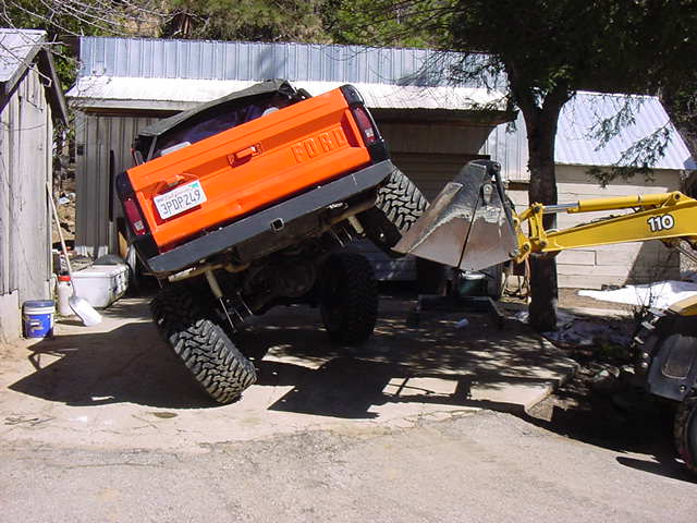

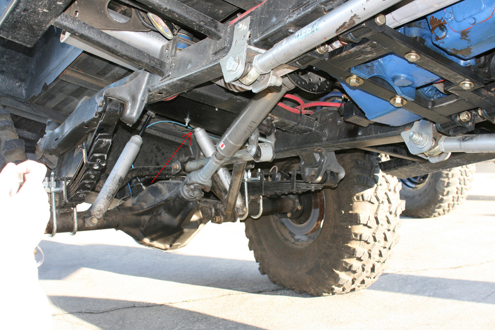

I was taking some measurements today for shock placement, the stock rear shock mounts just aren't cutting it.

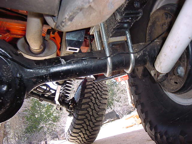

And while doing so I noticed my leaf springs doing this, should I be worried about the life of my springs? They seem to hold this shape for while after flexing. I thought it might have something to do with the rear shocks pushing the axle forward when they bottom out, so I disconnected the top of the shocks and it was worse due to the gained up travel. I don't see how a antiwrap bar would help in this scenerio. As you can see I am still not to my 4.5" bumpstops either.69, 342 EFI, C4, NP203, D20, 4.5" SL, 2" BL, 4.88 9" 35 spline ARB, 4.88 HP D44, WAH, ARB, CTM's, front disc , 37 x 14.50 Toyo MT, Ram Assist, and rear 4-link

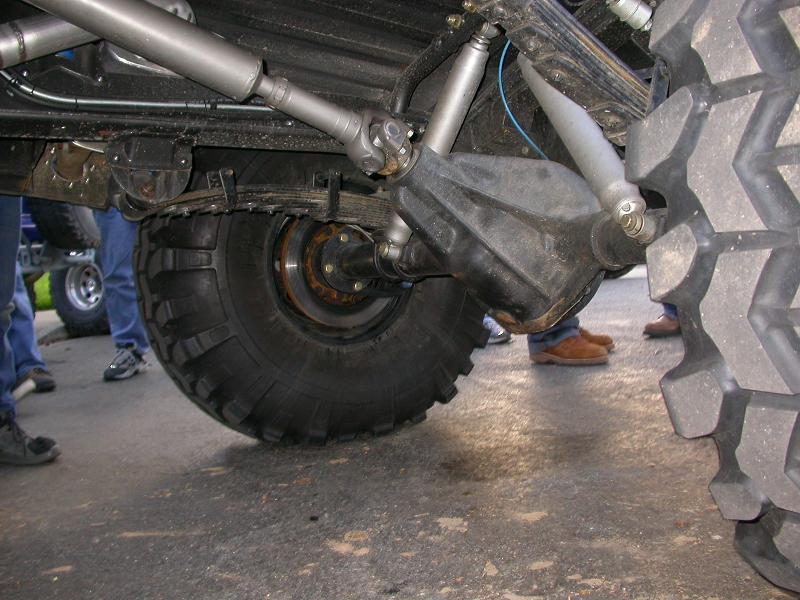

I noticed my springs doing that same thing a while back. They were getting that "S" shape to them and eventually you will bend the springs and they stay like that. It is due to axle wrap. Look at your pics and notice how high your rear pinion is. The more the suspension flexes, the higher up it goes, thus twisting the axle housing and twisting your springs into that "s" shape. Once you install an anti wrap bar, you will notice your pinion will not do this any more and your springs will stay more true to their natural shape during articulation.

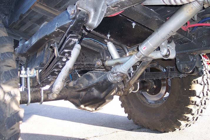

I can't find the before pic, but I have a pic somewhere, from Jerry's BBQ last year, while I was on the RTI ramp and my leaf springs look exactly like yours do in your pics. And I bent them! Here is a pic from our last BBQ after I installed my anti wrap bar and notice how my springs are NOT in that "S" shape because the wrap bar won't let the axle housing twist.
I pretty much came to the same conclusion after looking back at some of my pictures of your bronco from the BBQ. I had this one, by the way look at your shocks in these pics one is bottomed out and the other is only extended a few inches. I think I am just looking for an excuse to go 4-linkLast edited by highlander; 03-16-2007, 07:42 AM.69, 342 EFI, C4, NP203, D20, 4.5" SL, 2" BL, 4.88 9" 35 spline ARB, 4.88 HP D44, WAH, ARB, CTM's, front disc , 37 x 14.50 Toyo MT, Ram Assist, and rear 4-link

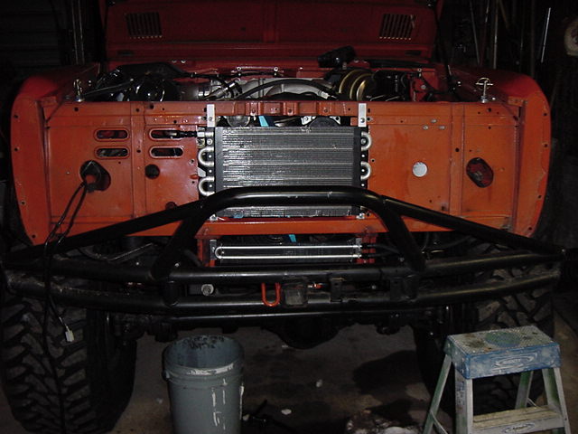

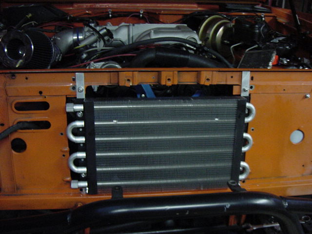

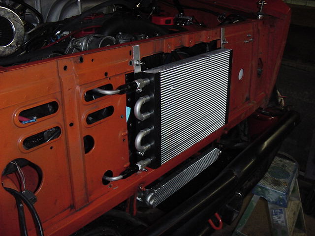

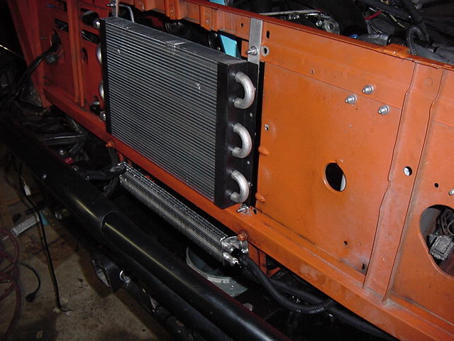

Well I finally spent some time to install my new transmission cooler. I wasn't happy with the cooling abilities of the in radiator cooler alone so a while back I installed a 7" x 12" tube and fin cooler with a electric fan mounted in the grill after going through the radiator. This was keeping both the motor and the tranny warm on the trail, so when I upgraded radiators I omitted the in rad. cooler and ran just the remote cooler, this helped keep the tranny a little cooler on the trails but not enough my engine runs very cool now. So I decide to ditch the small cooler for a 21" x 10.5" tube and fin cooler mounted in front of the rad. I had to get a new PS cooler since this would take up the space where it used to sit. So I added a 3" x 21" tube and fin cooler in front of the rad but under the grill. I know the plate coolers are more efficient but I was worried about the amount of air they block so I just went to a larger size tube cooler. To fit this monster cooler in I had to eliminate the hood latch, so I installed hood pins and finally put some hood shocks on.

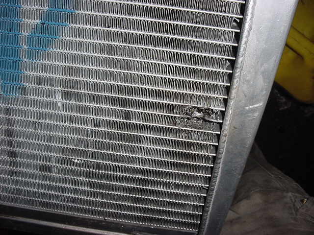

It all went in pretty smooth with one exception I manged to put a hole in my nice new Ron Davis Rad (I almost cried). I patched the tube w/ low temp aluminum solder, but I need to pressure test it before it goes back in . Here is what I came up with hopefully my tranny runs cool now:Last edited by highlander; 11-08-2007, 08:57 PM.69, 342 EFI, C4, NP203, D20, 4.5" SL, 2" BL, 4.88 9" 35 spline ARB, 4.88 HP D44, WAH, ARB, CTM's, front disc , 37 x 14.50 Toyo MT, Ram Assist, and rear 4-link
