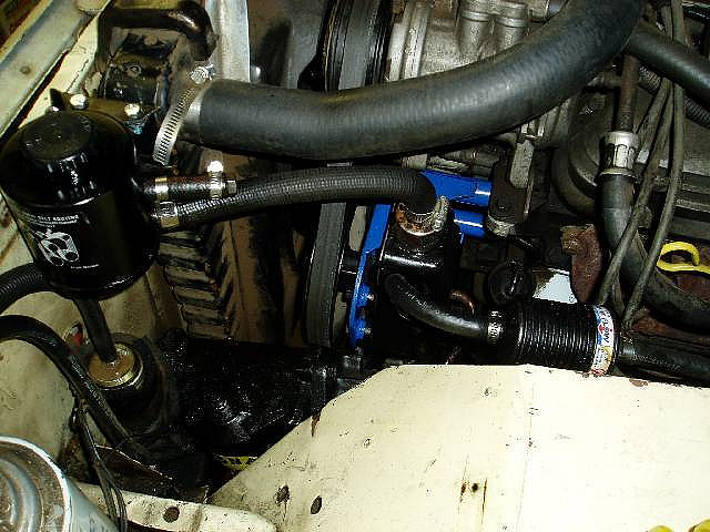

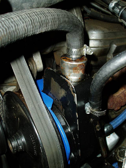

                        Lars bracket, '86 chevy van pump can, astrovan remote res.
                        • #13
                          Re: Power steering remote reservoir...
                          Cool. I see you had to notch the Lars bracket. I was reluctant to cut the bracket for the reservoir can. When I spoke to James at wild horses he said it was designed for a particular reservoir rotation.
