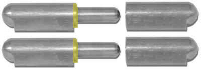

    I've been thinking about those cool $200 lift off door hinges, and read the "how to" version where you cut off one of the small ears of your existing hinges. I just found these hinge pins on ebay and was thinking you could replace the stock under/middle/over design with a set of these. If it worked they'd be cheap enough to buy another set for lift off tube doors. Might be hard to weld w/o warping, or hard to make all 4 the same, but still makes me wonder.....

    not big enough...........or sturdy enough I think they'd be jumping off the pins.

      If not, just using a tight fitting peice of round tube and welding one end to the hinge would work.

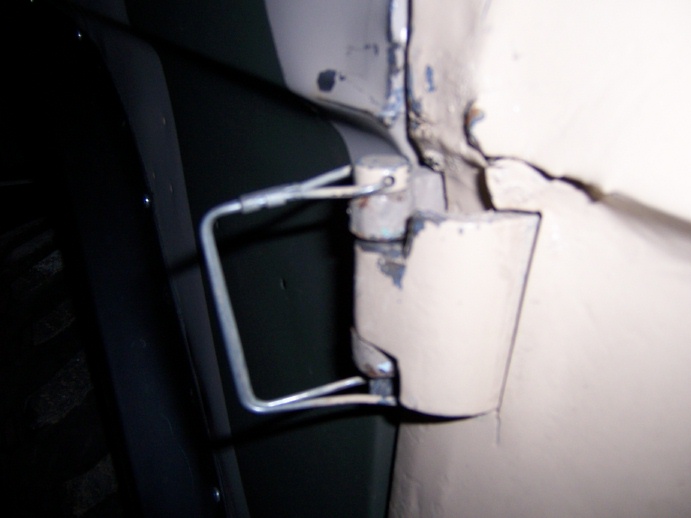

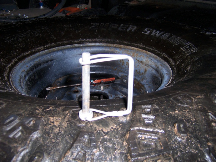

          I have a set of 5/16" pins with the a thin metal piece that goes from one end to the other and it is shaped kind of like a D. I just had to drill out the existing holes slightly. Makes removing the doors a two minute job. The one problem is that the body line on the top hinge gets in the way of the head on the pin. I just massaged the body a little and it slides right in. You could always come up from the bottom though.

            Well, I figured my discription sucked so I broke out the camera. Just remember my bronco is hammered, an these pins have been through a lot of it.

                          I was thinkin' the raw hinges looked like these lift off hinges. Not nearly as simple as Marc's.......

                            That looks good though.. i did the home lift off version for my tube doors.. I dont like it too much.. not sturdy enough.. But those look nice..

                              Build up a simple Jig and fab those ebay hinges on. I bet they are the same used, they look close enough for me.
