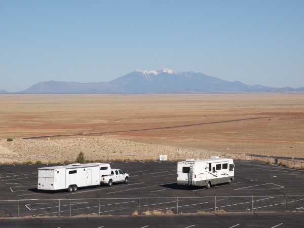

            36 foot progressive with two 7000lb axles. I can't keep a set of tires under it for very long. Bearings wear quick. We are way over loaded. The Mare just fits. Our customers joke about being buried in their Broncos, for me it's this trailer. I carry two spares and bearings.
            Anyone know who can triple axle this rig for me?
